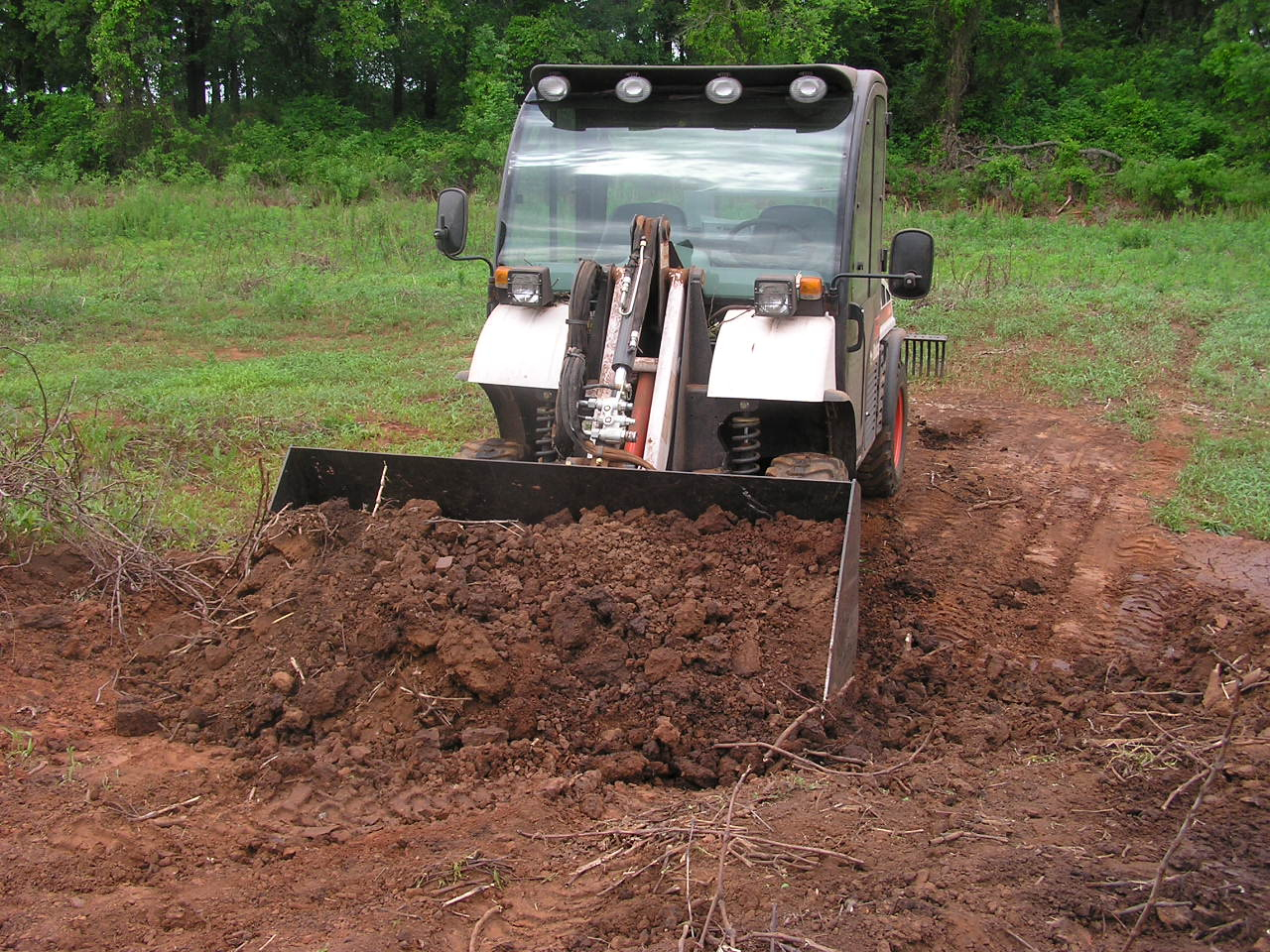

The toolcat looks interesting. I would go with the dump bed over the 3 point, all though a grader box would be good for the track.
Put a SSQA plate on the back of the grader box:

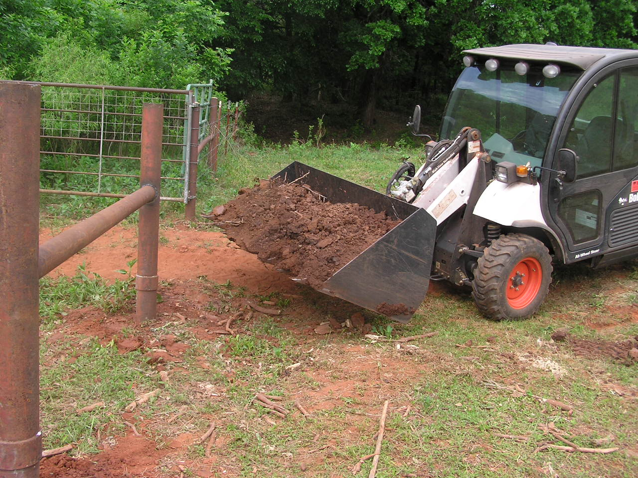

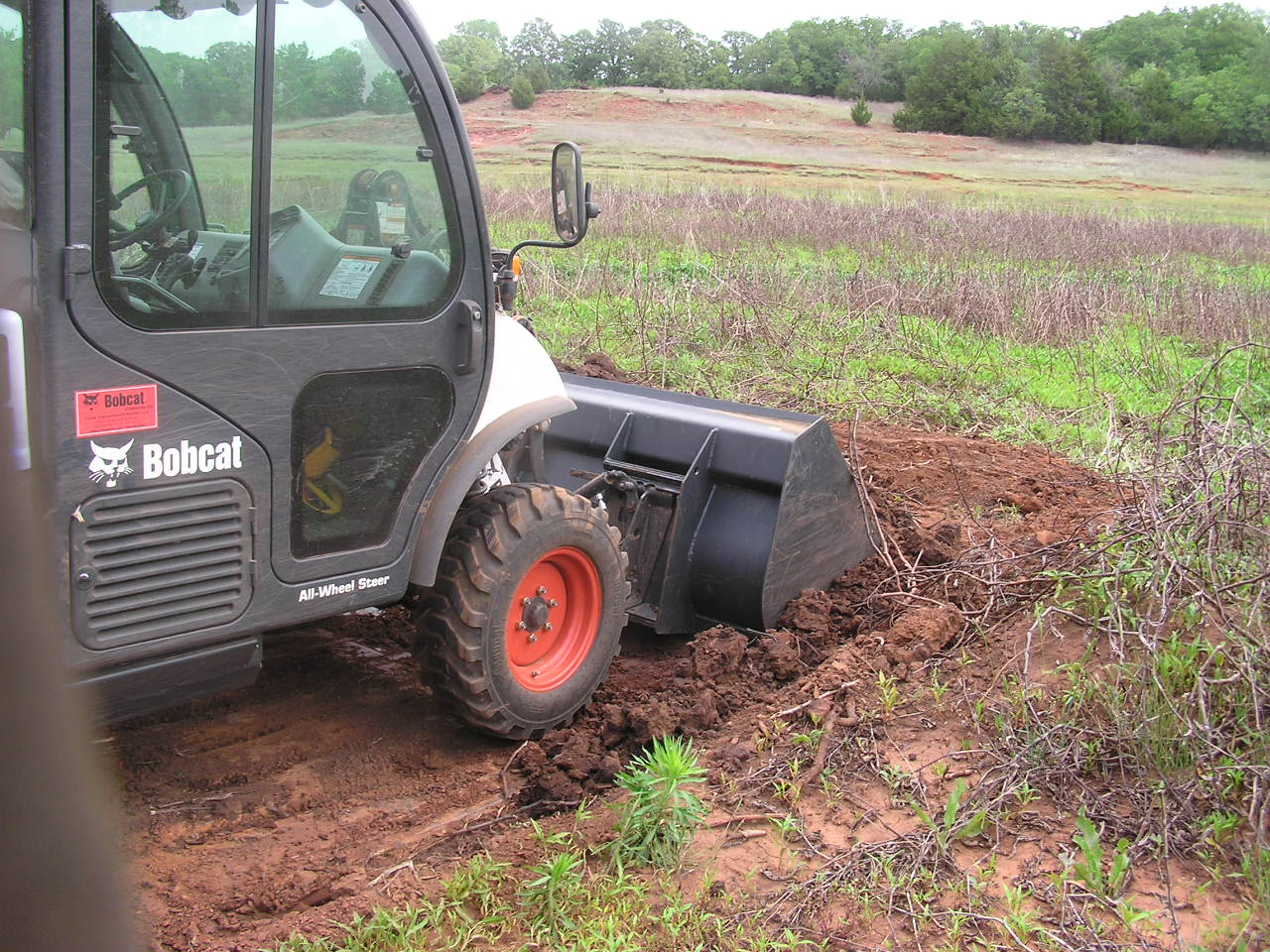

How good can the tool cat dig dirt with a tooth bucket?
Very good. This is a 6 foot wide 1 cubic yard bucket:

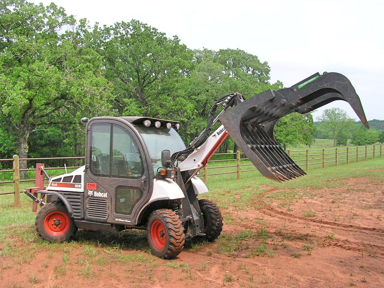

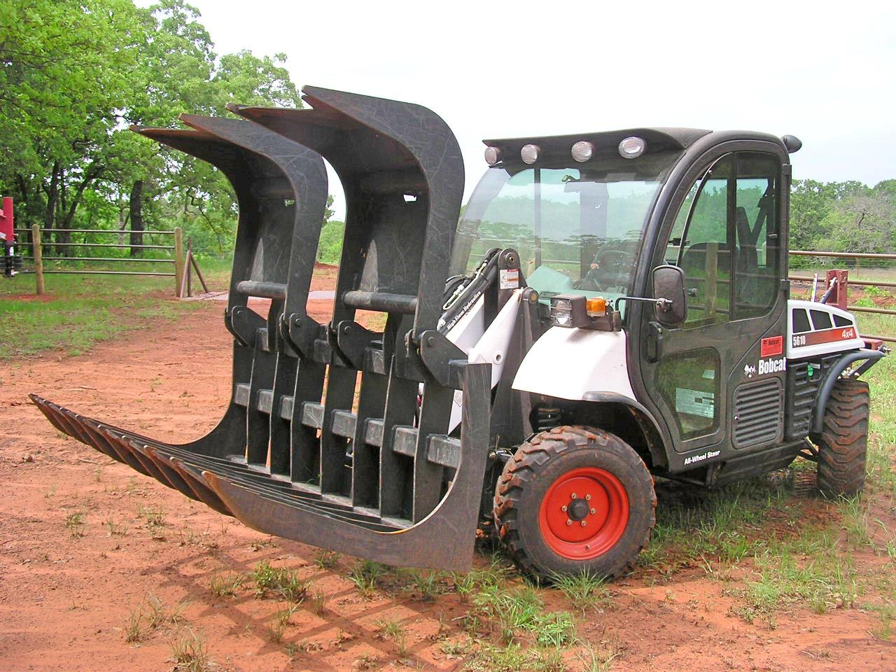

I also have a heavy kubota root grapple, would toolcat be able to handle that?
Yes, this 6 foot wide Monster Grapple weighs 1,168 pounds:
The loader will lift over 3,000 pounds.
