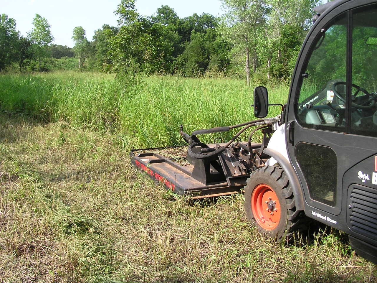

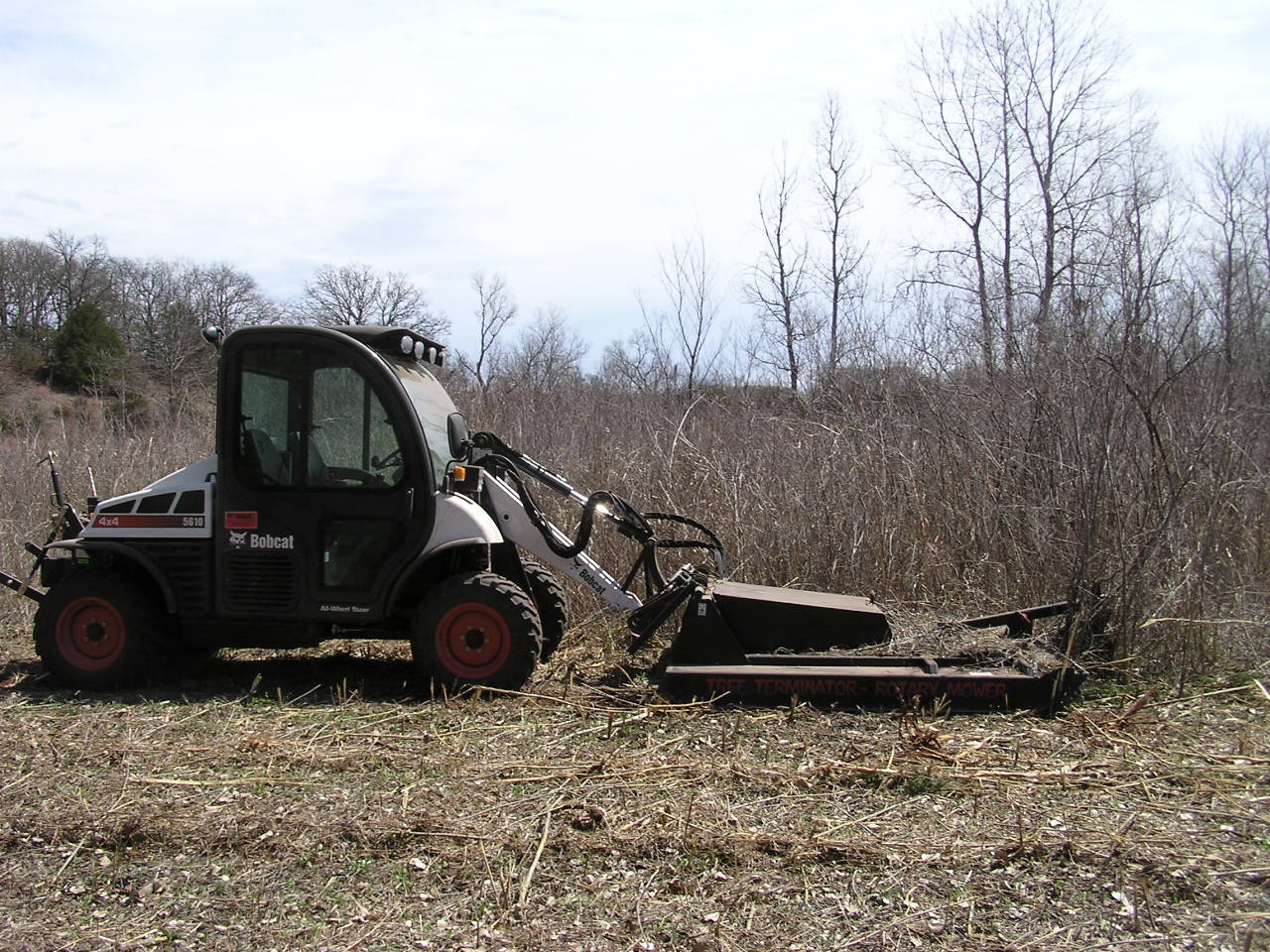

I'm not going to damage to brushcat by attaching it, will I?
No. GPM flow is determined by engine RPM.
We run a low flow (15-25) 7' brush hog with the high flow switch on at around 1700 RPM in Work Mode:
It weighs 1800 pounds:
