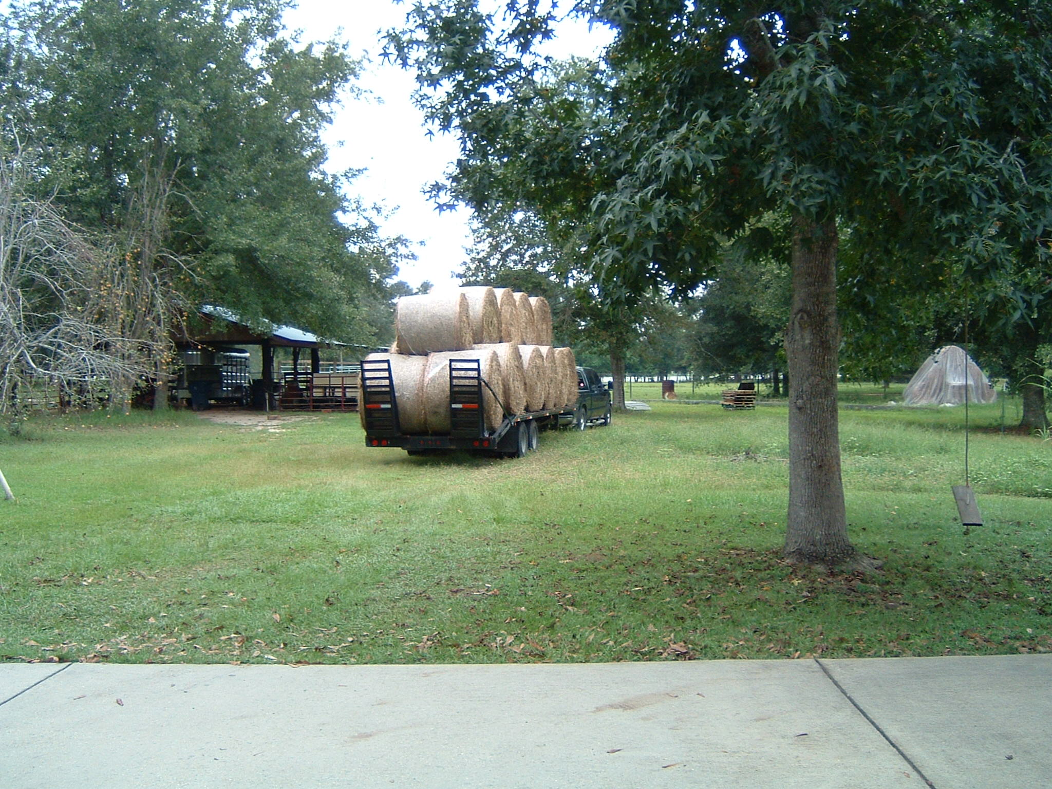

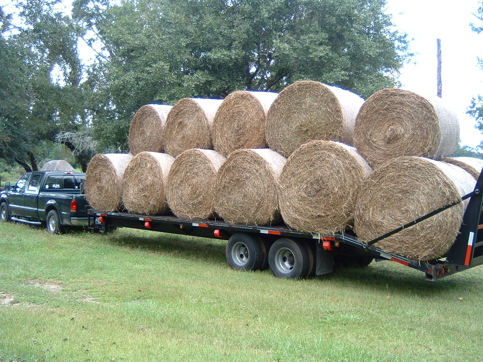

these are not real good pictures but you can see how my ramps are held up or they will fold flat to make the dovetail a flat deck.
