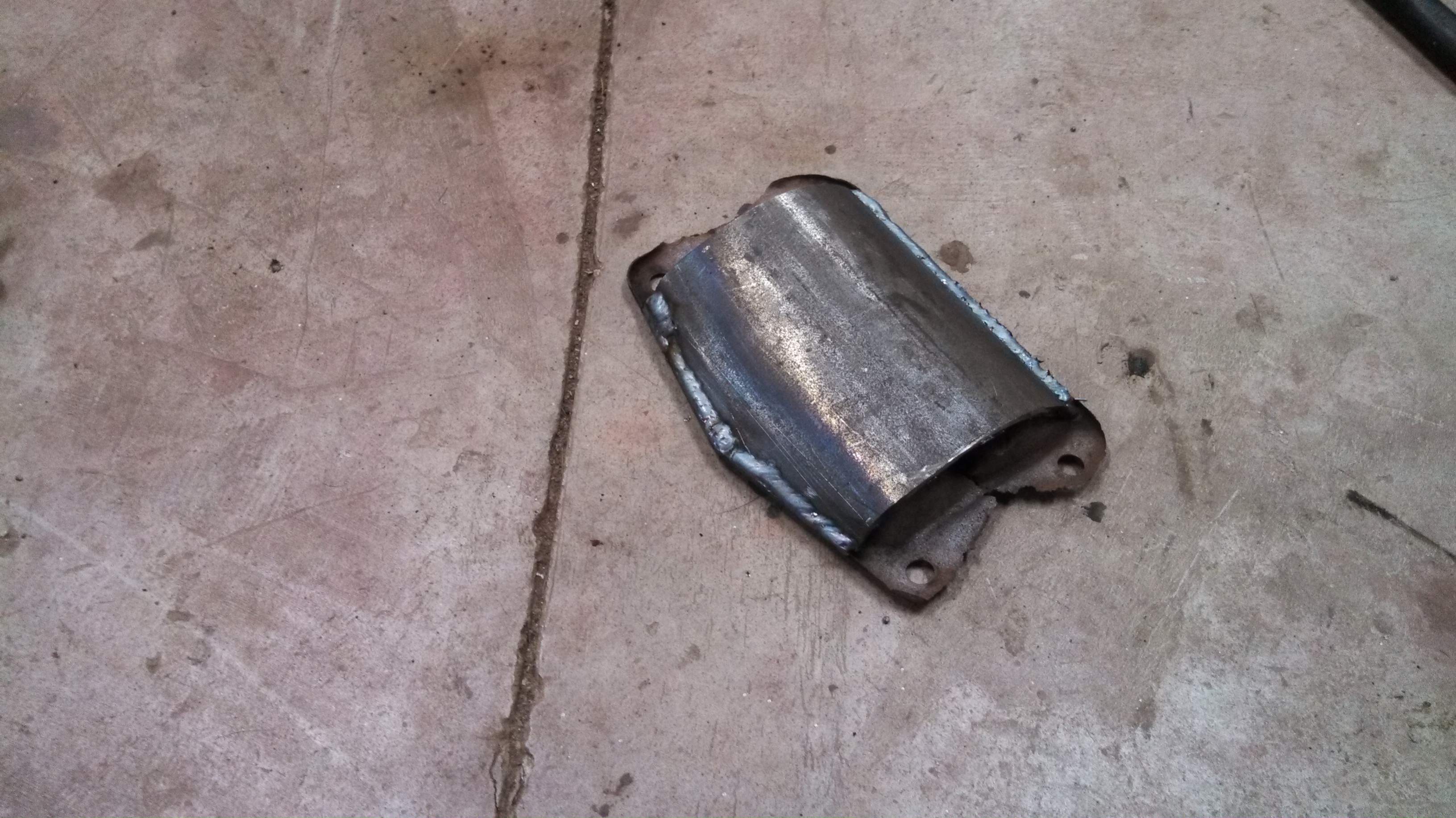

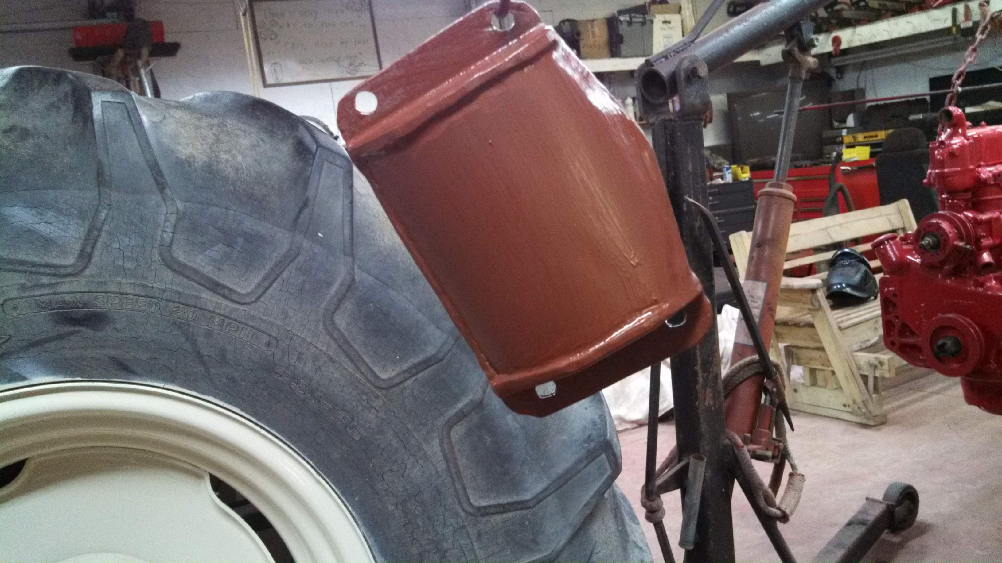

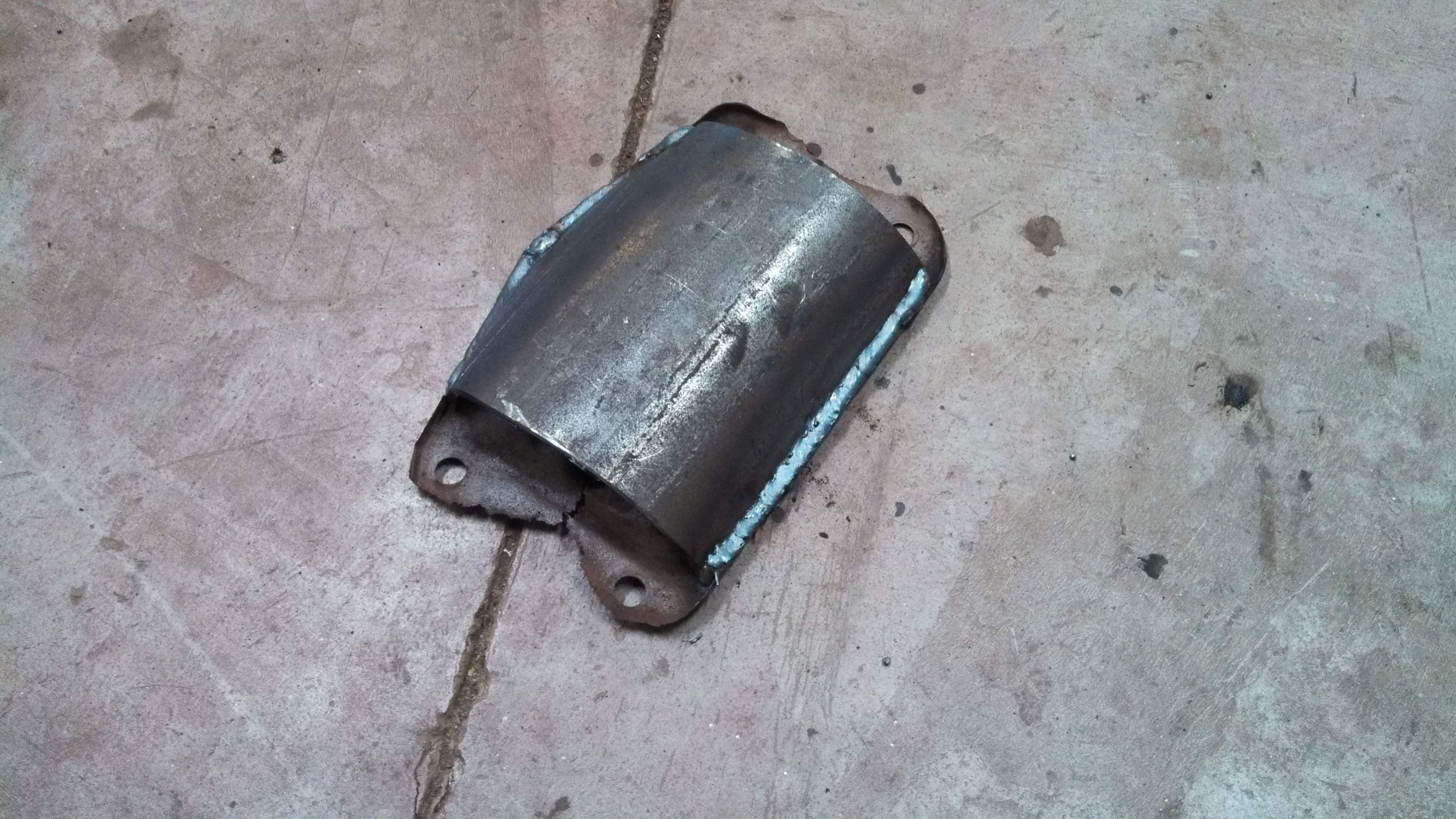

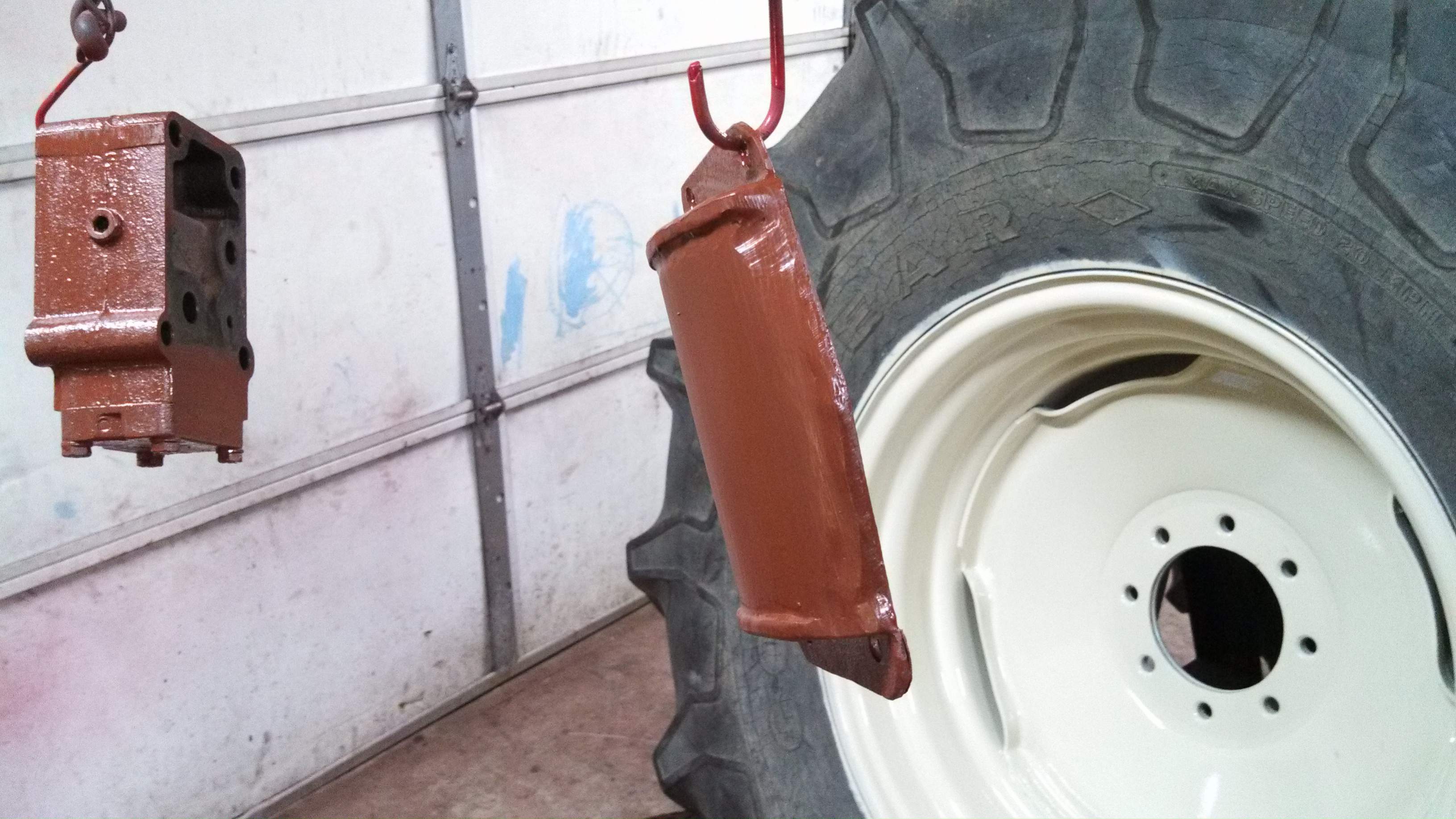

Not gonna get the tires mounted tonight. Paint is still to soft to handle. The white seems to be taking longer to dry than the red. Could be because I had to spray it a bit heavier to get good coverage?? Or something different in the paint? I dont know. But will see tomorrow. Would like to get them on so I can work on the fenders
I did get the TA cover done though.
I used a peice of 5" OD x 1/8" thick pipe. Sliced what I needed, and flattened a bit
Then I took some angle iron to cap the ends. I didnt take any pics of them before I welded or painted, but you get the idea.
