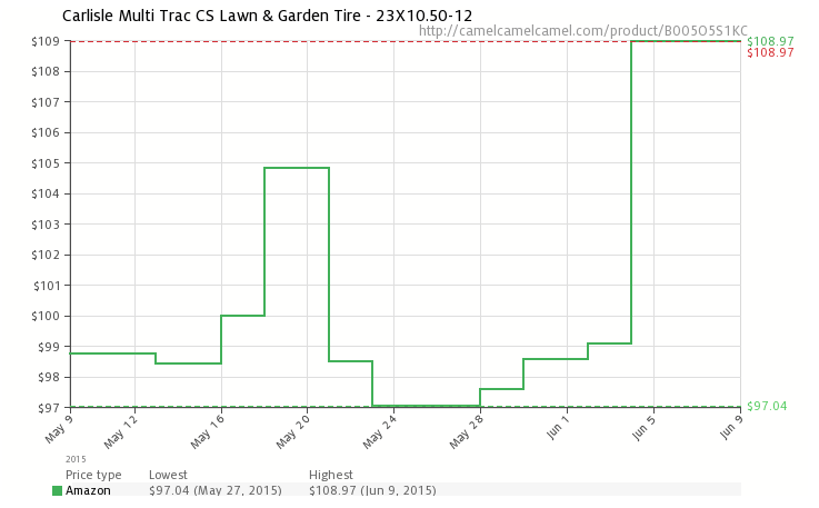

   / I'm Backkkk ! My old new 1425 #59
What tire pressure do you guys recommend in your 422's 425's . I will be replacing these tires with regular turf, They worked great on my 180 for plowing snow and they are easier on the lawn.. Now if I can find at least a 4-ply in a turf I'll be happy..
8# in the rear, 10# in front.
I just bought a replacement Carlisle Multi Trac CS Turf tire from Amazon. 6 ply. They had the best price I could find (it was $98 when I purchased it, now $108).
Amazon.com: Carlisle Multi Trac CS Lawn & Garden Tire - 23X10.50-12: Automotive
You can find the Carlisle Turf Masters for a cheaper price, but those are 4 ply.
Others have recommended Stop & Go Tires, but they didn't have the multi-trac in the size I needed, but they do have the Turf Masters for $75:
Stop and Go Carlisle Turf Master 23x10.50x12'
There is a really cool site called camelcamelcamel.com for tracking Amazon prices:
When you do replace your tires, I recommend you put a flush valve stem on the inside... at least of the left front tire that gets filled with grass when mowing. I had two flats from that valve stem getting ripped off.
https://www.amazon.com/gp/product/B000CMD5Z8/
