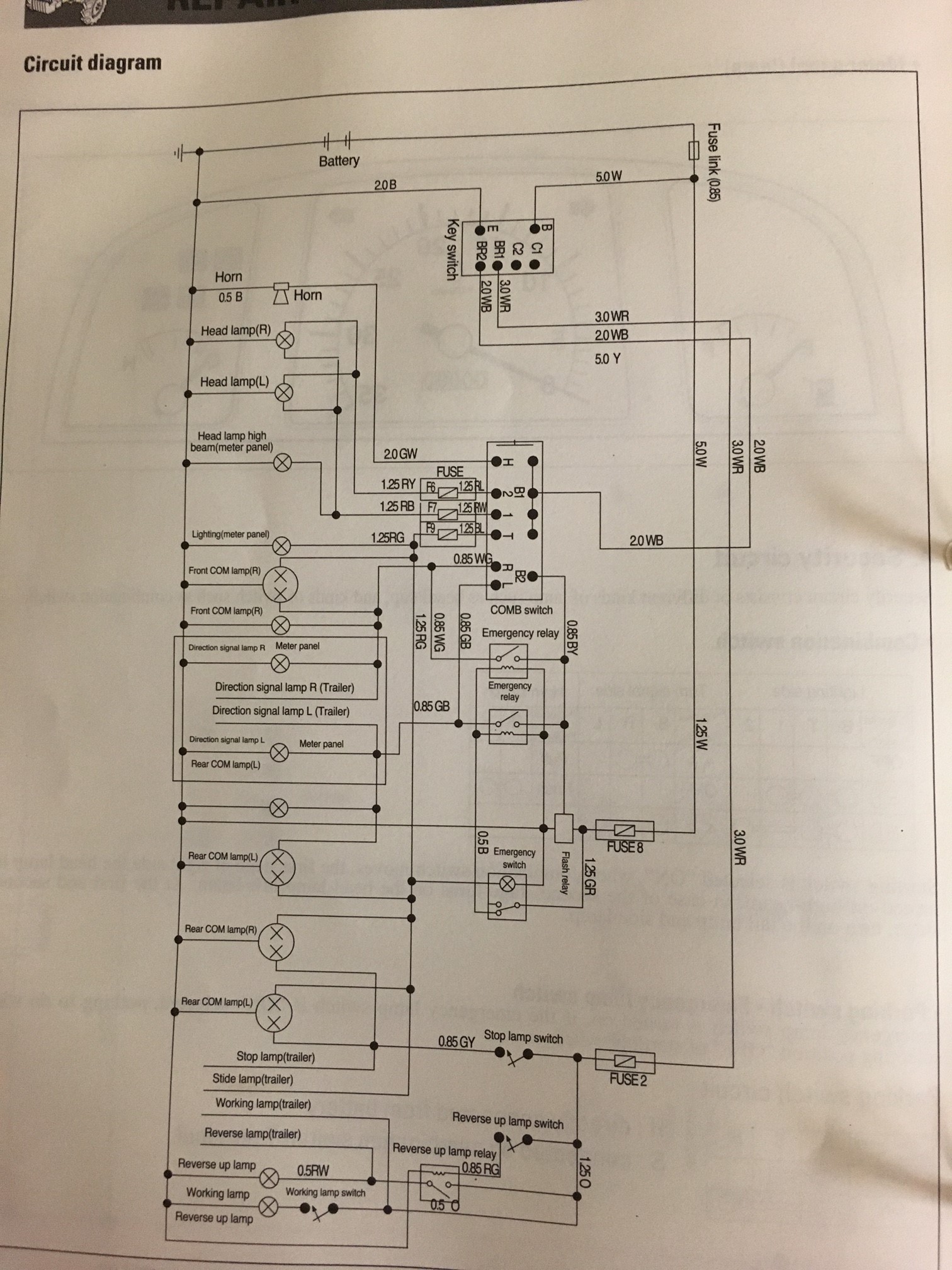

Thanks Larry, I didn't know there where two fusible links. I found the first one and replaced it. I'll look for the second one when I get home tonight.

Eddie. I found a wiring schematic. I will upload it soon.

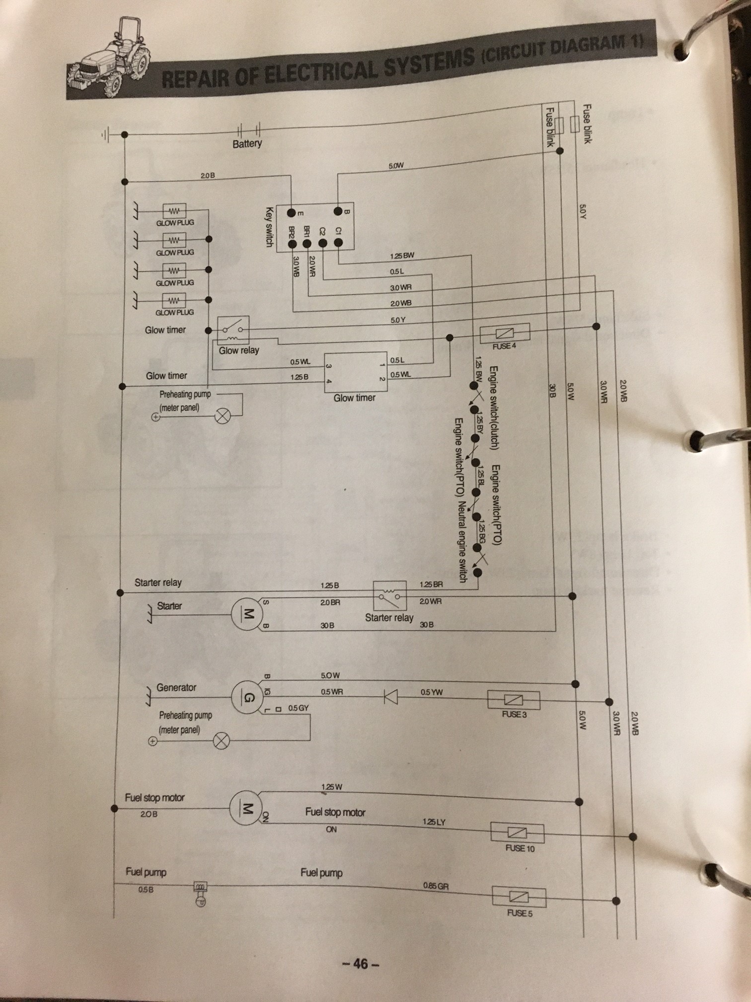

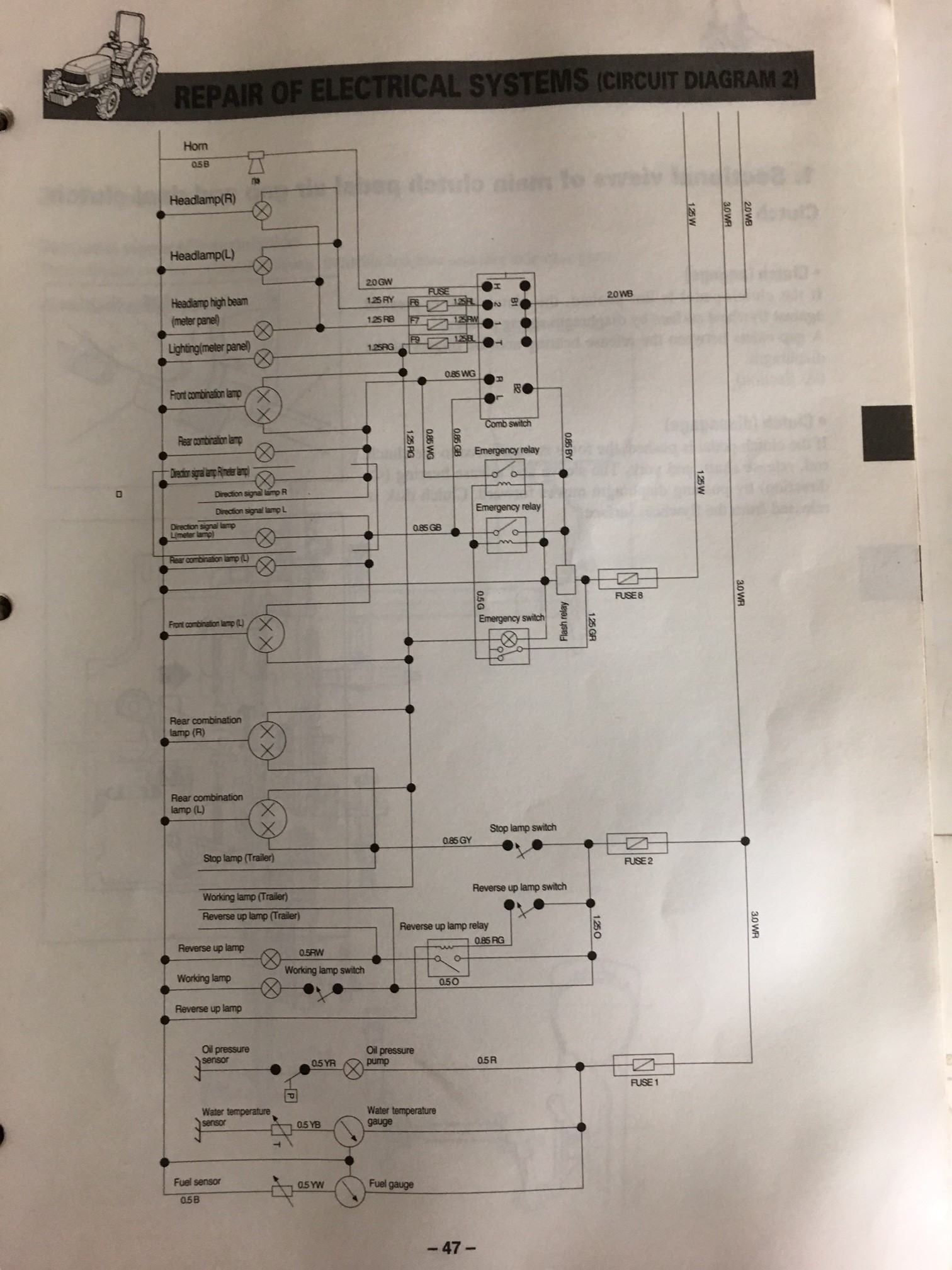

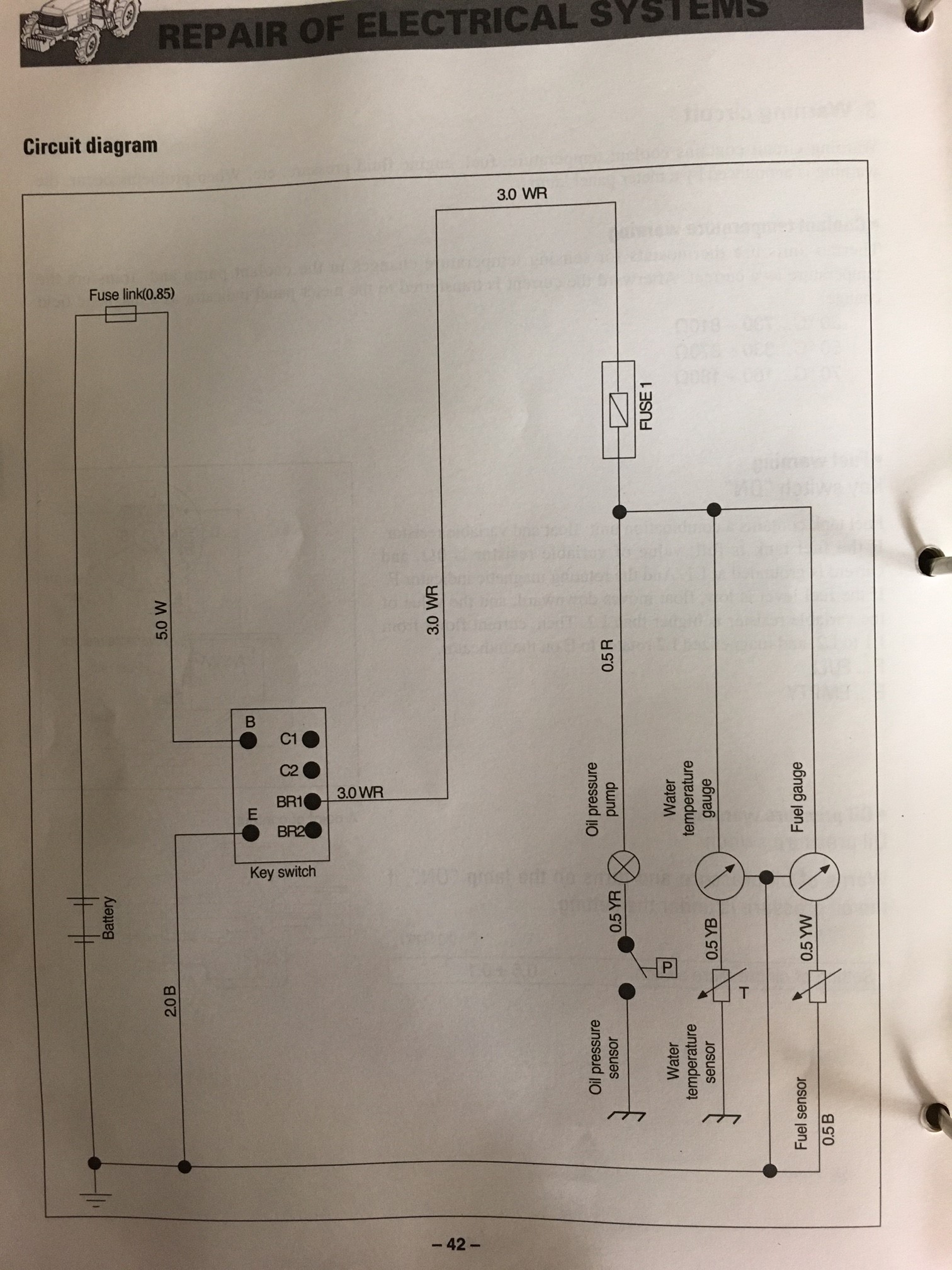

If I have done this correctly, here is some wiring info for the pre Cummins Branson and Century tractors.
   / I'm Done With Branson #47
Eddie notice that the 12 volts from the battery goes from the battery to a fusible link then to a 5 millimeter white wire to the B terminal on the key switch. Trace back that white wire.
Yes sir, that's going to be plan A!!!
