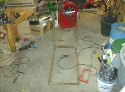

I have to say, the spare tire takes the cake for cool. I don't have plans for a spare tire on my build, but I do plan to make it my own. I started fabrication last night, and I've already changed the plan a bit. Nothing real exciting yet... just the base frame.
I have to add that on this project I'm getting some quality time finally with my DC welder. I'm beginning to understand why so many have said that DC is MUCH better.

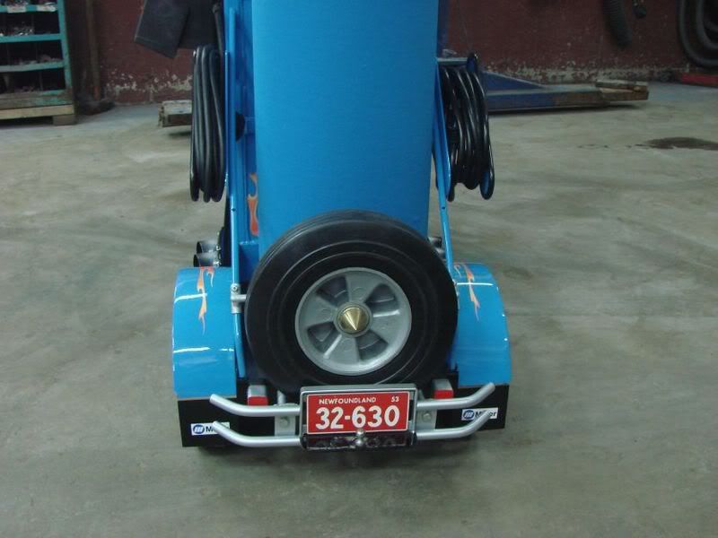

Na. It already has mud flaps in the rear. It's only a rear whee drive so I only put the flap on the back. Take a look again. They got "Miller" written on them :laughing: And you thought I left them out :mad: :laughing: Thank you my friend.
When you get your flaps installed post a few pics :D

You might think your out of the woods when it comes to a basic cart and I can see your off to a great start and yes DC is much nicer to use. I'm bett'en you'll add some nice touches to it as you go along.
When I went to make my welding trailer I started off with a rectangular chalk line on the floor and when I got it completed I had this made. :shocked:
Here's the video. It might give you and idea or two:
YouTube - ‪welding trailer‬‎
Plasma cutting station:
Storage stations:
This is how It started out!
This is it completed and ready for work!

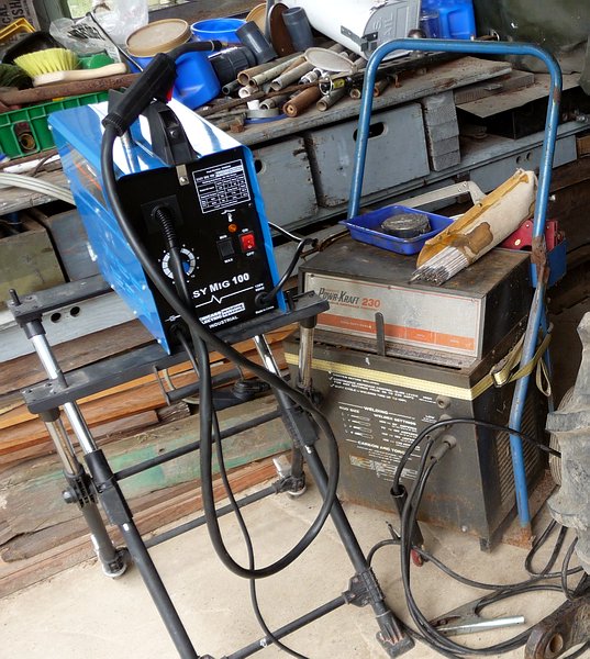

My welder is about the same size as that Tombstone. Its first owner put it on a rolling cart that was intended for an acetylene welding set. This works fine and has plenty of room to wrap the cables around.
I carry rods, clamps etc in the tray on back so it is easier to tip back.
I took this photo to illustrate something else but it should give you an idea.
(The smaller welder's stand is a lightweight folding rack.)

I watched the video. Excellent choice of music. I seriously admire your skill for detail. It's the touches like the recessed drawer pull and the airbrushed spare tire cover that set your work apart from the rest. Thanks for posting. That does give me something to think about.
