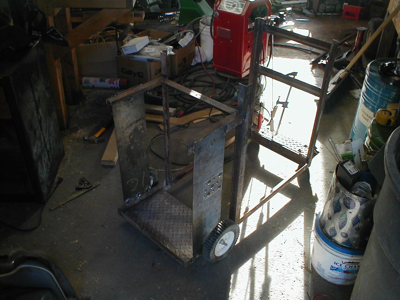

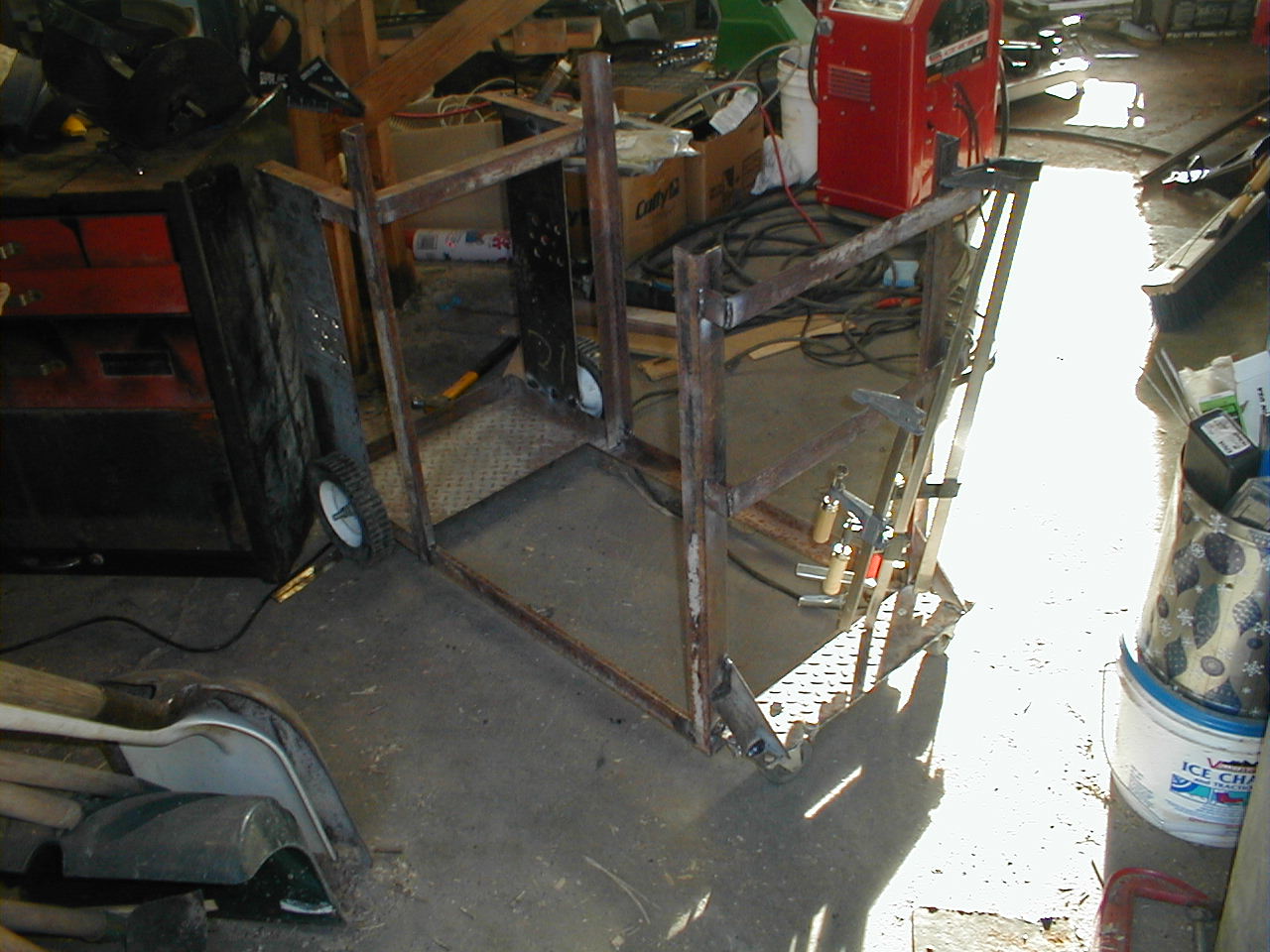

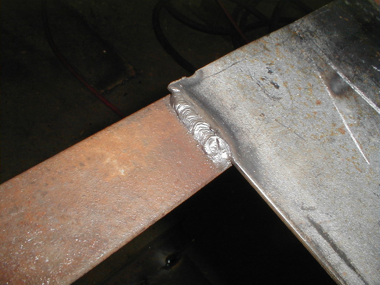

I made more progress tonight. I decided to electrically isolate the welder from the rest of the cart. The first pic is the cart at the beginning of the night with a 1/4" piece of rubber belting where the welder is going to go.
The second pic is the cart at the end of the night. Notice the holes I drilled to aid ventilation. Thanks Bronco.
I did one good weld all night. That's the third picture. I'm still working on finishing a bead without leaving a crater.

Looks like you're off to a good start. If it ends up half as good as the house is doing, then I'd have to say that you'll have a great cart.:thumbsup:

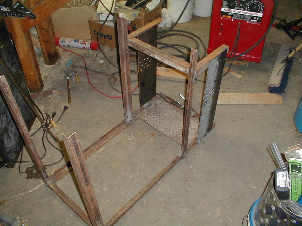

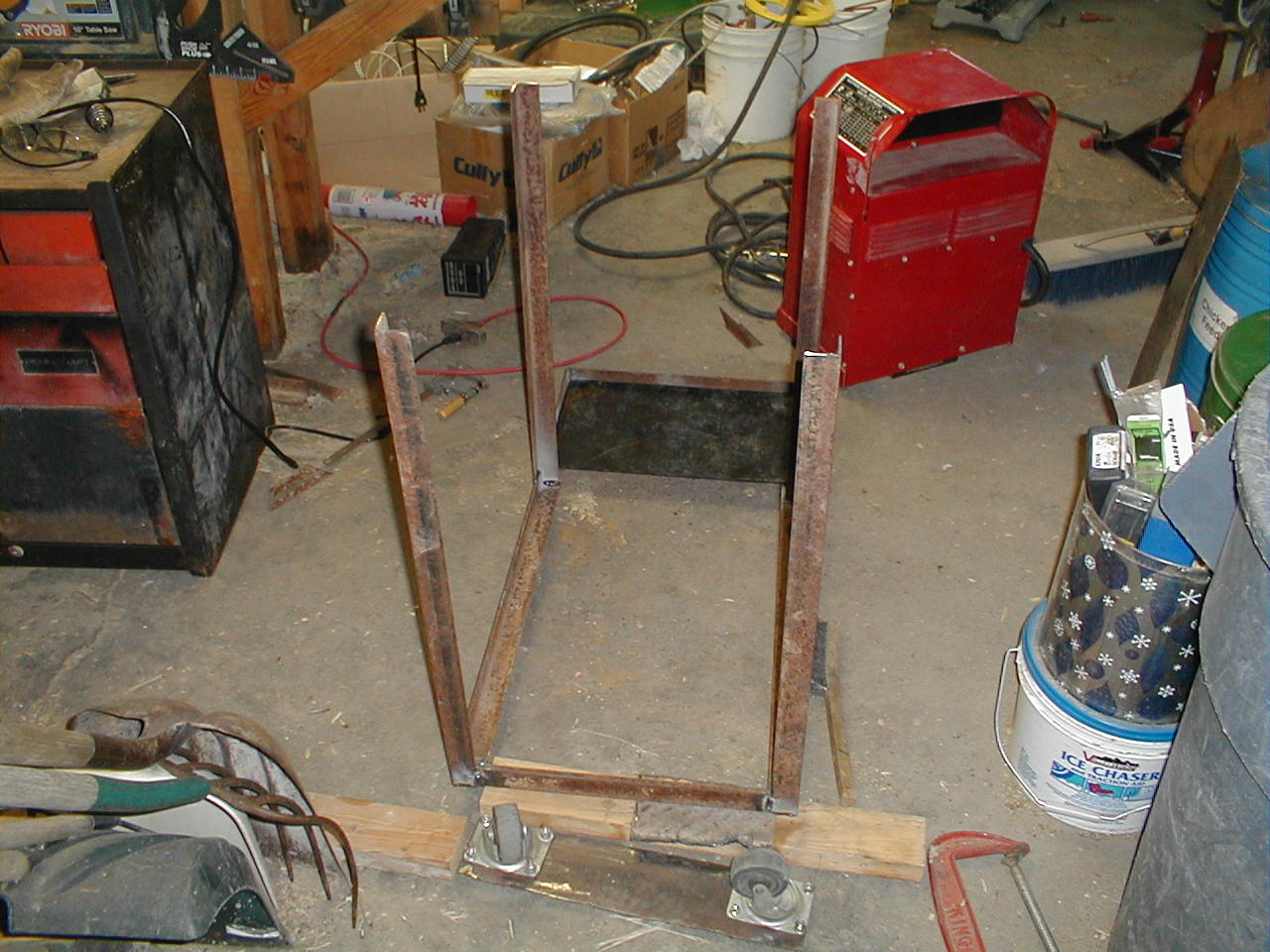

I still need to figure out something to hang the cord and the leads on. For now, I'm thinking I'll use a section of 2" pipe or bigger if I can find a scrap. I only need a few inches for each side.
I realized these pictures are not the best with all the clutter in the background and all. Hopefully you can still get an idea what the cart is like.

Farmer, looks like you're coming right along with the cart. Just an observation but are your rear wheels rated to carry the weight of the welder. I don't know what your welder weighs but I had a situation once where I bought too light of a wheel and as it (smoker) sat it would create flat spots on my wheels. I had to go up in wheel rating.
   / I'm Looking To Build A Welding Cart
#59
I hope so. These are wheels I've had around for a while. I think I got them at the Army Surplus Store. They have steel inners and roller bearings. I figured that because they had the roller bearings they were a little stronger that most that size.
Also, I think I figured out what I'm going to do for my cord hangers... Wheels. I have a few sets of old lawn mower, wheel barrow, or child's wagon wheels. I'll have to see which are wide enough. I'll remove the tire and weld the wheel to the side of the cart. That should work great without a lot of fabrication.
   / I'm Looking To Build A Welding Cart #60
Great! They'll probably work. I was just wondering. Great idea on the cord hangers. If I'd had some like you've got I'd done the same thing. Very easy and quick. Looking forward to the next series of pics.:thumbsup:
