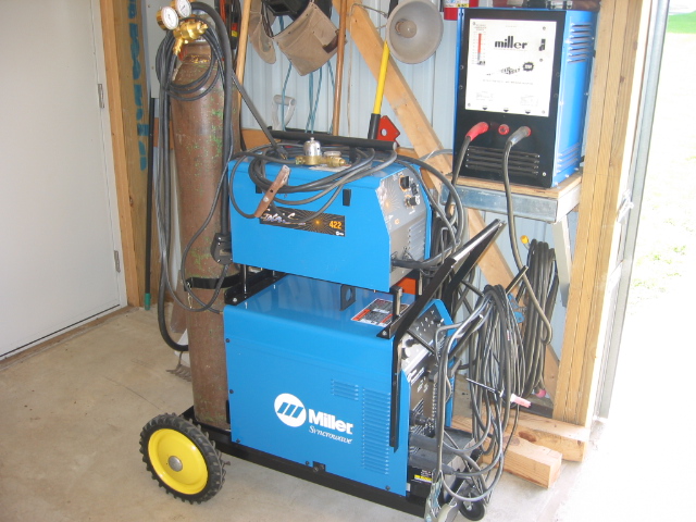

OH man building a cart is such a fun project and really a personal one. You have to design it for the environment it will be used in while keeping in mind that while your building it IF you really think things out you can add a few options.
I built my cart from scratch two years ago and it have given me many hours of very pleasurable use and fits my needs perfectly.
The only limitation you will have will be with your imagination and the important thing with all these projects is to have fun.

I saw that video when I was searching for ideas online. Is that your cart? It's incredible.
   / I'm Looking To Build A Welding Cart #23
Well I don't know if it's incredible but yes it's my cart :) Just wanted to post it to show the advantages to building things yourself and one of the biggest advantages is being able to build it the way YOU want and need it.OH it's fun as well :thumbsup:

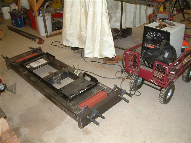

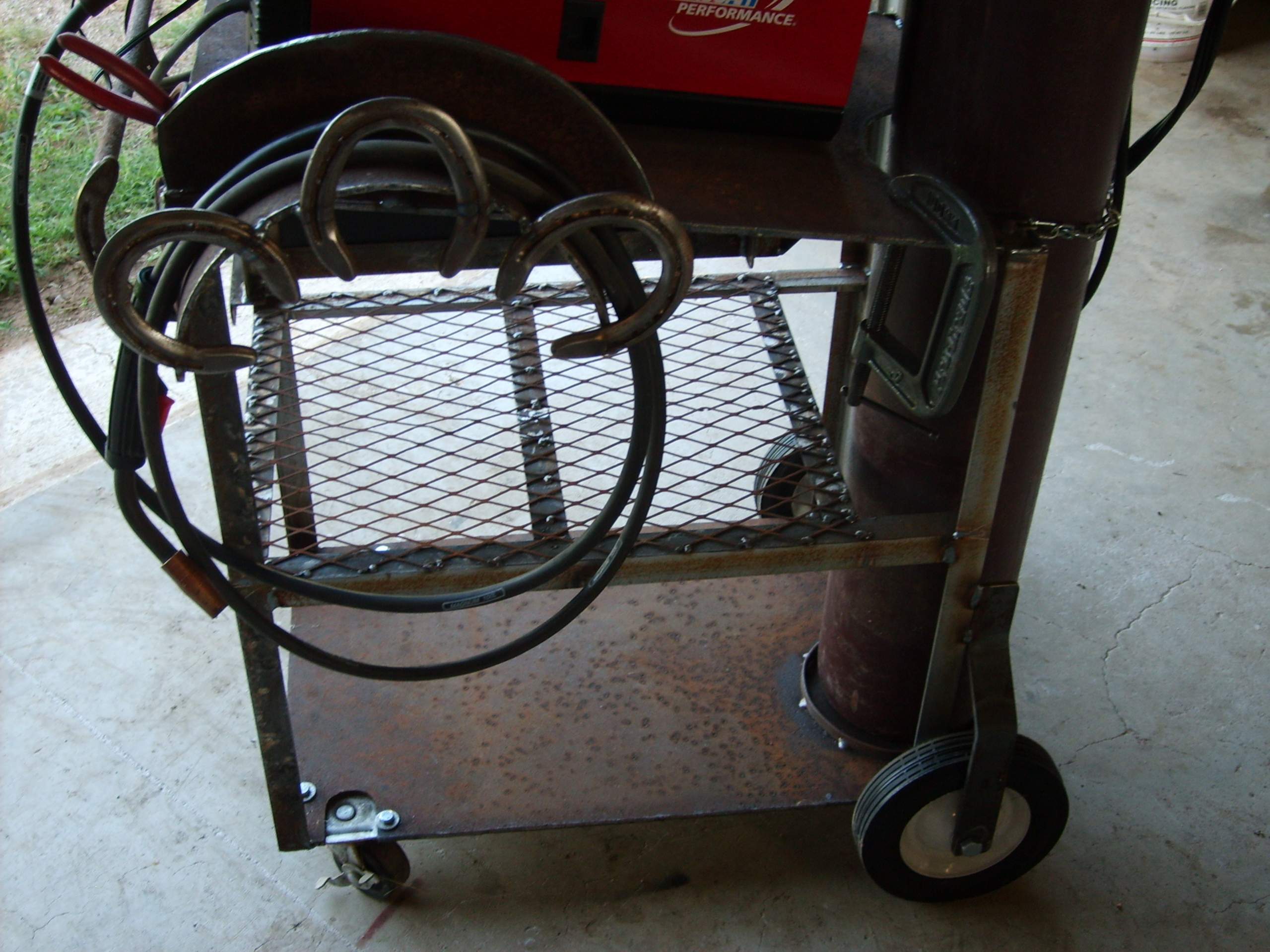

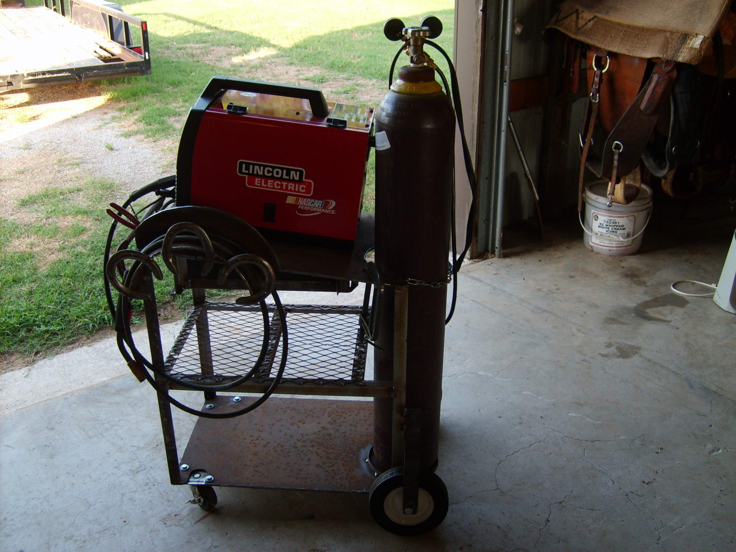

I have to say, the spare tire takes the cake for cool. I don't have plans for a spare tire on my build, but I do plan to make it my own. I started fabrication last night, and I've already changed the plan a bit. Nothing real exciting yet... just the base frame.
I have to add that on this project I'm getting some quality time finally with my DC welder. I'm beginning to understand why so many have said that DC is MUCH better.

You might think your out of the woods when it comes to a basic cart and I can see your off to a great start and yes DC is much nicer to use. I'm bett'en you'll add some nice touches to it as you go along.
When I went to make my welding trailer I started off with a rectangular chalk line on the floor and when I got it completed I had this made. :shocked:

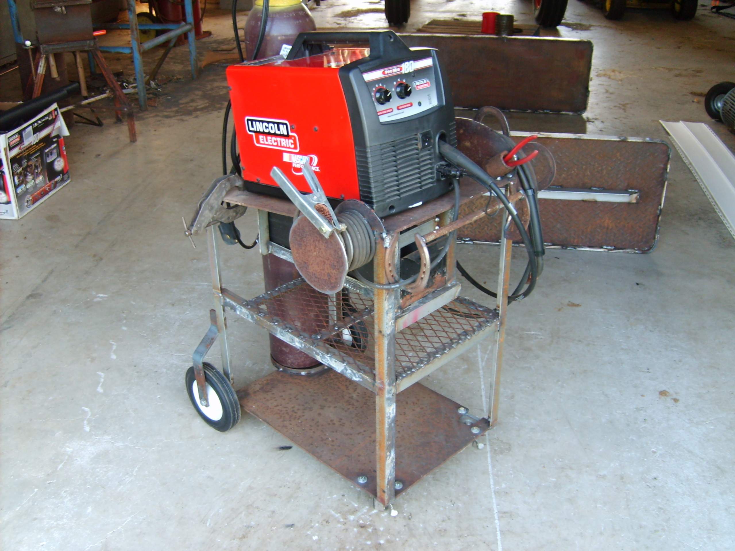

My welder is about the same size as that Tombstone. Its first owner put it on a rolling cart that was intended for an acetylene welding set. This works fine and has plenty of room to wrap the cables around.
I carry rods, clamps etc in the tray on back so it is easier to tip back.
I took this photo to illustrate something else but it should give you an idea.
(The smaller welder's stand is a lightweight folding rack.)
