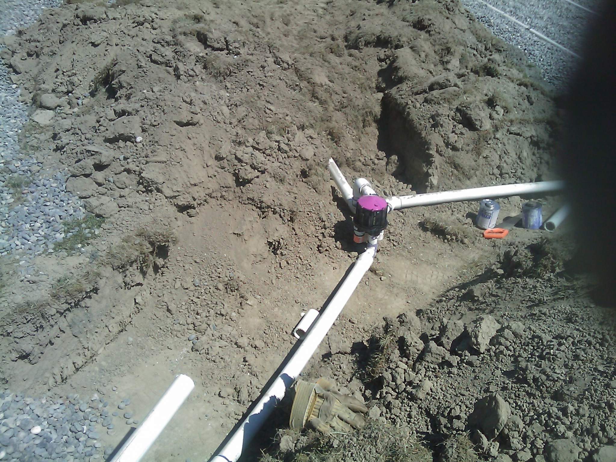

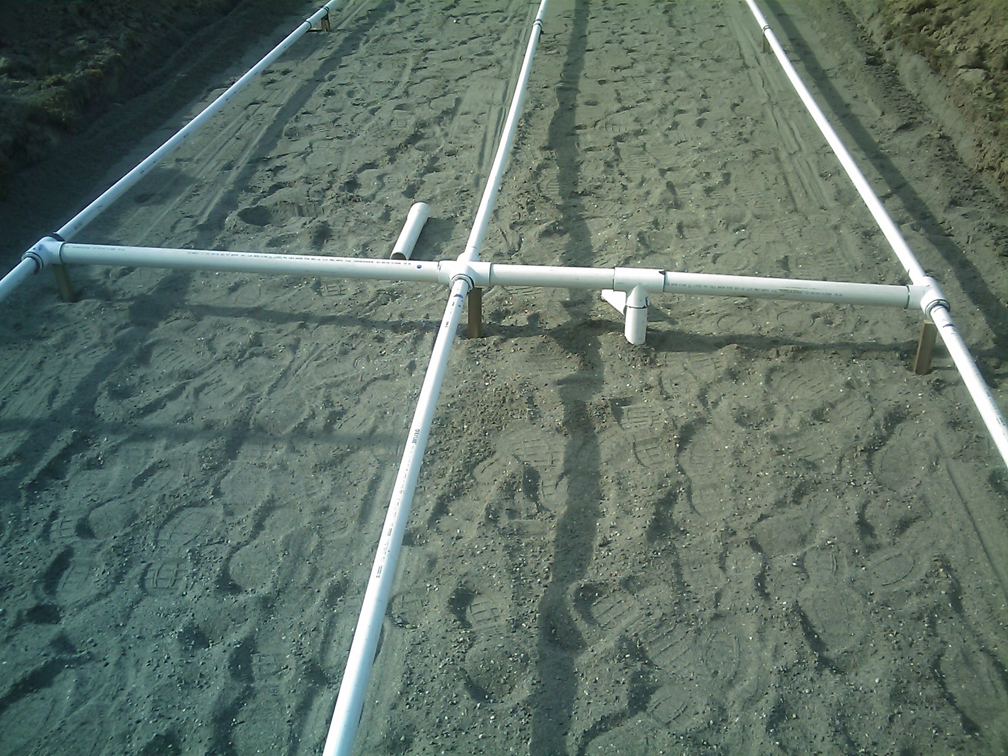

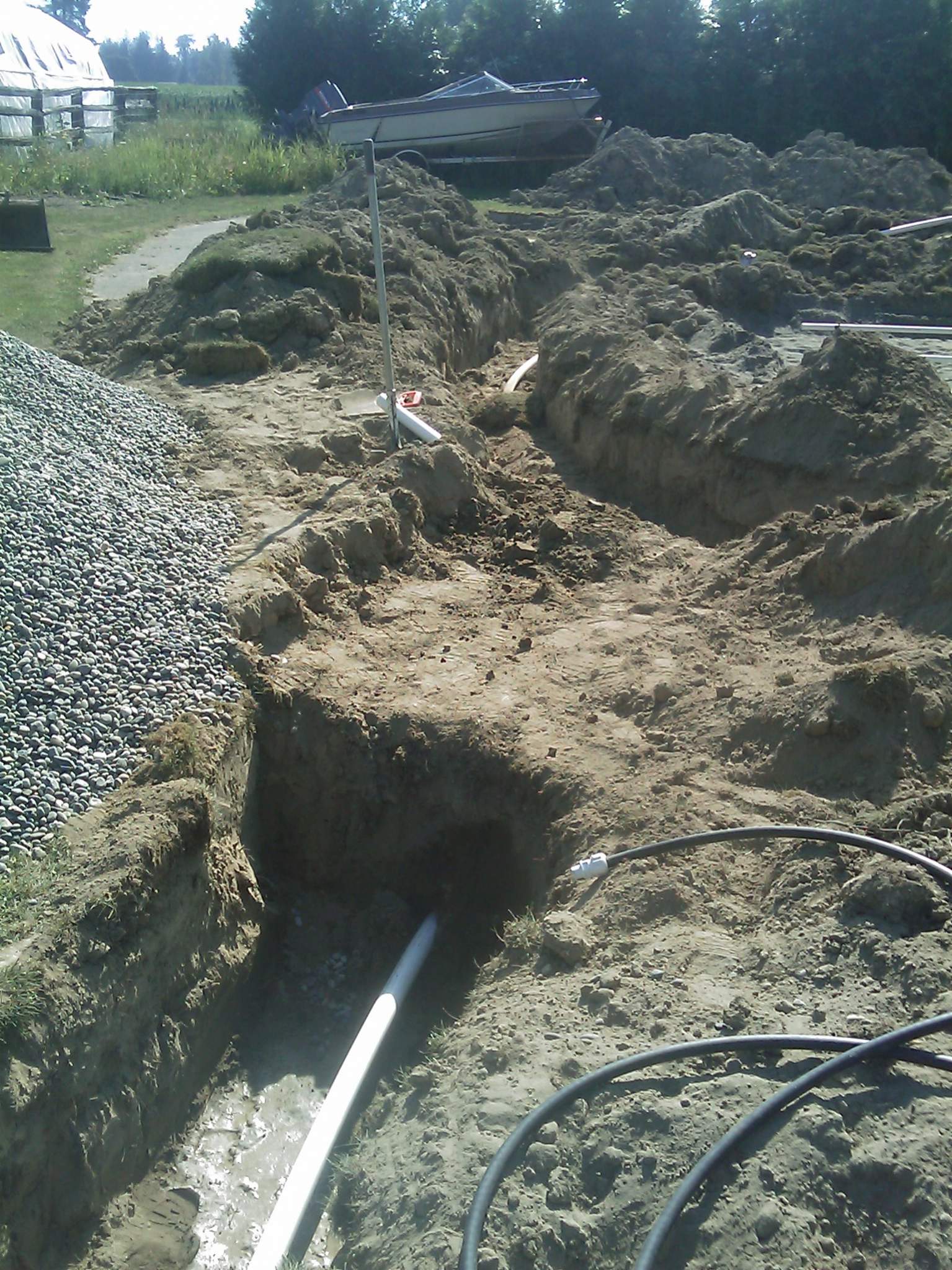

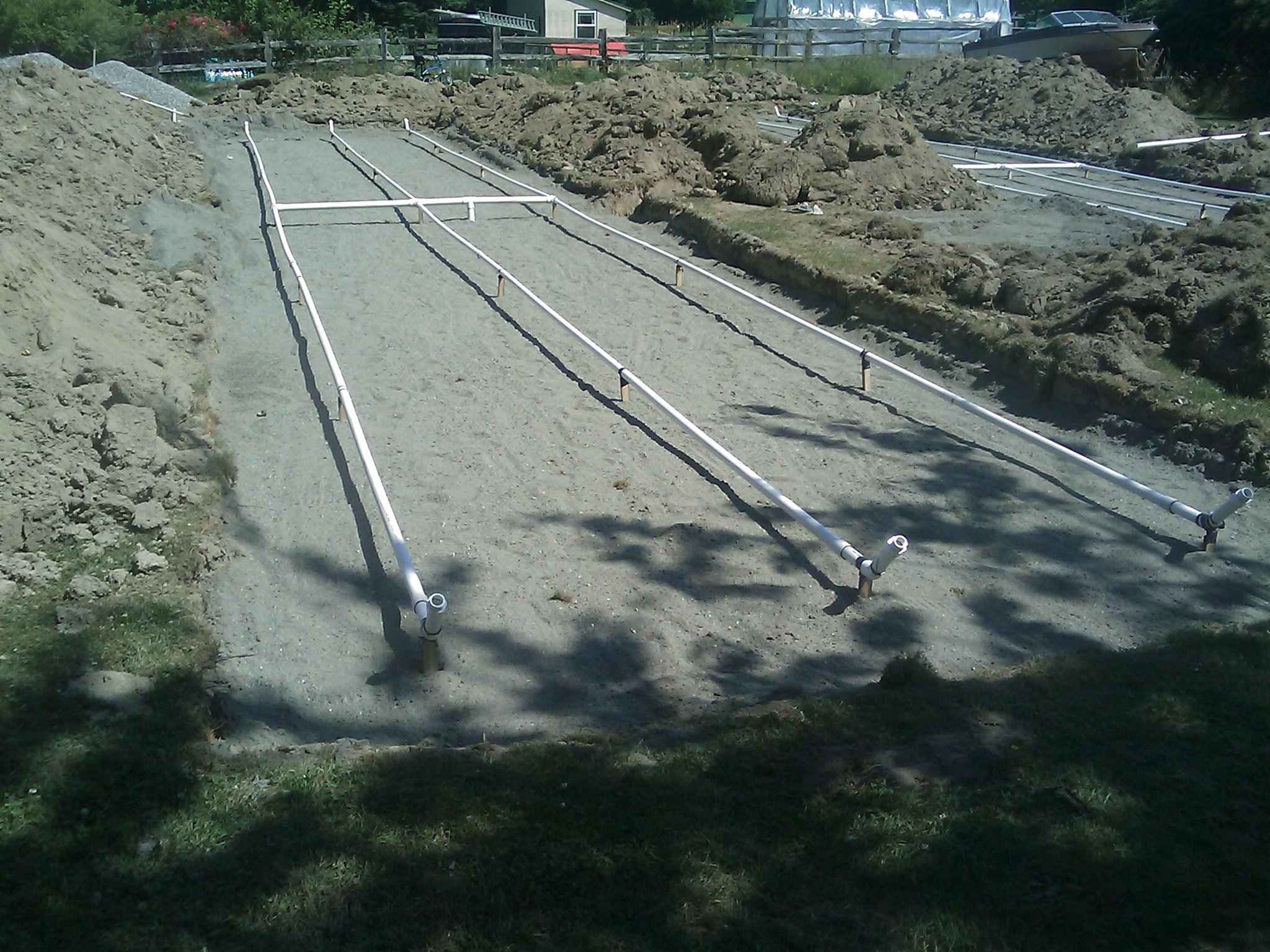

Hey, no problem!. Heres the rest of the installation. I guess this thread is more about installing a drainfield than my hoe. I actually do most of the work with my little mini. I just use the backhoe to dig out the beds and install the tanks.
Heres the network ready for drainrock

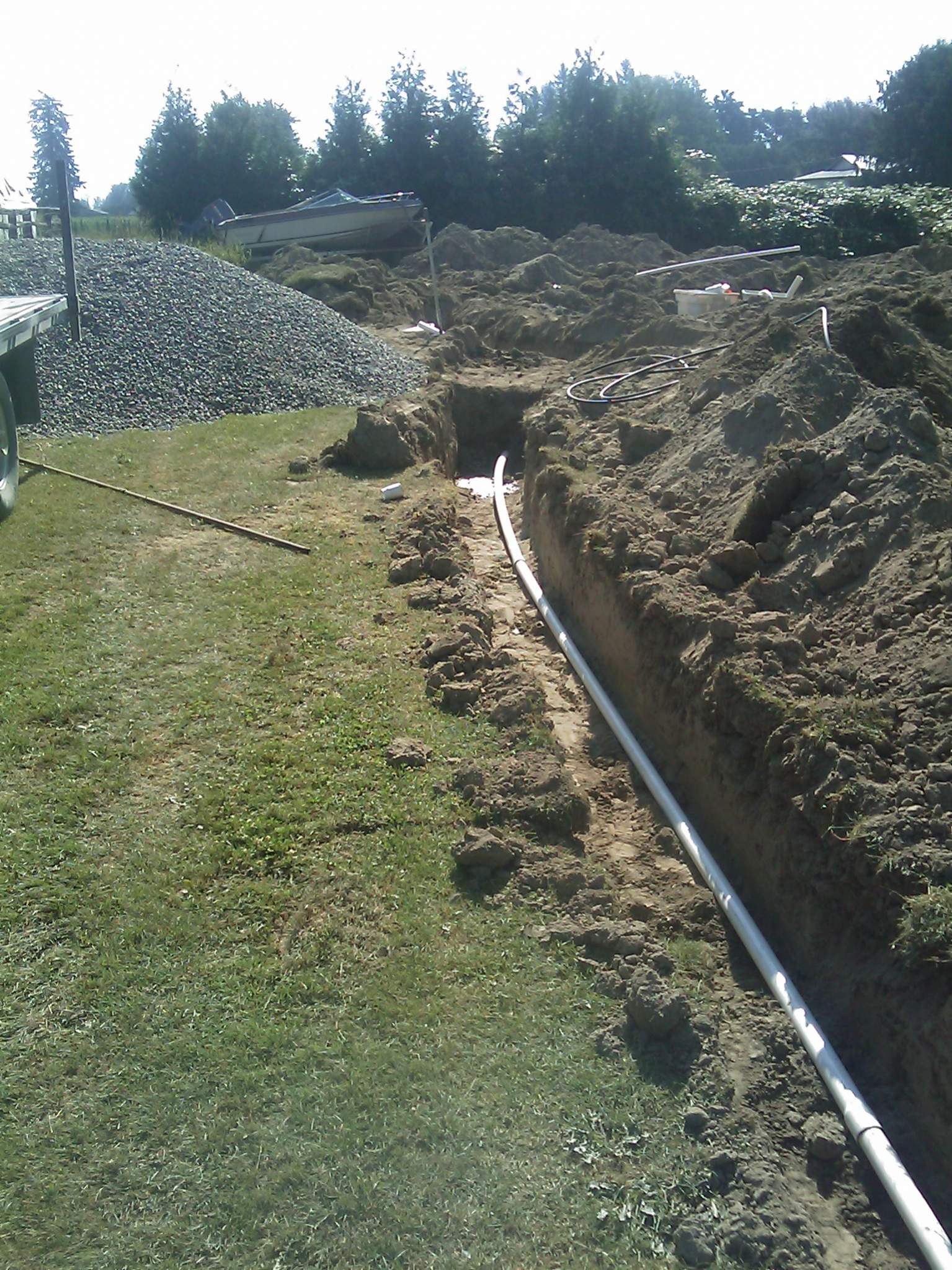

force main. How did I get under the asphalt pathway?:D

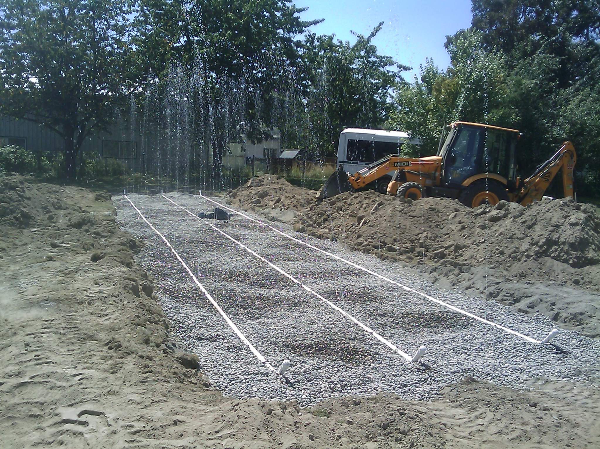

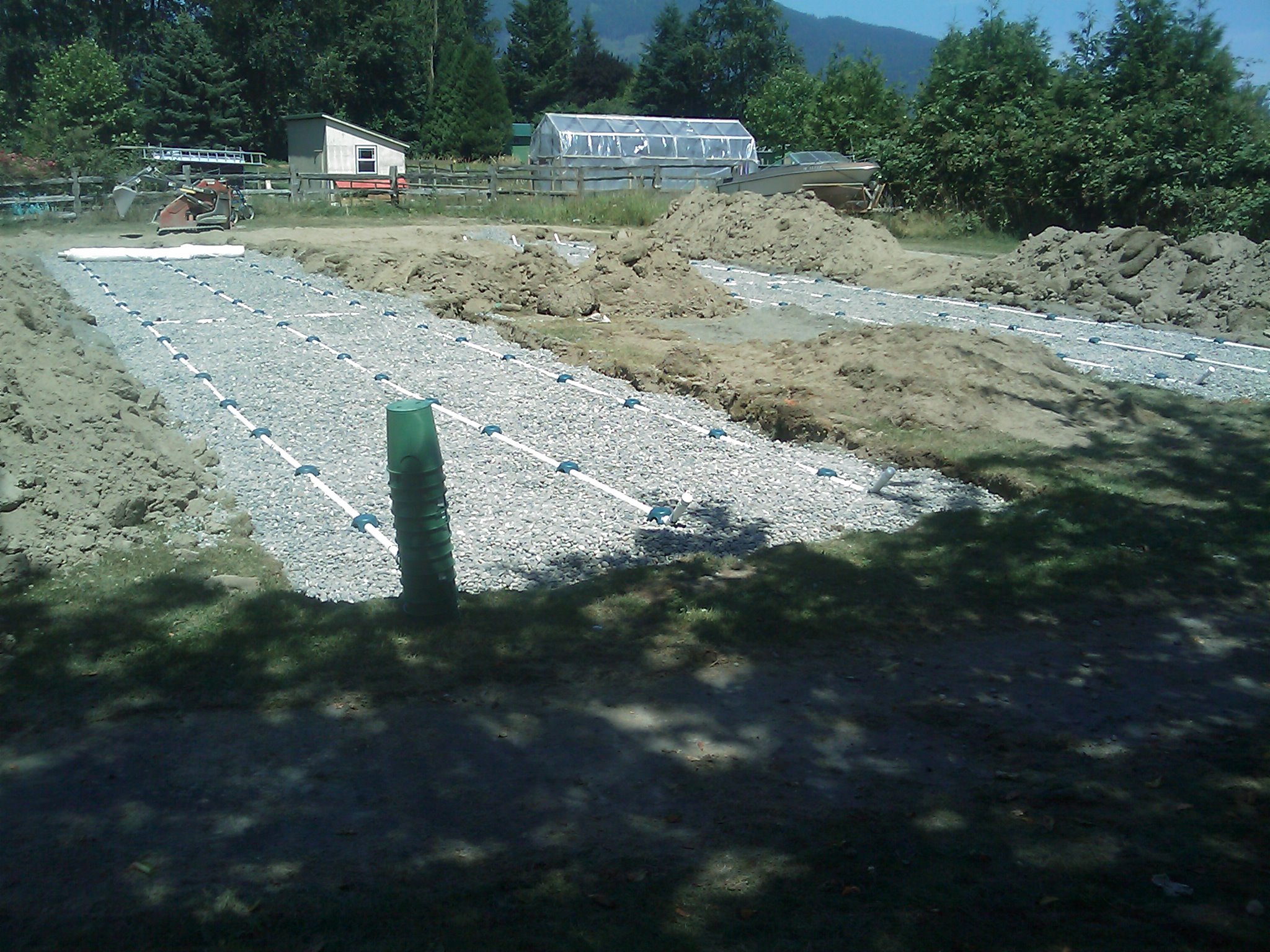

heres the bed ready for the all important squirt test.....squirt test, whew. Got my residual head..... and the mechanical zoning valve that alternates the two beds.

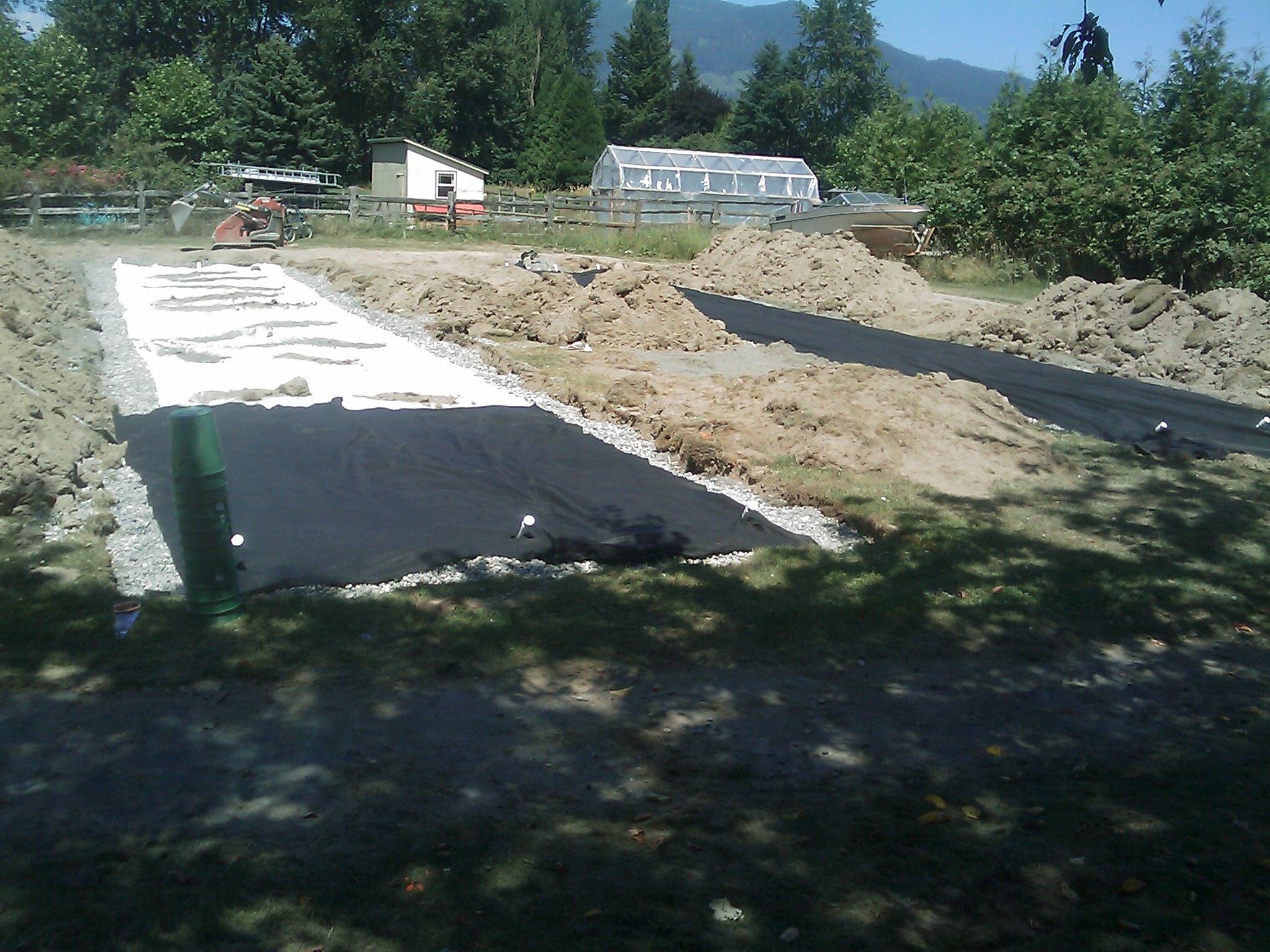

here is the bed woith orifice shields installed, and then cloth, ready for backfill.

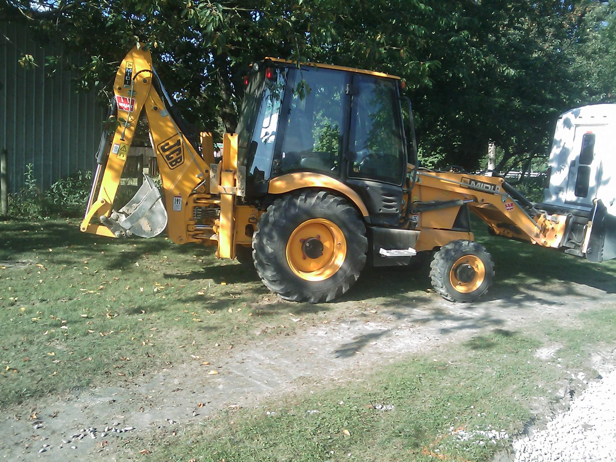

and heres my little toy under the cherry trees I had to work around. Notice how 7 feet fits under the canopy builder?....Way better than 12 feet...?:D
   / I'm showing off my new toy!
#47
oops, here it is.
   / I'm showing off my new toy! #48
Tell me about it - when I'm having a good day the limbs fall elsewhere than on the cab.
And sheds can be a bigger drama!
Noticed on the JCB site that they say the engine is a JCB. I assume they mean Perkins (owned by Cat I think) built to their specs?
Actually I have no idea who makes the engine. It has JCB plastered all over it. They are a huge company. Don't they make their own?
   / I'm showing off my new toy! #50
JCB started making their own after Cat bought Perkins... I don't know dates...
