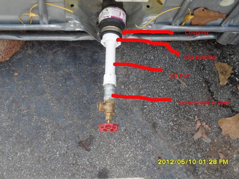

Newbury, can you tell me where I can find fitting for those tanks?
Now I can.
After much research on the web, checking out all the places that sell IBC containers, hours of diligent work (NOT):
Riley Building Supplies, Fulton, MS
attachment.php
2x1 1/2 in coupling $1.05
1 1/2 x 2 3/4 PVC Slip Bushing $5.09
3/4 PVC Ball Valve - $3.59 (didn't use because I found the other on a wall in the milling shed)
3/4 x 6? PVC SCH 40
The guy at the hardware store advised me to glue the PVC parts together with the special PVC glue, but for my application I just pushed them together.
I found the outdoor faucet in my shed so I used that instead.

Maybe for water... but not for a $ 1,000 worth of fuel.
Too low, too slow, too leakable with that valve and fuel, and most of all too easily broken off.
   / I'm tired of diesel 50 gallons at a time ... #60
For Fuel I bought a hand pump from TSC for $144 and will fit it on the top bung, or drill a separate hole and support it on a board.
