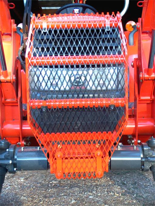

Finished the brush guard project today. Used expandable metal, u-bolts, metal bars and bolts, and two cans of paint, total about $30. The Ace Hardware orange paint called "Allis Chambers" is a perfect match for the Grand L Kubotas. This is the same size bumper that fits all the Grand L's. See Attached photo. /forums/images/graemlins/wink.gif
Thanks all for the ideas,
TXDon

Txdon, I printed off a copy of your photo, for my project folder. Looks great. Are you going out to tackle another road building project now that you have the guard? How about a skid plate for underneath. That tractor sure looks clean in the photo.

Sassafraspete, Oh yeah, I have many roads to clear in my back 50. I was wondering if Kubota has skid plates or if this will be another homemade tractor project? If it is another project has anybody attempted it yet?
TXDon
   / Impaled - Need Protection Need Brush Guard #38
The brush guard looks great. you do nice work. I am not sure about the skid plate & who makes them but I have seen such an item. I do believe that they were coustom made by the dealer.
   / Impaled - Need Protection Need Brush Guard #39
txdon,
From the front view, it looks as you have a grand L "30" series tractor so this may not even apply. However, I have been considering adding some type of brush guard to the front of my L3710/LA682 setup. After noticing how close the boom brace (and hydraulic lines that run across it) come to the front of the tractor when the boom is in the complete down position (front wheels off the ground), I am very "iffy" about running the brush guard all the way to the bottom. It has been a while so the proximity of the two components may not be as close as I remember. I'll try to remember to check it again next time I have the tractor out.
Your brush guard looks great. Good work!
Jeff
   / Impaled - Need Protection Need Brush Guard #40
Nice job, Don. With using the u-bolts, if you take a limb thru the expanded metal or decide to use something else, it will be a snap to replace. If I were a betting man, I'd bet that will last you for many, many years. /forums/images/graemlins/cool.gif
