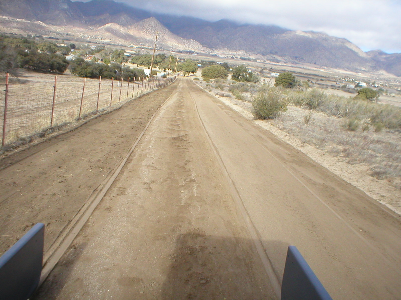

With 1/2 mile of road to maintain, you would be well off to have one of these road grader blades. While there are times when I use my box blade and my rear blade on my over 2 miles of roads, I would hate to be without my grader blades. :thumbsup::thumbsup:
Everything attachments has these also, but I could not get the link to work. :(
Land Pride Grading Scrapers
GradeMaster Grader Blades
Road Boss Grader - Road and Landscape Grading, Surfacing and Leveling, and Material Spreading and Reclamation
