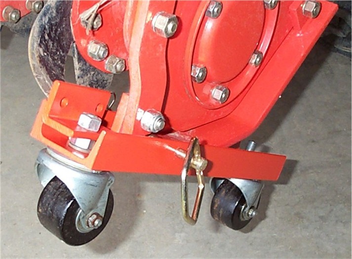

</font><font color="blue" class="small">( I made a set of dollies for my tiller that slip over the depth runners. They are simple to make and they sure make it easy to install, remove and store the tiller (picture attached).)</font>
I wish you had posted this about two years ago when I got my First Choice tiller. I made a dolly out of scraps of mahogany. The mahogany was from the crate my first Kubota was shipped to the dealer in. The tiller is built like a tank, and until I saw your dolly, I thought the dolly was pretty nice too.
