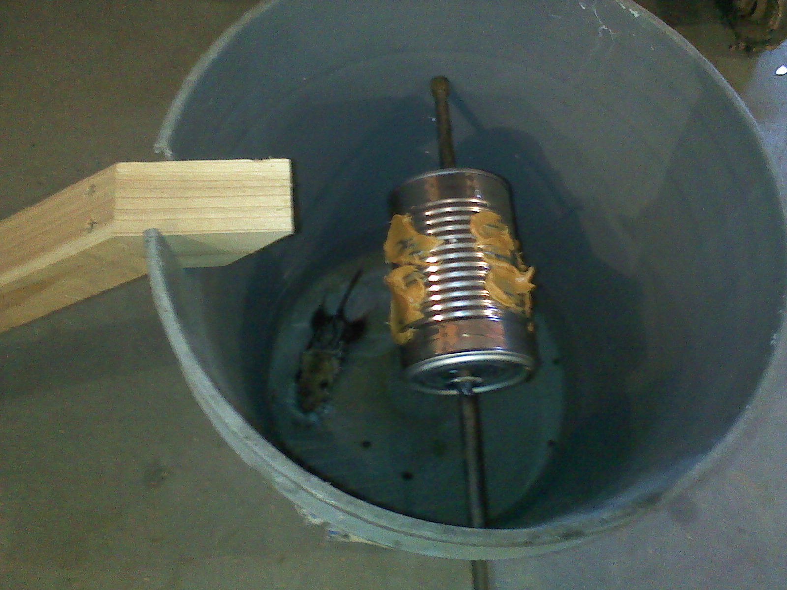

OK all, I finally got my mouse bucket built. First night and no mice..hmm wonder if they have too much grass seed hid. Does this look OK or do I need to addjust any thing?
It looks ok as long as the can spins easily. I've always used a stiff wire for the axle and kept it higher in the bucket so they jump over to it instead of down so far, but I think your's will work the same. You'll know if it isn't spinning enough if your bait disappears and you haven't caught anything. I keep my traps right up against a wall though. Mice usually travel within an inch of the outside walls so you'll get more traffic if you set traps there.
   / Inexpensive mouse trap #27
I did not get time to check it tonight. My shop is heated so it does not freeze, no pets get in there. The axle was a 3/8 scap rod, juice can, I tack welded a 1/4" washer each side of the can and left 1/2" clearance so the can rolls very freely. I wondered if I had the can too low or too short of walk way. I can raise the can easy enough if that would help. I have not seen any measurements so I was not sure where all parts clearance needed to be.
I might move it to a different spot.
Those darn critters keep getting in my seed bags and makes a mess then I loose a lot of seed.
   / Inexpensive mouse trap #28
Well I got ONE at this time
