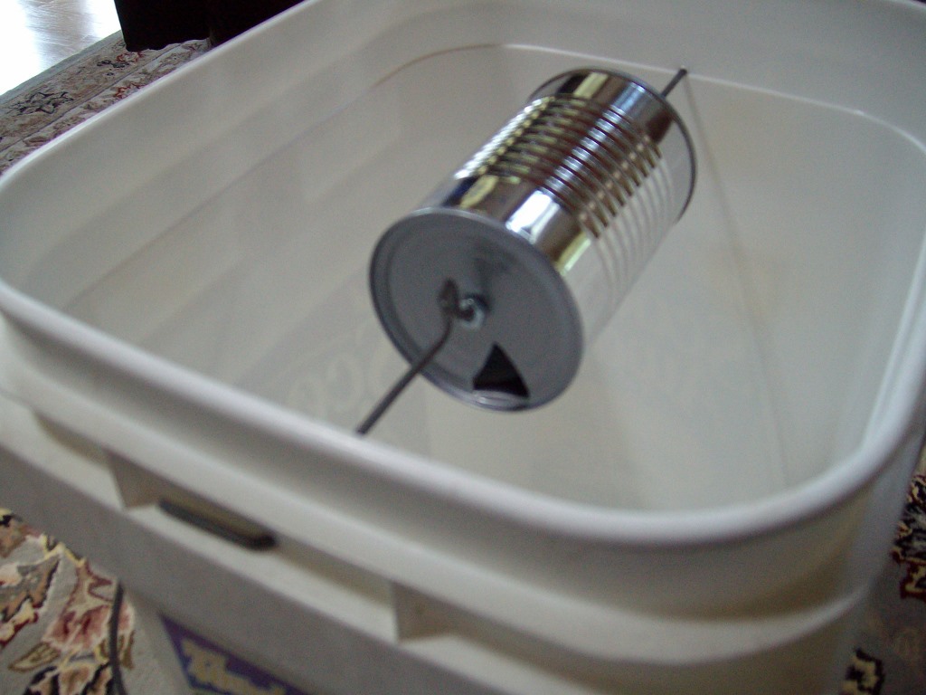

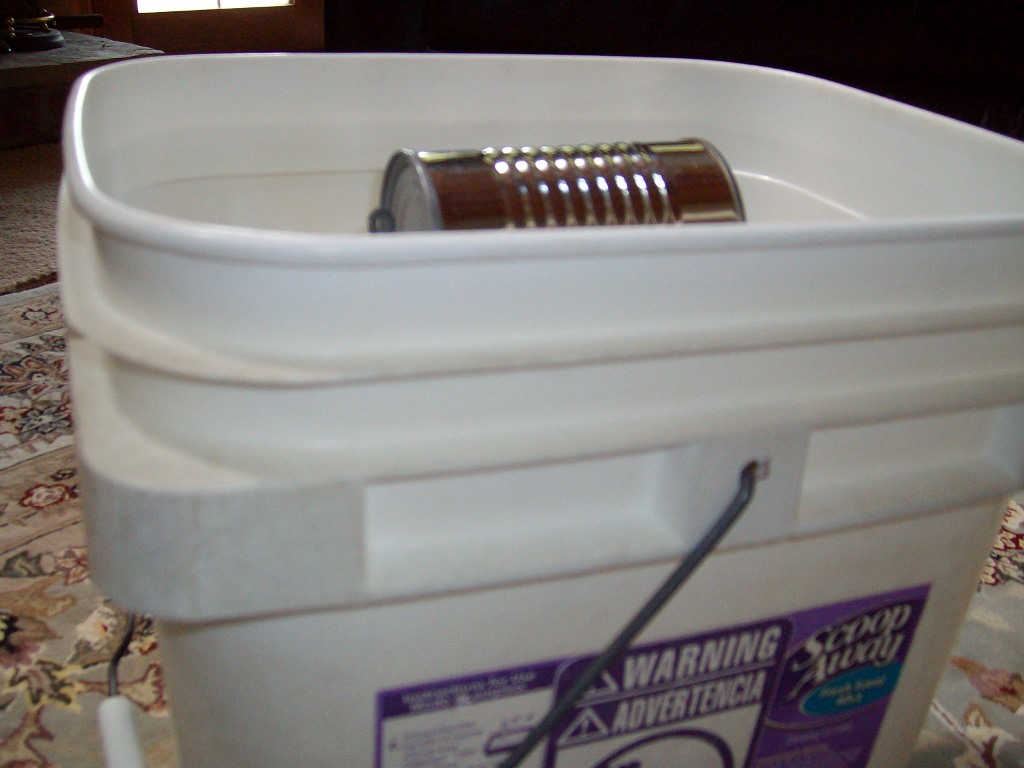

Update: Didn't see anything about distance below the top of the bucket, so I guessed at about 1/2" - 1". Turned out pretty good, I think. I made ramps out of 24" long strips off a 2x4 and placed a single screw about 2" down from one end to hang on the edge of the bucket. This makes for a 2" long "diving board" that is just about 1 mouse length from the nearest edge of the can.

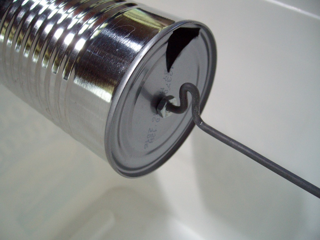

Used a couple of small nuts on each end for "bearings".
Made 5 traps. We've caught several victims so far in the attic and in the in-law's shed where he keeps horse feed. Didn't really expect to catch a lot right now since it is warm and there should be plentiful food outside. But they're built, tested, and ready to go this fall!
Note: If these are used in an attic in the summertime and you don't use antifreeze or some form of preservative in the water, your victims WILL slowly parboil and putrify in the heat. So they still need to be checked every day or two. Else, your wife gets disgusted when she goes to check and empty them! :irked:
- Jay
