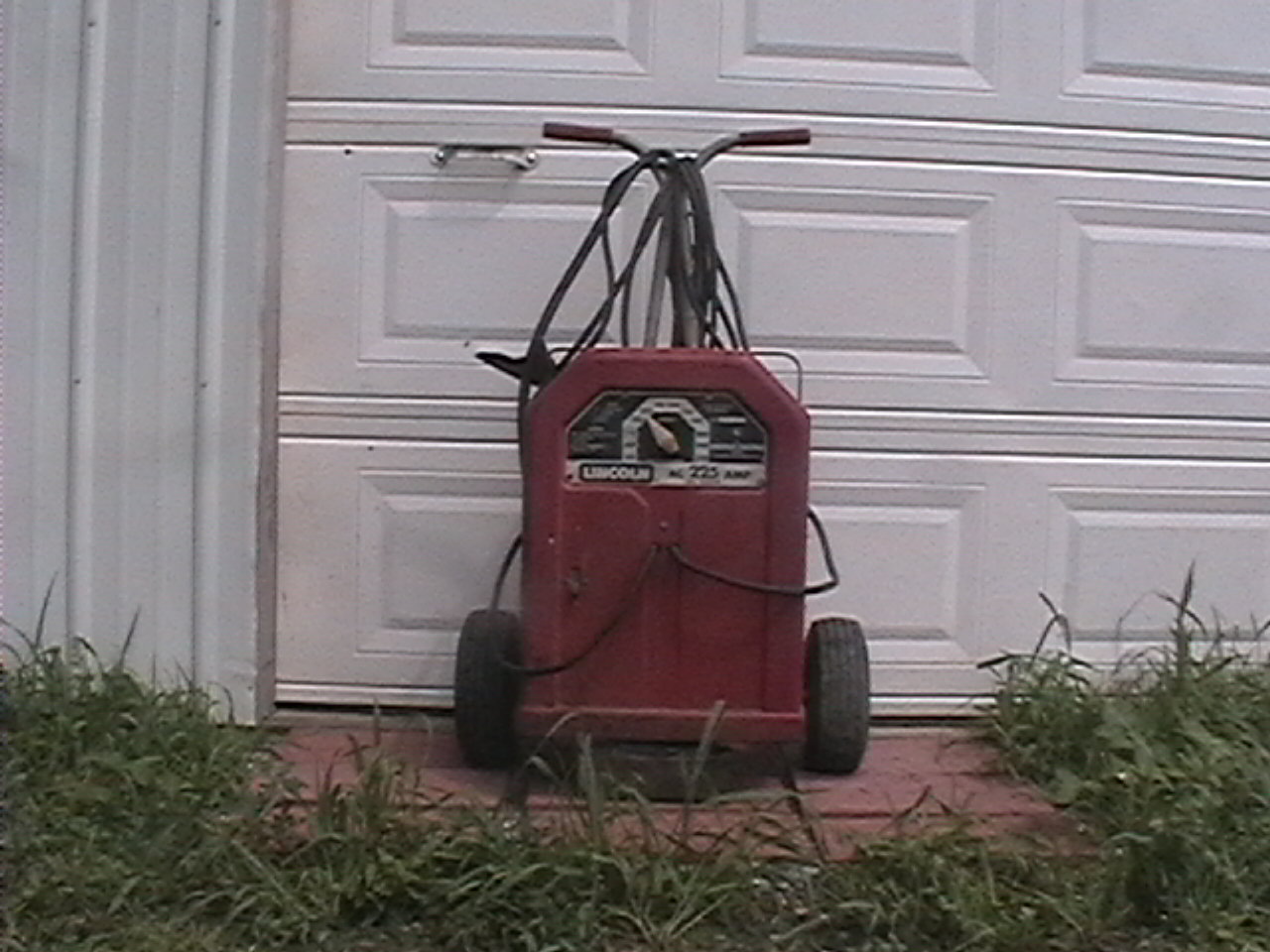

And so we come full circle, what he can get for $50. Here's what I got for $50, with cables and mobile cart. I've read it was made by Century in the 60's.
http://s93445617.onlinehome.us/pix/ym240/arcwelder2989r.jpg
I still think a big old cheap welder is the way to start, at least for hobby use. Learn to use it, then decide if you need more specialized gear after you have the experience to make an intelligent choice.
