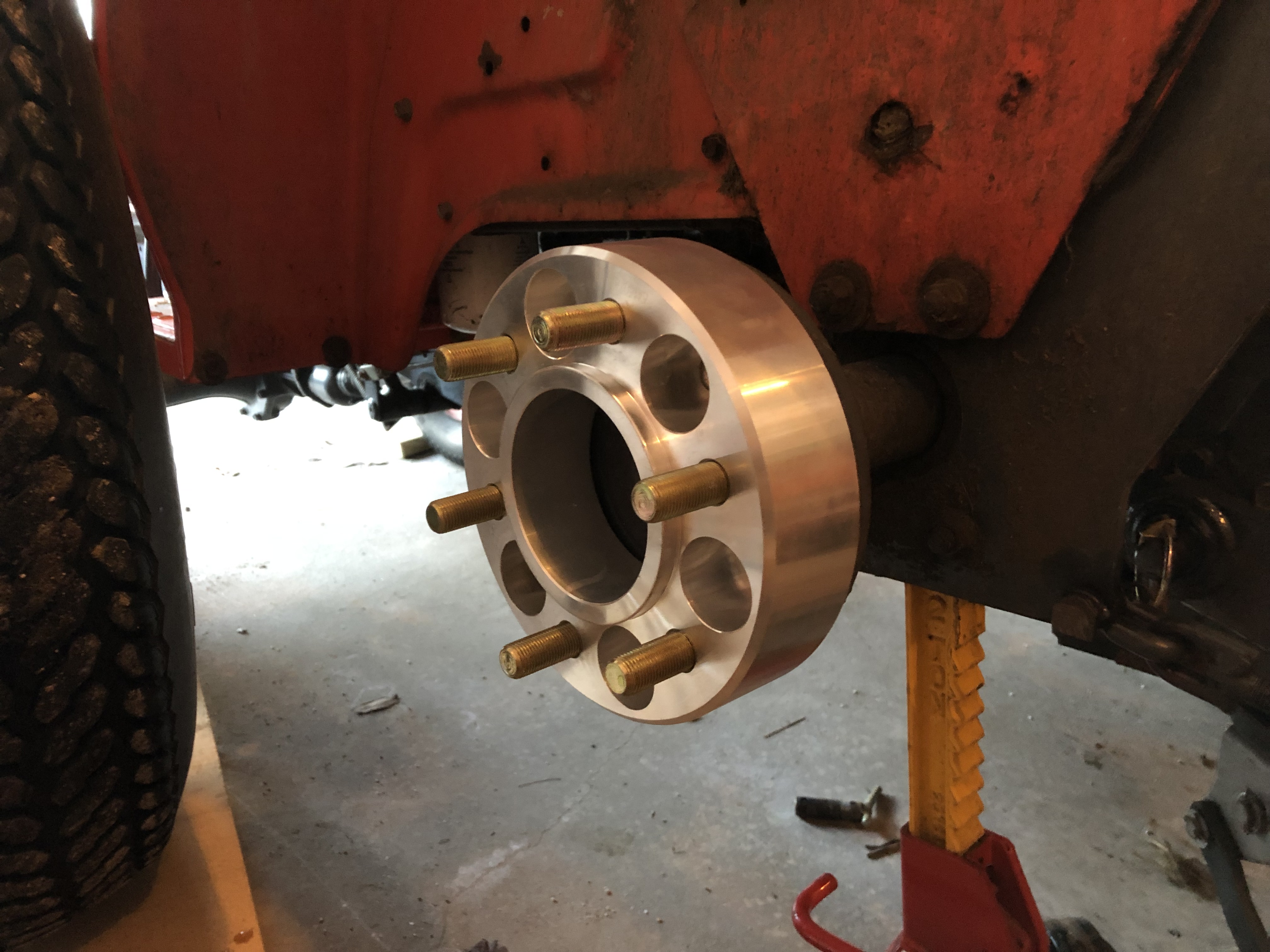

The only ones they had listed for mine were the steel ones and at the time they were the only company I could find that made spacers for my tractor. I searched for other companies that make them and ended up emailing Richard at Bro-Tek in Canada to ask if they could make them. They didn't currently make them for my tractor but he said they could. He was very pleasant to deal with and although I had a slight delay due to them needing to confirm dimensions on an identical tractor before making them, Richard was up front about it all and didn't ask for any payment until they were ready to ship. The Bro-Tek ones are aluminum.
   / Installing wheel spacers on Kubota B2150
#14

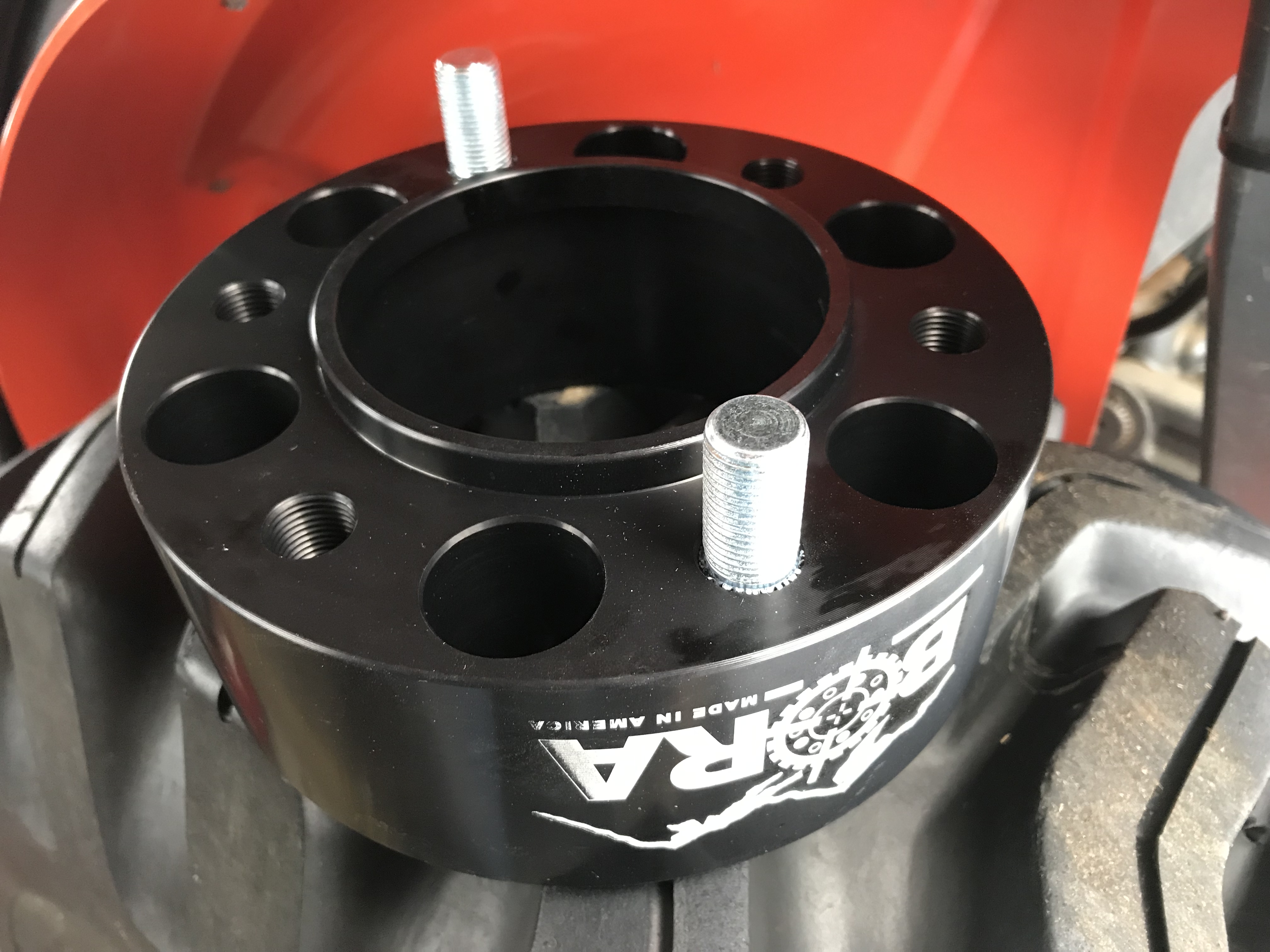

Here's the Bora. I like that they mimic the OE pattern of just two studs - makes getting a 500# tire/wheel assembly back on...2018-12-01 14.11.35.jpg
   / Installing wheel spacers on Kubota B2150 #16
Thanks to both of you for posting the pictures. I am leaning towards buying the Bora. I too like the way they mimic the original Kubota layout.

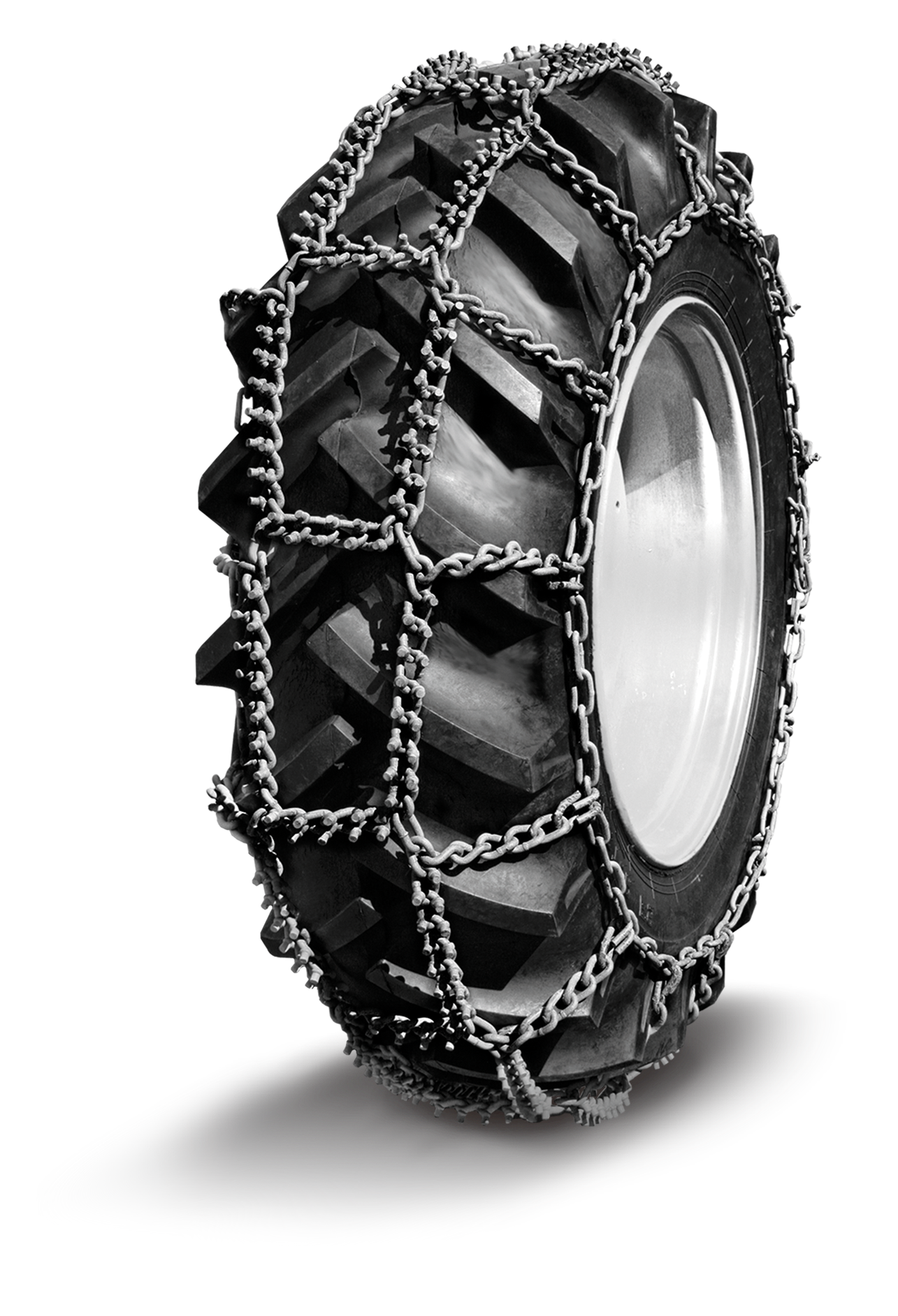

I haven't installed them yet, but I bought Euro style chains that seem to avoid the "falling in between lugs" issue.
Eko | Tractor and Snow chains | Products | OFA
   / Installing wheel spacers on Kubota B2150 #18
I have simple ladder type chains. The ones you have should work MUCH better than what I have.
