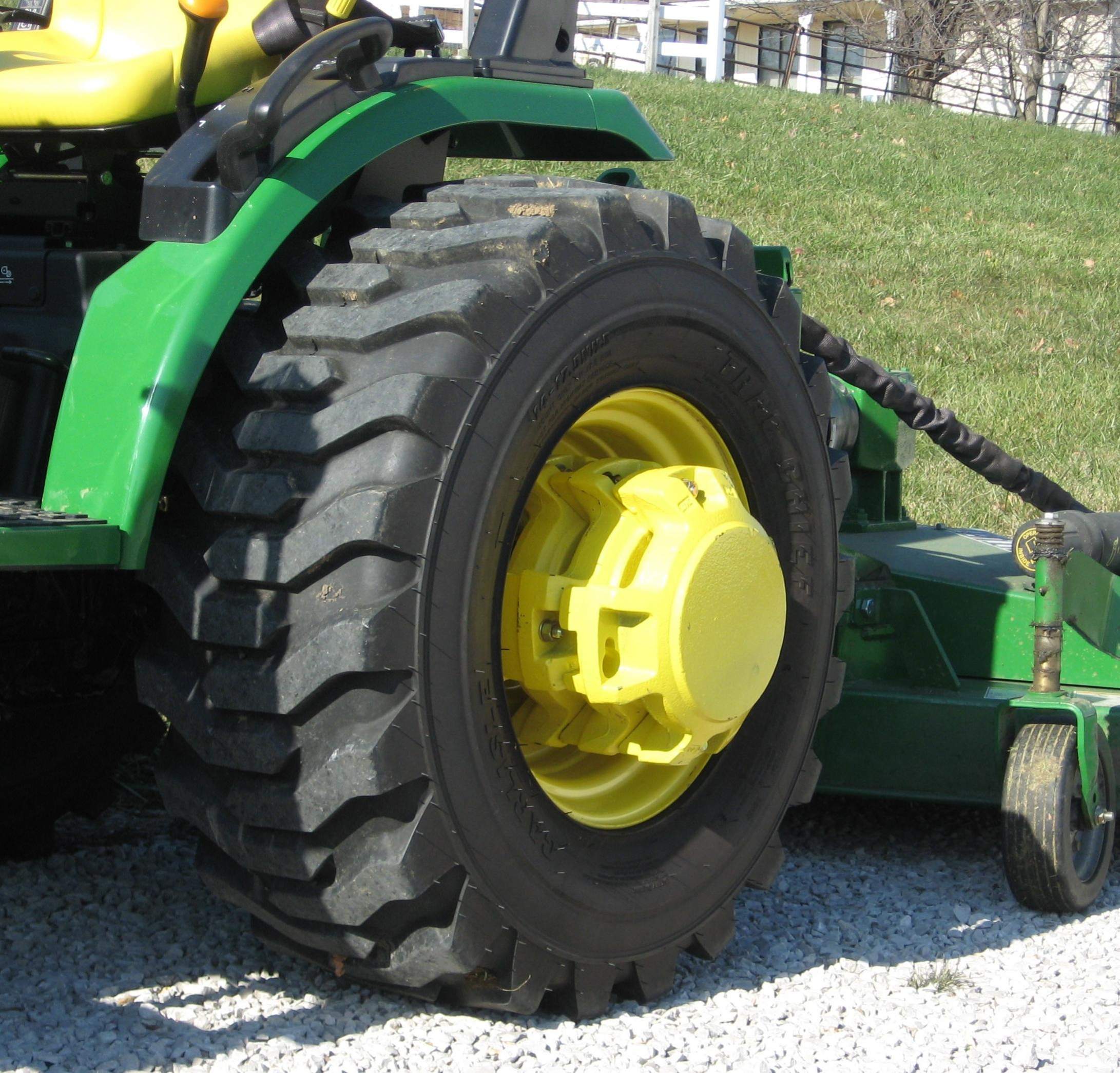

I have a pair of JD wheel weights that I bought for my JD 2305. The weights weigh 50 pounds each. I could muscle these things into the wheel wells, struggle to align the bolts, bang up the paint job, and whatnot, but I'm wondering if there is an easier way.
I have designed a little gadget that will allow me to pick up a weight with a jack, slide the weight into the wheel well, and rotate it to line up the bolt holes. My wife is already laughing at it, and I haven't even made this thing yet.
I have searched the archives and have found no examples of people describing how they intall wheel weights conveniently. My idea of convenient is something that could be done by someone who is disabled or who is just lazy (like me). My idea of convenient is the way I handle all my implements: each one is stored on its own cart that I can wheel around the shop floor without hard pulling.
Is there anyone out there who can share a picture or an idea of mounting wheel weights the easy way?

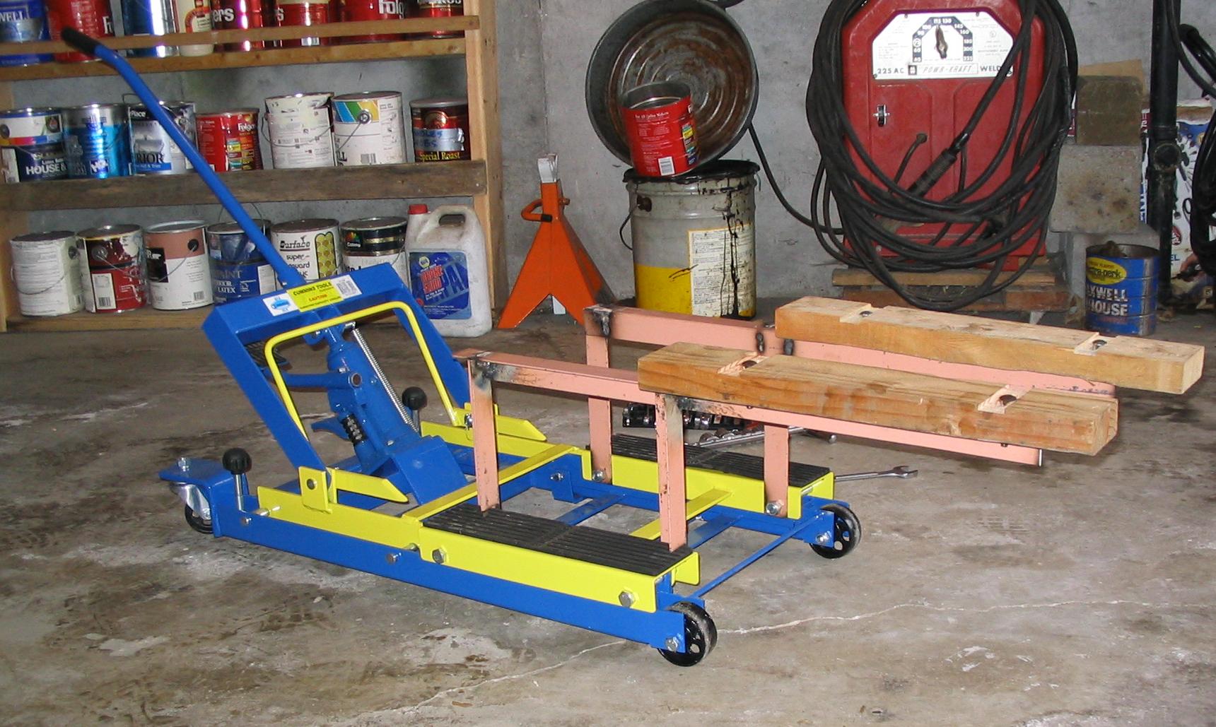

I've thought about this issue too, but as of yet, haven't come up with a good idea of how to make a device to hold the weights. What I'm thinking of is to use a modified motorcycle jack with some mini-pallet forks on it and maybe bolts to go through the unused bolt holes on the weight.

Here's an example of what I'm talking about. I made this device to hold the outdrives for my boats while I'm removing/installing them for service. I'm thinking there might be a way to adapt this to hold wheel weights.
When using it, if I need more weight on the back to counterbalance the forks, I just hang a concrete block on the handle.

I work for General Electric Transportation and build locomotives in Erie PA, I was able to get some cutouts from our burn area that are 3/4" thick and just about 12" diameter, just fits in the wheel perfectly. I drilled a 1" hole in the center then made 2 brackets out of 2" wide by 5/16" thick long enough to mount to the factory weight holes and welded a 1" round bar in the center bolted them on and leave them on all the time. They weigh about 25lbs. each and I can just slide them on one at a time. I can put 6 or 7 on each wheel without sticking out past the tire. I hold them on with a 1/4" lynch pin. Very easy to install or remove, I had the tires on my old tractor(a ford 1310 19 hp 4x4) loaded with calcium cloride for a long time but didn't like the ruts in my yard in the spring so I came up with this design it works great and cost was about 10 cents per pound from our onsite scrap yard. PS since the price of steel has gone up it now would cost me 15 cents a pound still a bargin don't you think?
