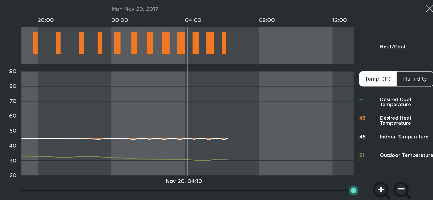

I'm having a hard time figuring this out.
I have a 12' x 18' well house with a 5 pitch roof.
The structure has a single 2' x 3' double pane window.
Roof rafters have 6" of open cell foam.
Walls have 3.5" of closed cell.
6" slab on grade has 2" of closed cell on top of it.
Well head is inside structure, coming up through concrete and feeds a 100 gallon galvanized (non-bladder) pressure tank (through a few feet of pipe with pressure switch).
I have a 500 watt, 220v heater for the structure, connected to an Ecobee thermostat (so I can monitor and record the inside and outside temp, as well as control the heater).
Now that it's cold here in NY (this is the first season with this setup), I'm surprised at how much energy it is taking to maintain 45* F inside this structure.
I've attached the data -- outside temp just above 30*F, setpoint at 45, looks like about 50% on/off.
I'm trying to figure out where the heat loss is and the only thing I can come up with (other than simply insufficient insulation, which would be surprising), is the pressure tank and piping.
I think the water temp is between 40 and 45.
Could the tank be the culprit -- sapping the heat?
If so, should I insulate the tank? Wouldn't that be weird considering the heat source (other than the well water's temperature) would be coming from outside the insulated tank?

You don't say how high the walls are. But that is 216 sq. ft. You are only using a 500 watt or 0.5 kw heater or 1700 btu/hr.
If your electricity is $0.16 per KW, your cost is roughly $0.08 per hour of operating time.
Also that 2x3 window is a large heat loss, cut a piece of foam board and seal that window tightly if you were to check the glass
temperature you would be surprised how cold it will be.

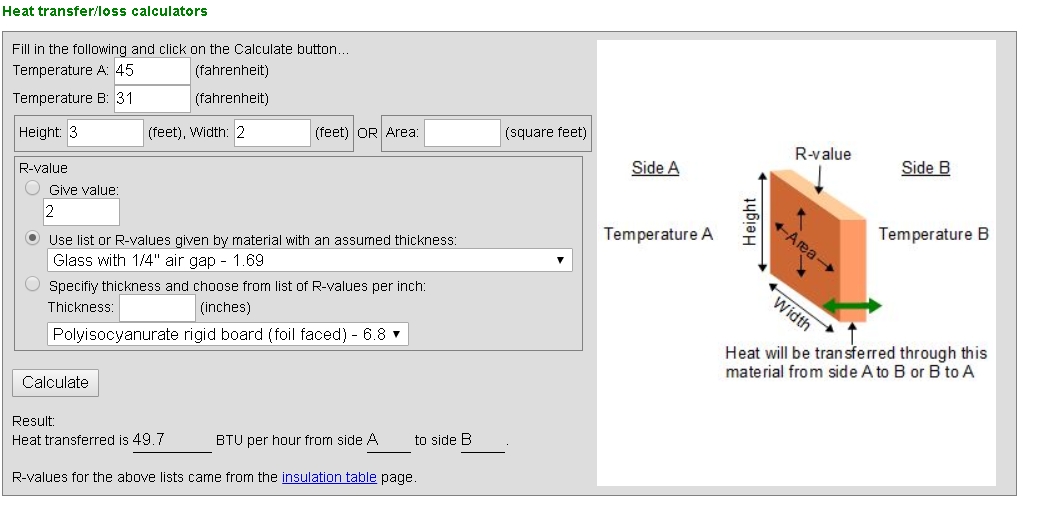

We keep stock waters thawed with 60 - 70 watt light bulbs, but the area being heated is only 1 to 1 1/2 ft by 2 to 4 ft and 2 ft high so just a few cubic feet 4 to 8 with no
drafts or air infiltration. A lot of well houses are only 6 x 6 or so with flat or single slope roofs and many of those are 80% below grade. If your tank is in a corner and your heater is also,
where is your interior temperature sensor? There can be considerable temperature stratification in a room that size, even at 45 degrees I would not be surprised to see a 5 to 8 degree difference in temp in that room depending on location. Good luck keeping your water flowing this winter.
That looks like a good calculator, handy to have
