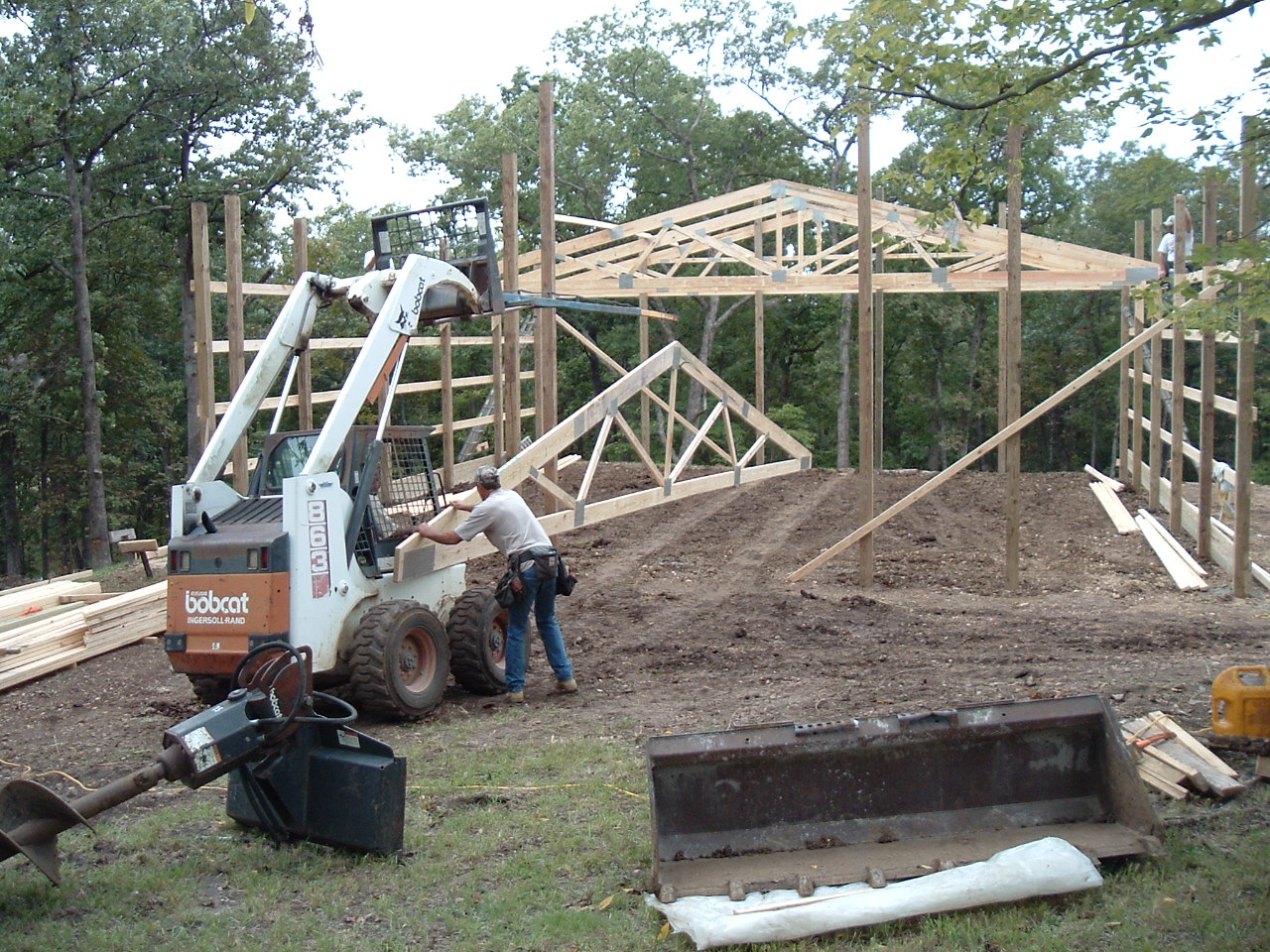

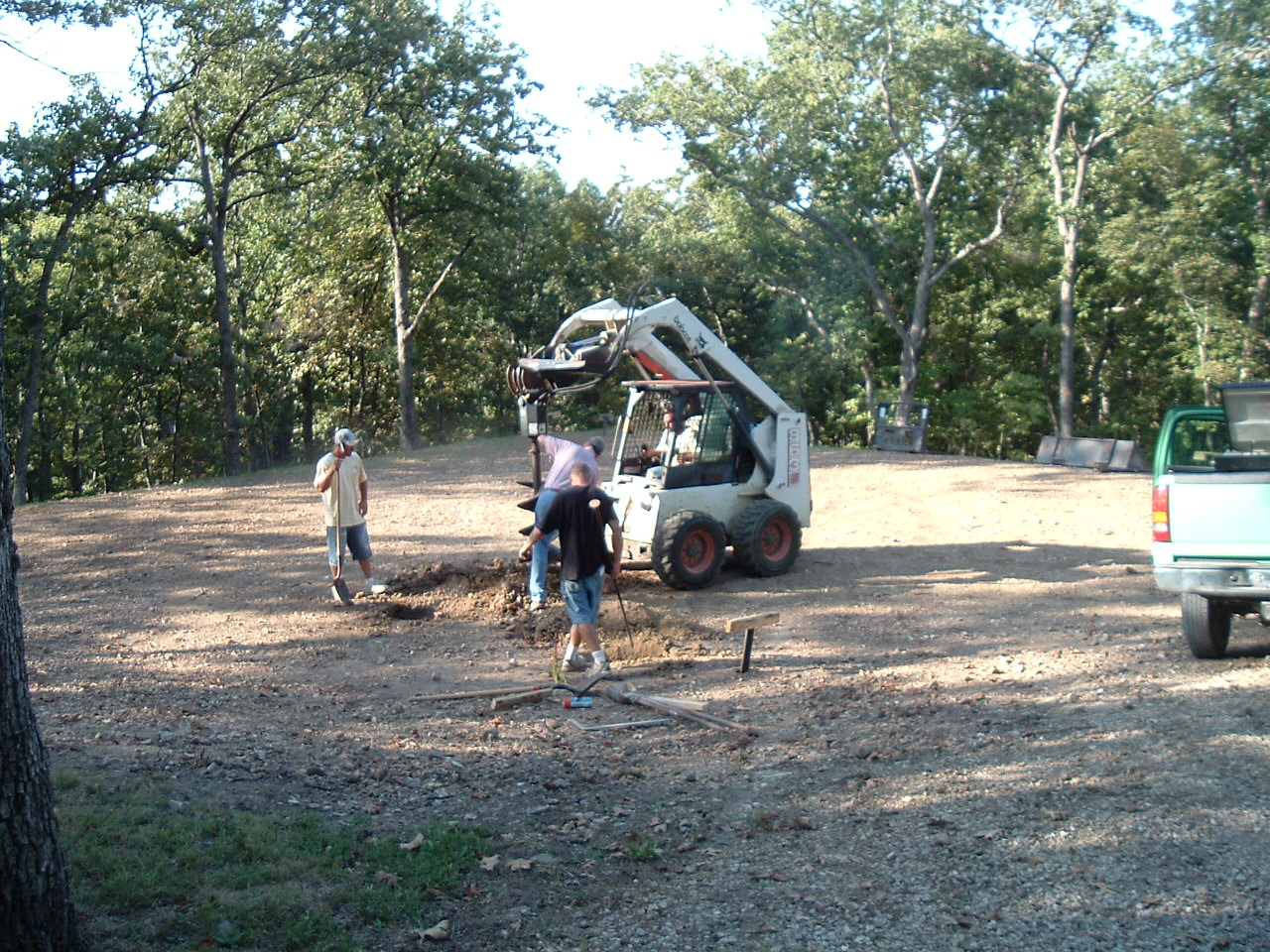

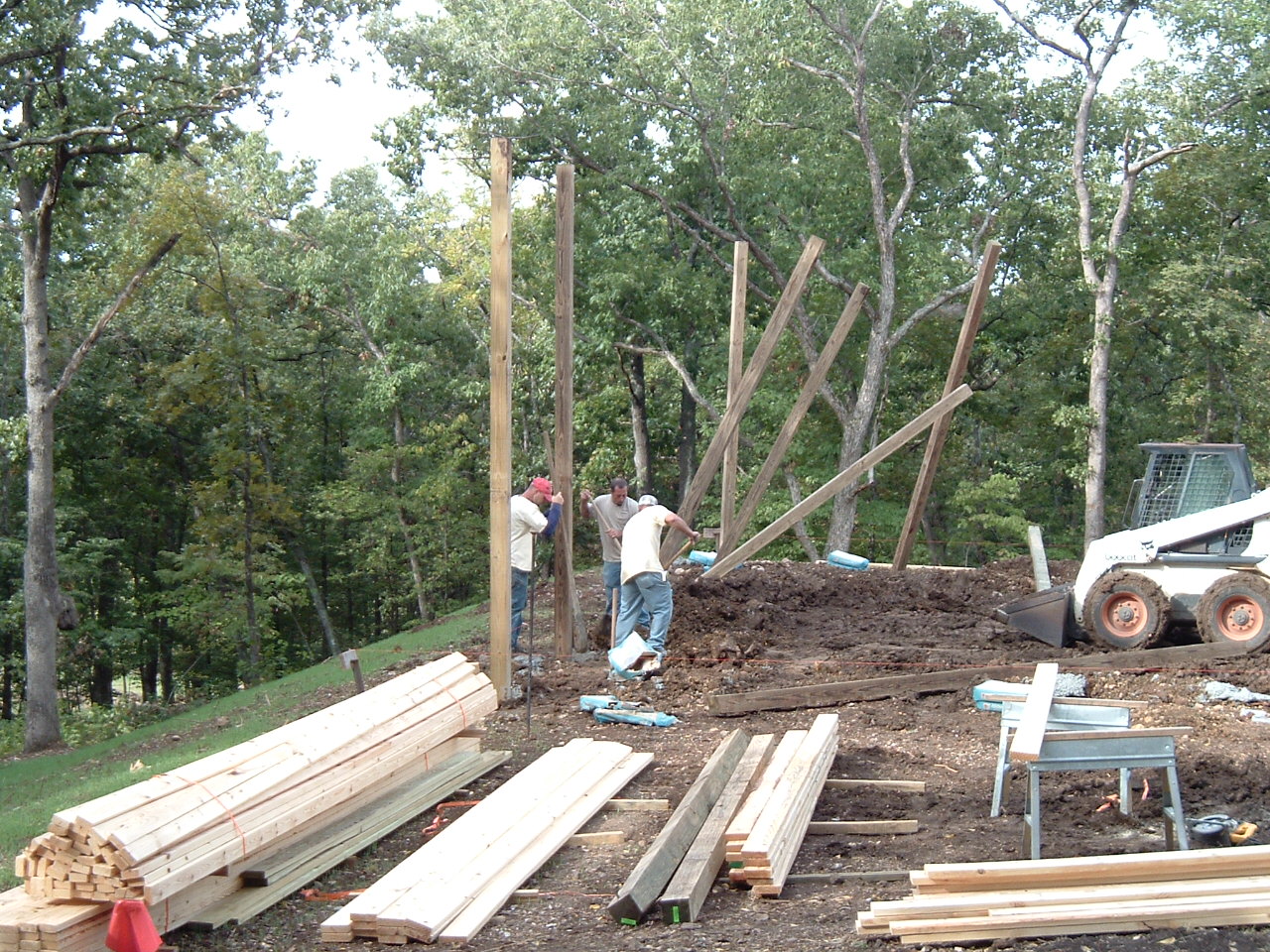

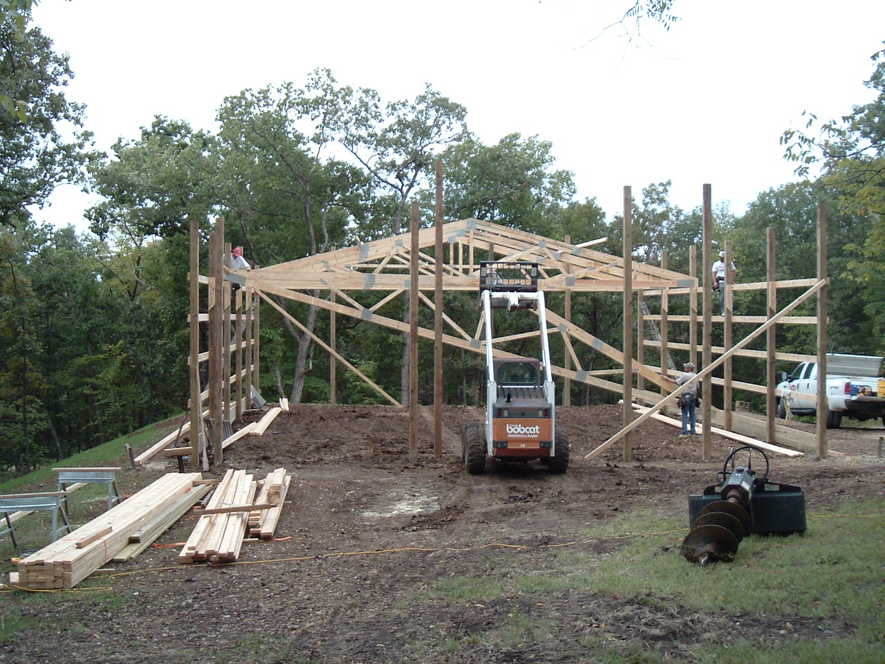

The start of the building work, drilling holes, setting poles and erecting the big trusses

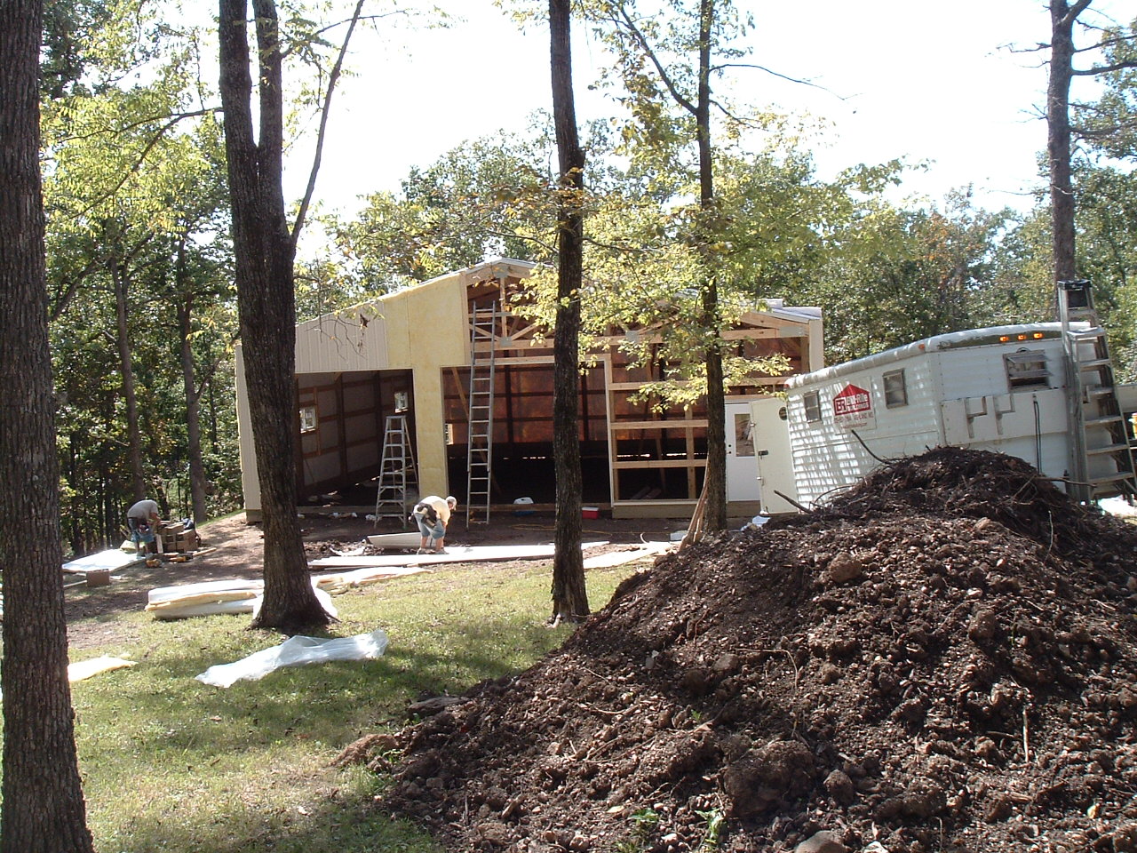

#32

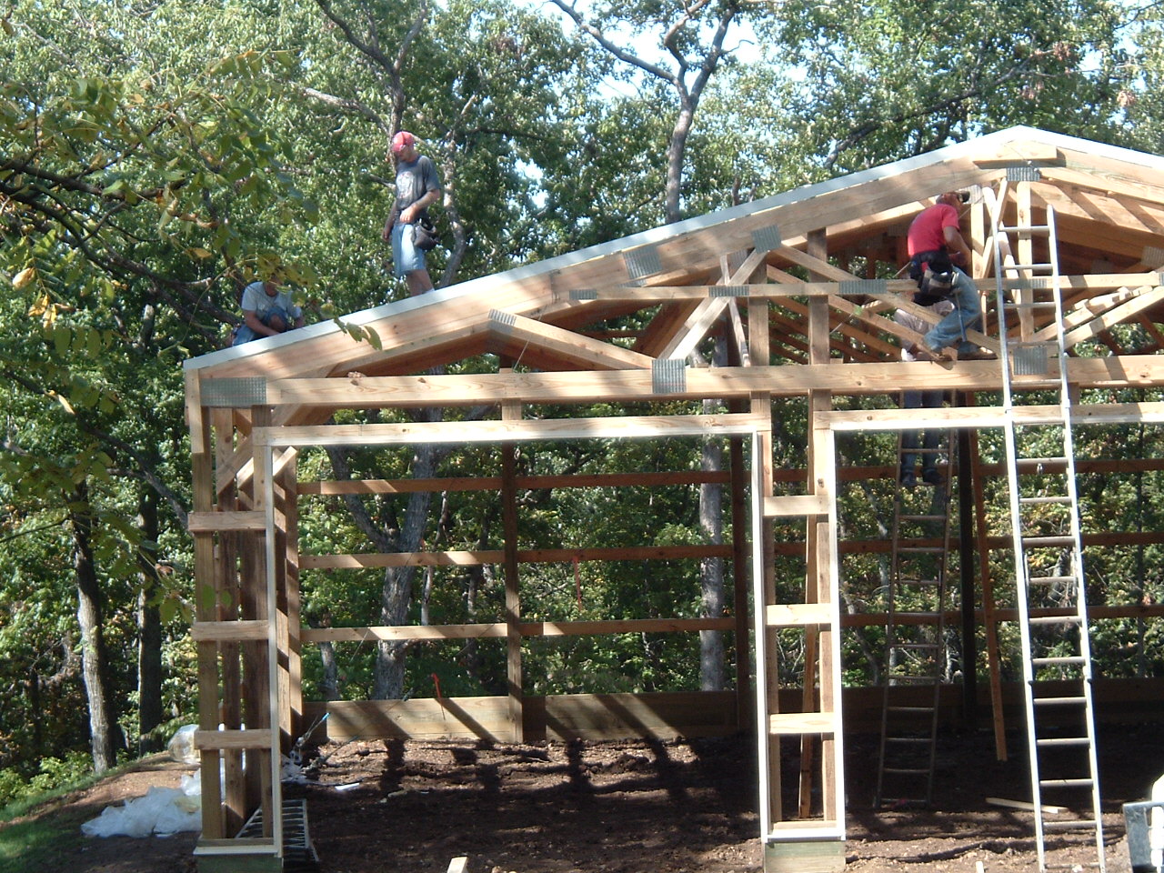

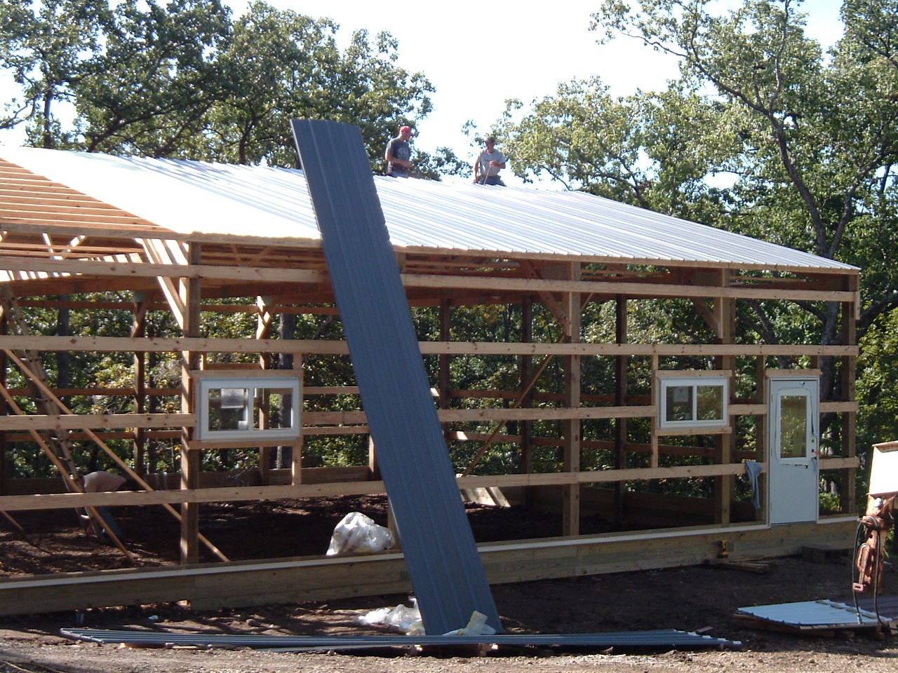

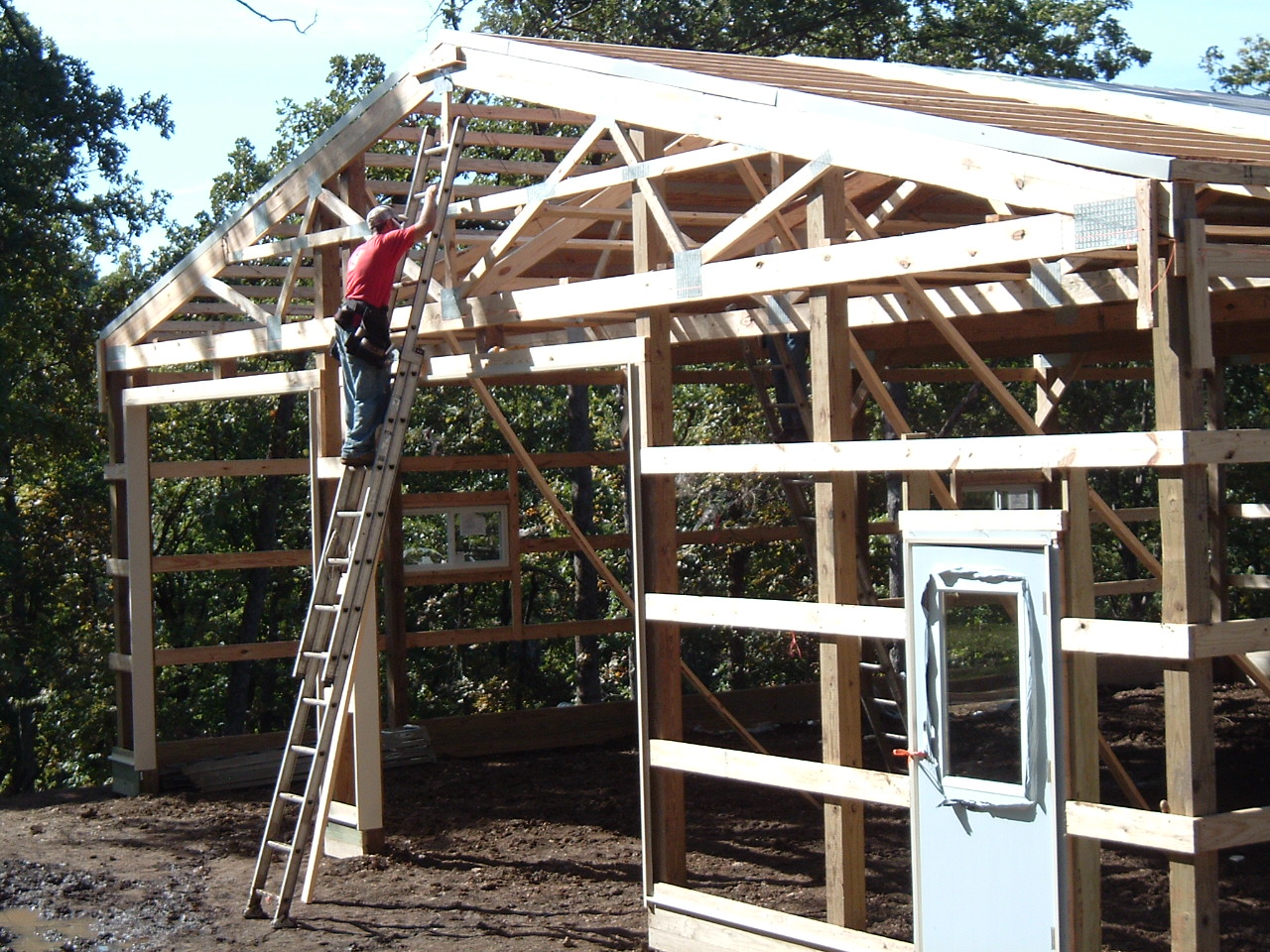

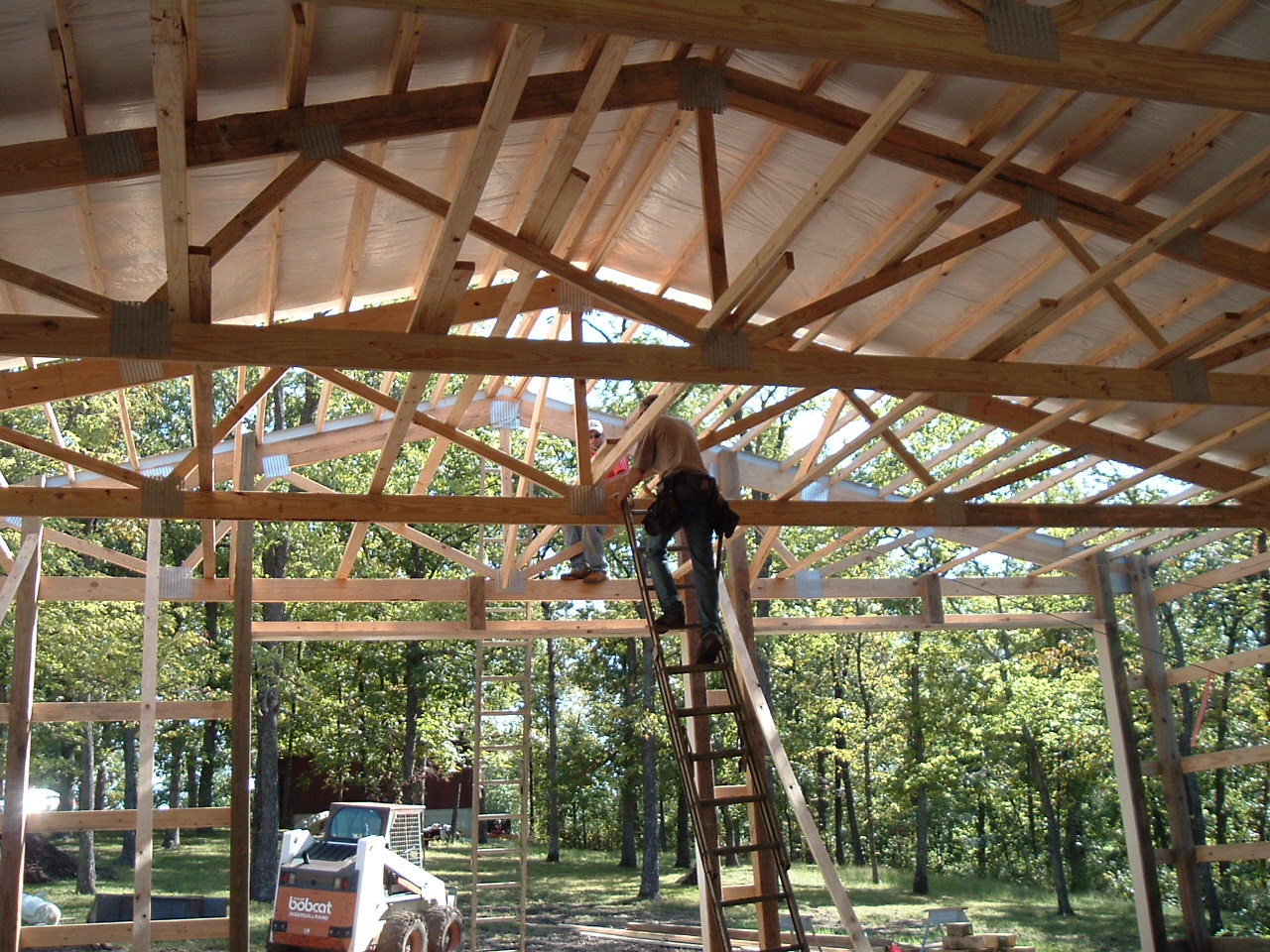

Rough framing exterior door and window openings, starting the roof panel installation and a peek inside looking up

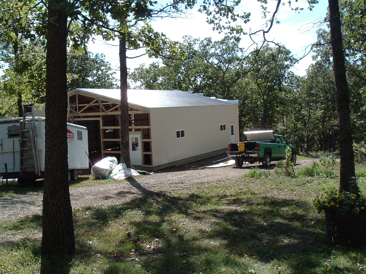

#35

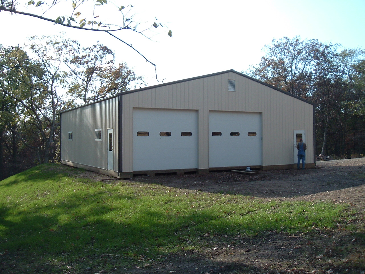

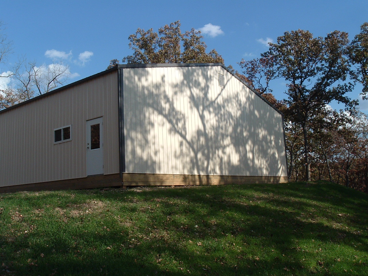

pretty much done on the outside except for final grading, seeding and connection of downspouts to UG drainage piping. Also picture of Riptorn, mouser in chief on013.JPG
022.JPG the project

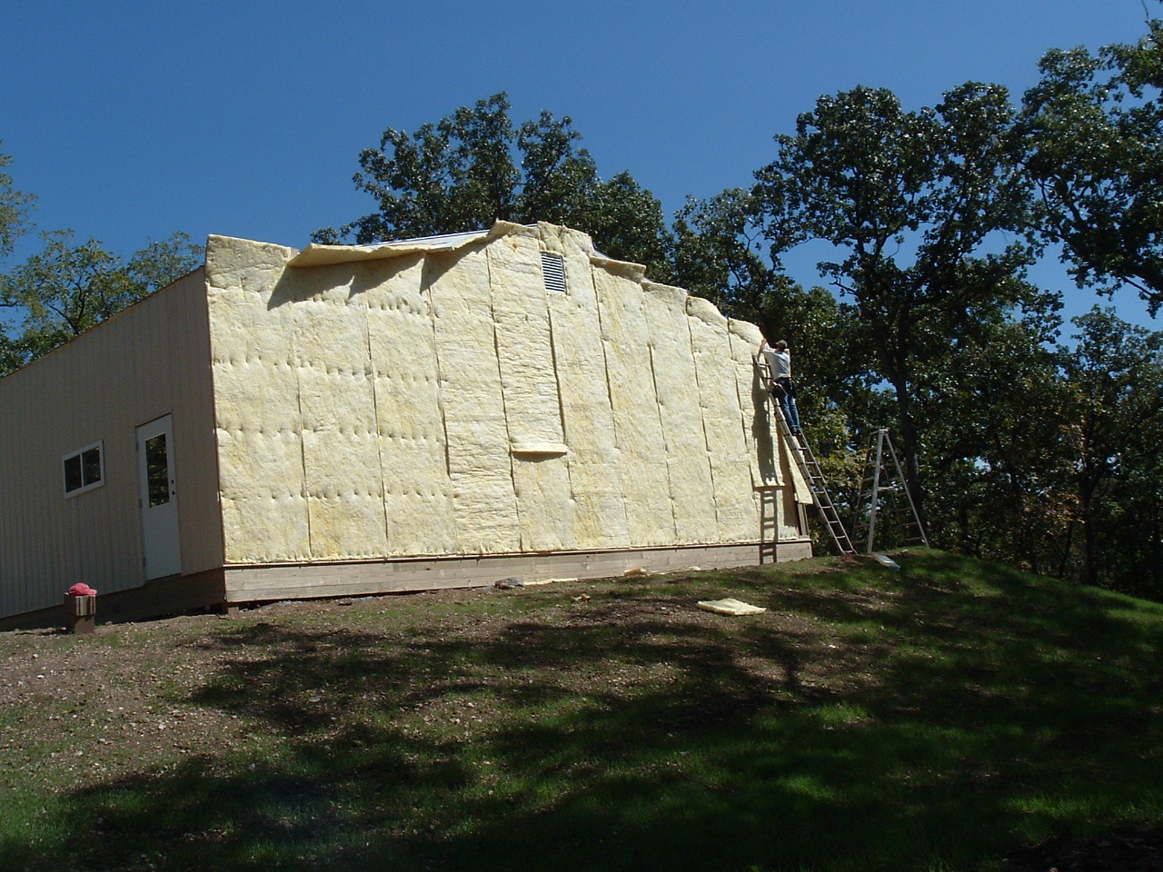

Since the last pictures were taken, I done a lot of the ceiling purlin installation work and have been scrounging for more polyiso foam insulation and lumber materials. I also moved four big piles of lumber into the building last week to begin the wall furring and the finish the remainder of the ceiling purlin work.
I will be taking more progress pictures soon when the sun comes back out.
