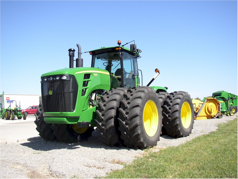

I too have seen those sprayers lined up in rows at a nearby dealership in Kansas. Usually sitting out with these other NON-compact tractors.
