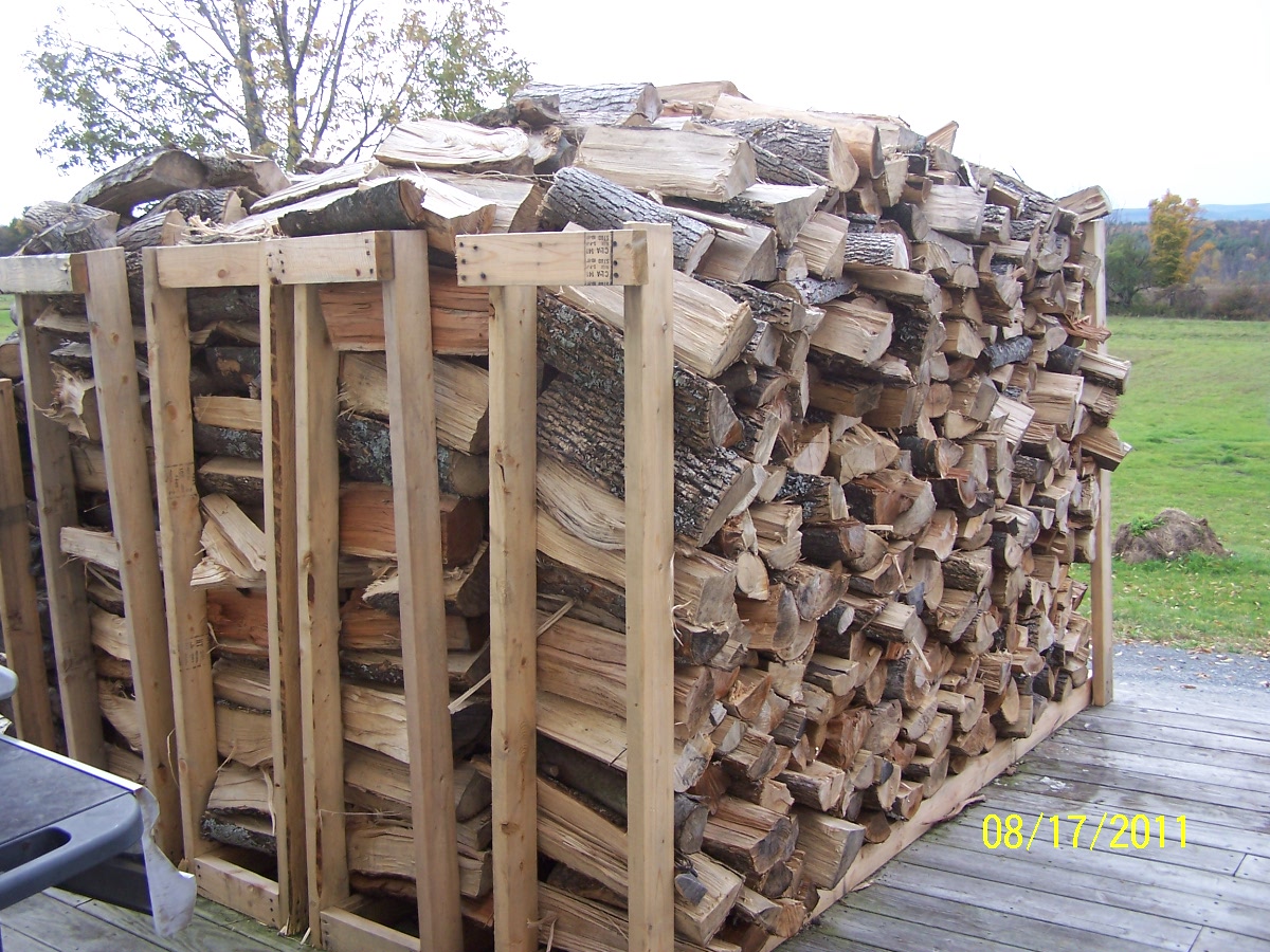

The first year I built some racks and stacked it on the deck and never had to carry it up and down stairs or walk more then 4 feet for
the wood. But did not like that as I like to look out my sliding glass doors on the deck and see what is around did not like it spoiling
my views.

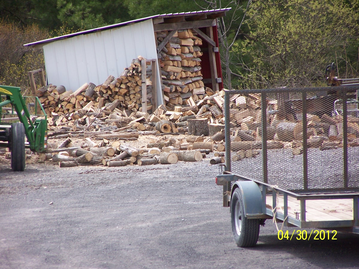

The second year we stacked it on the ground and in a shed we built out of left over materials, the metal was all different
colors but if you turn it white facing out it all looks white from outside. I used my racks that I built the previous year to
keep wood off the ground when it is not in the shed.

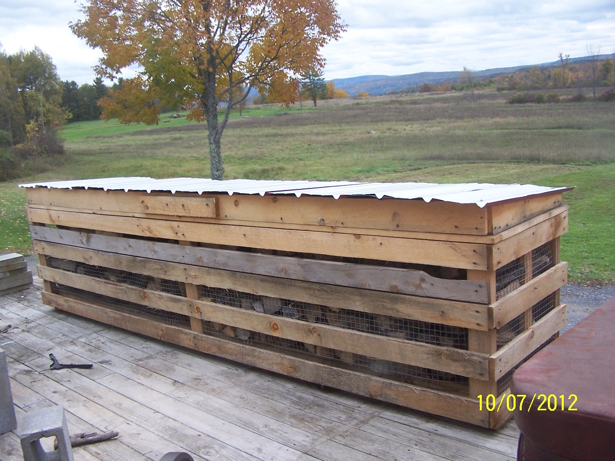

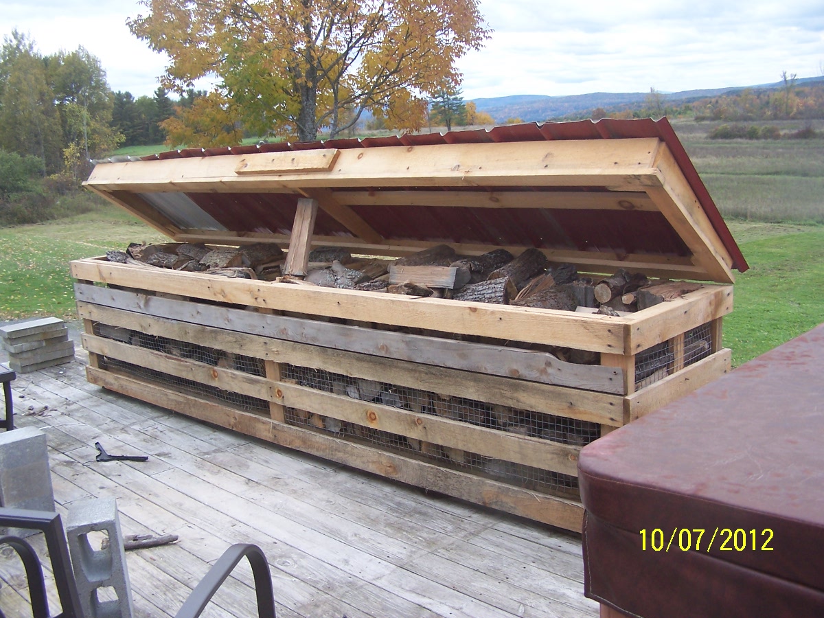

Last year I decided to make wood boxes I can lift with forks of my tractor. We made boxes with rough cut lumber and
old metal and wire left over from my pens. The wood does not completely go around the base the wire keeps the wood
in and the wind can blow throw and metal roof keeps snow and rain off wood. They have a hinged top and the snow and
rain slides off as the top is pitched. We made two of the these one is 10 foot and the other is 12 food. They are three feet
high two foot wide. My deck has no railing so I lift right on the side of deck and have more than enough wood for a few weeks.
I also keep the other box full read to go. So once I finish with one I replace with a full one and once I get the time I fill
the empty one and get it ready. I do not like to handle the wood that much.
