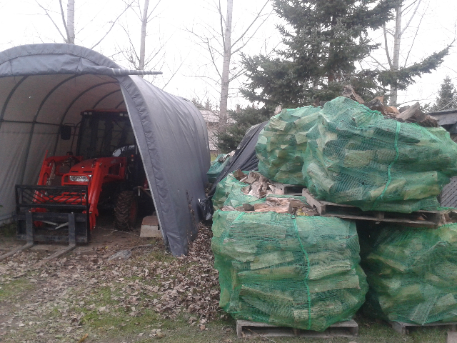

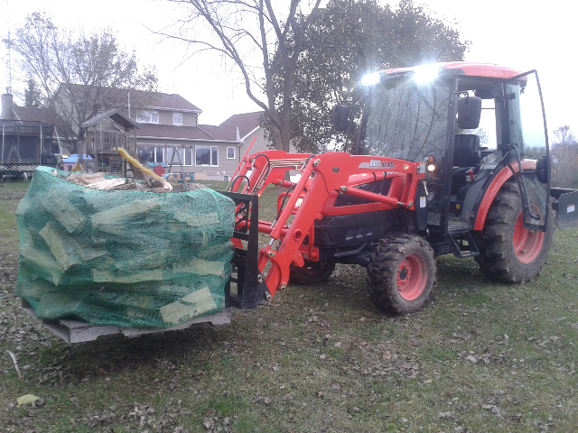

Here's what I use. I built a frame that holds the bag open around a pallet and the wood goes straight from the splitter to the bag. It has reduced the number of times I have to handle each piece of wood by about 4. I have another pallet with large caster wheeles on my deck so I can place a pallet of wood on it and roll it up tight to the house. Each bag has almost one face cord and weights about 2000 with wet hard wood. I've been able to reuse about 75% of them and they cost about $2 each. I'm now converting my wood shed to storage, I'll never handle wood any other way.

Almost exactly one face cord or 1/3 of a cord.

Are you saying you can move 1/4 of a cord with your BX2360? Your L4240 is comparable to my DK45 so I know it could handle the 1/3 cord bags that I'm using, but it's getting pretty close to the lifting limits. Even with my 74" blower on the back (about 1500lbs) and loaded tires, my tractor feels a little light in the back trying to move them.

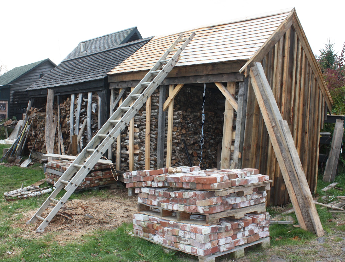

My wood shed(s) keep getting added to... I can now hold around 13 full cords. I also separate the hardwood from the softwood. You can note on the new section, to right of top of ladder, a difference in colour (on the cedar shakes)compared to the left side of the ladder. I have been, over the years, experimenting with an oil(recycled) recipe that I spray on the buildings. The two buildings in the background plus the older section of the wood shed have been treated with this oil. The building with the chimney has to have another application on the cedar roof soon. I use used deep fryer oil(2/3) plus some kerosene(1/3) as a thinner. I strain the fryer oil to remove debris, add the kero, mix and strain again before putting in a pump sprayer. I spray on windless and slightly warm days. And there is no smell from this formula.
The oil darkens down the wood - see clapboard on farthest building - while preserving it. Years ago, up here, you could get red fish oil from the local fish plants - this was a by-product for them but all of the locals used it to "paint" their buildings. They also used the fish oil as a base and added pigments(powder) from the local co-op stores to add colour. I am basically trying to duplicate this process. The building with the green roof needs to be re-shingled next spring- this will be a change to change over to cedar shakes.
PS: bricks are from a very old building - hand made. Anyone in NS who has a historic reno and needs some I can give you a good price on them... approximately 1000.
