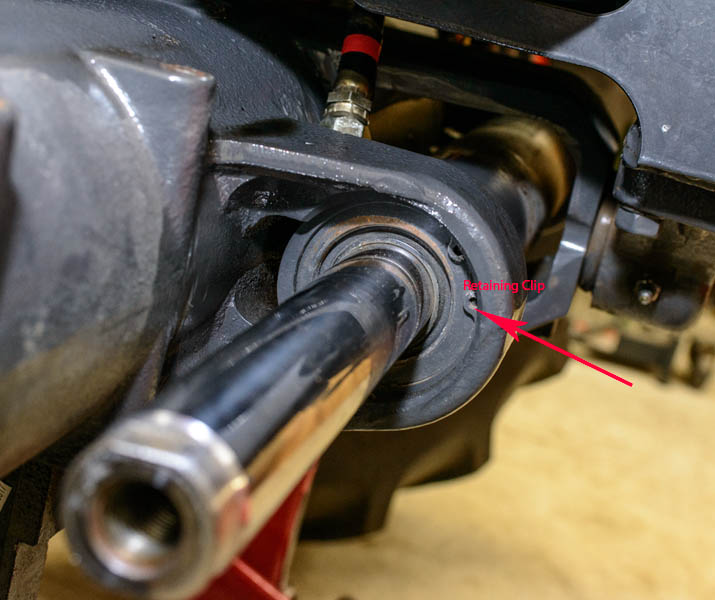

I am in the process of removing the steering cylinder on my Kubota L5030 for repair. I am in need of a good internal retaining ring tool. The one I have, which is one from Harbor Freight will not compress the ring enough to remove it. Any recommendations for a tool that will work? I think the retaining clip will accept around a .126 tip. I just don't want to keep trying with inadequate tools and maybe damaging the clip. Then I would be in a serious bind.
The retaining clip I am attempting to remove is the one that secures the steering cylinder into the axle housing rings that the cylinder slides into.

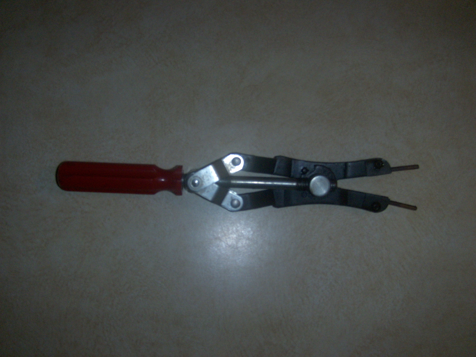

   / Internal Retaining Ring Tool #7
I've had good luck with this style tool.

I will be checking the local NAPA store as well as a few other stores today. The snap ring I am removing is pretty stiff and set into a deep slot so it has to be compressed completely to be removed. This is a picture of the ring….
