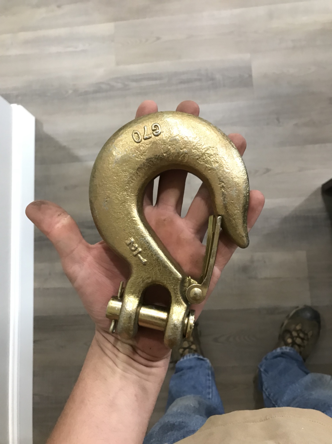

I bought some more chains and binders. I got everything in the picture for under 270 shipped to my door all grade 70 chain and hooks. I didn’t realize how big a 1/2 slip hook is. I should have bought 3/8 slip hooks but for a dollar more I was thinking bigger is better. IMG_0431.JPGIMG_0432.JPG
