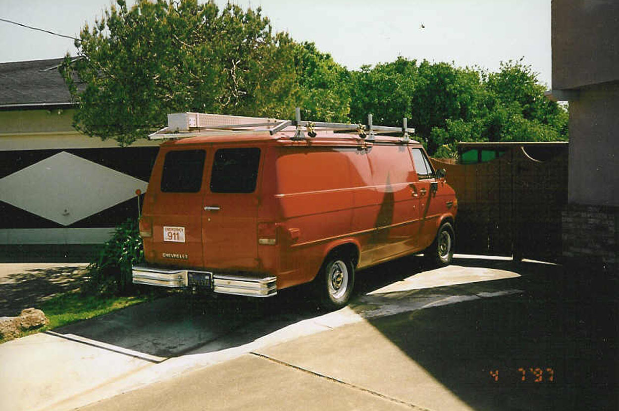

Your use sounds very similar to mine. When I built my service truck back in 1998 I put a Miller Trailblazer gas welder on it with an Ingersoll Rand T30 compressor. I also had an 800w inverter with three group 29 deep cycle batteries and mounted a 30 amp charger with 120v plug mounted in the side of the body. Pull in the carport when I got home and plugged in the cord to charge over night. This powered a small fridge and provided power for a laser printer/fax/copier, Compaq computer and credit card machine. For that time having the ability to have internet and fax line in the truck with a separate cell phone was pretty slick. I could print a proposal while sitting in the customers driveway and hand it to them before I left the site. That really helped my business a lot. But I found the welder to be so loud that it made it difficult to hear the Marco sewer machine cable when turning in the pipes. So about 2003 I removed the welder and bought an Onan quiet diesel generator which made it easy to hear the cable in the pipe. On a couple of occasions I did use the Honda 2000 to run the sewer machines which worked very well.
Retired from the plumbing business I just traded the sewer machines for new tool boxes I need for my other service truck. Put the Onan on this truck and will put the welder and air compressor on a "welding trailer" easy to grab if I need them for a field repair. At one time I had over thirty batteries to keep up with in the various vehicles. Thankfully I am down to about ten now. Hopefully I learned something about generators and batteries in mobile applications, QUIET generators come to mind.
/ Inverter question #51
The older I get the more I appreciate quiet and willing to pay for it...
I do service work for the Hospital and manage rentals... I think my truck got me the Hospital Job... it looked really good back then!
Mounted a Microwave in the truck at the same time as the inverter... also carry small Oxyacetylene bottles too...
I bought my cable from the welding shop... top quality and worth the price to me... didn't skimp on gauge but there was not a lot to buy... everything "Plumbed" with insulators and protection from exposure, chaffing, etc...
Took this picture when the truck was 10 years old...
As far as mounting the inverter... one is mounted upside down and the smaller portable one is mounted vertical... 26 years and no issues.
Nice truck and looks well cared for.:thumbsup:
