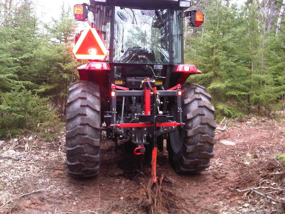

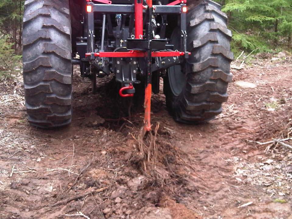

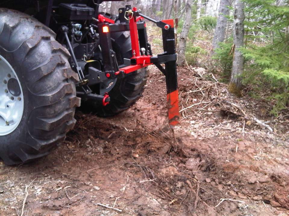

I built my subsoiler from a grader blade, works great opening up the ground and at flipping boulders out and cutting tree small roots away from my septic bed.
Click on Utube for farms running subsoilers in their fields, cheap way to see them in action .
/ Is a Subsoiler worth it? #3
here is how it turned out doesn't tear the ground up too awful bad.

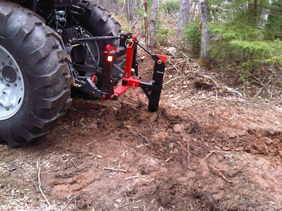

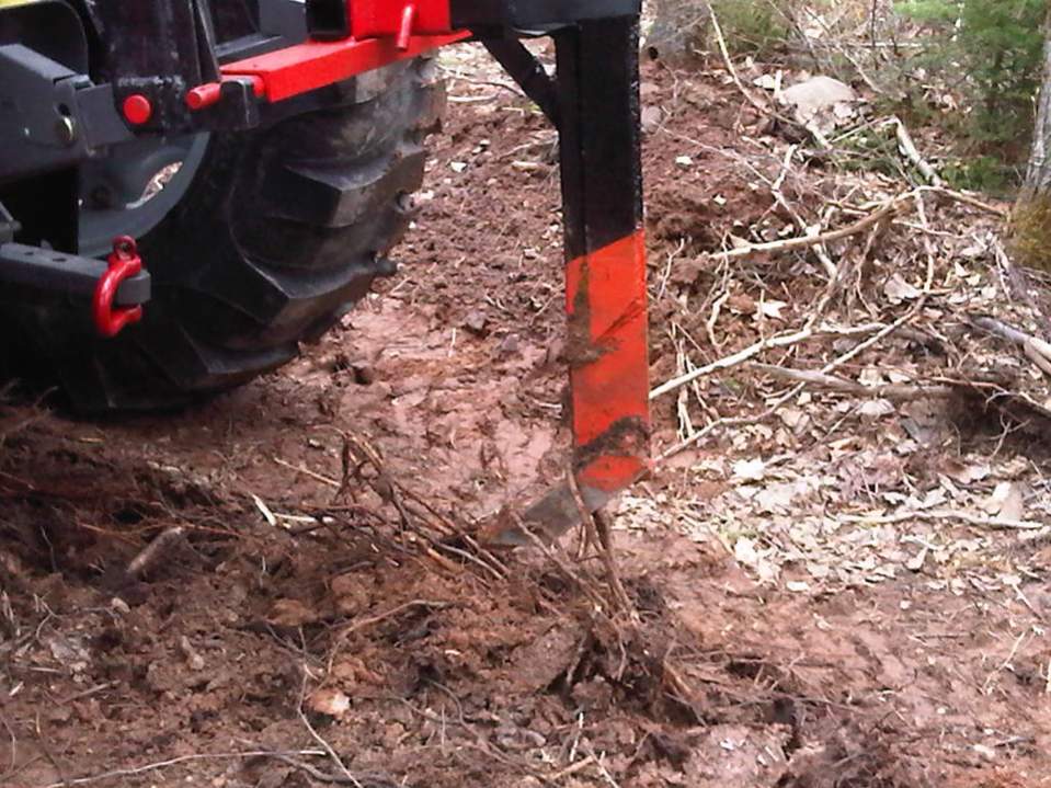

/ Is a Subsoiler worth it? #4
this pic just shows how deep it can go, it is sharpen to slice better as well.
