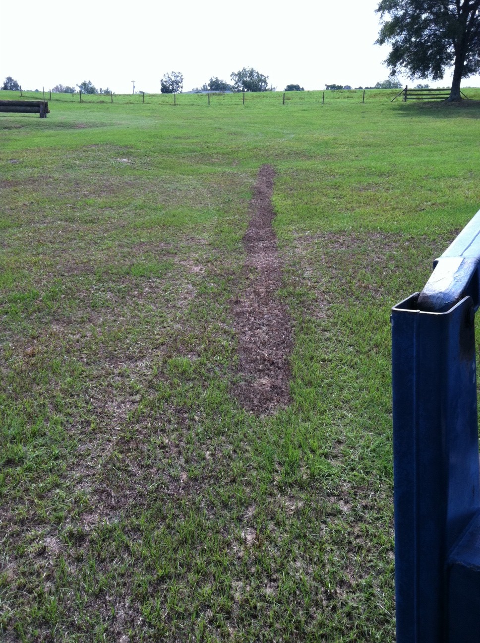

Here is a streak where I ran my subsoiler during the drought to try to cut a pvc water pipe I couldn't locate. Didn't find the pipe but it put a hurtin' on the grass. It ran about 15 inches deep.
