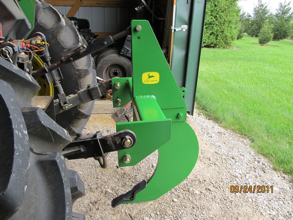

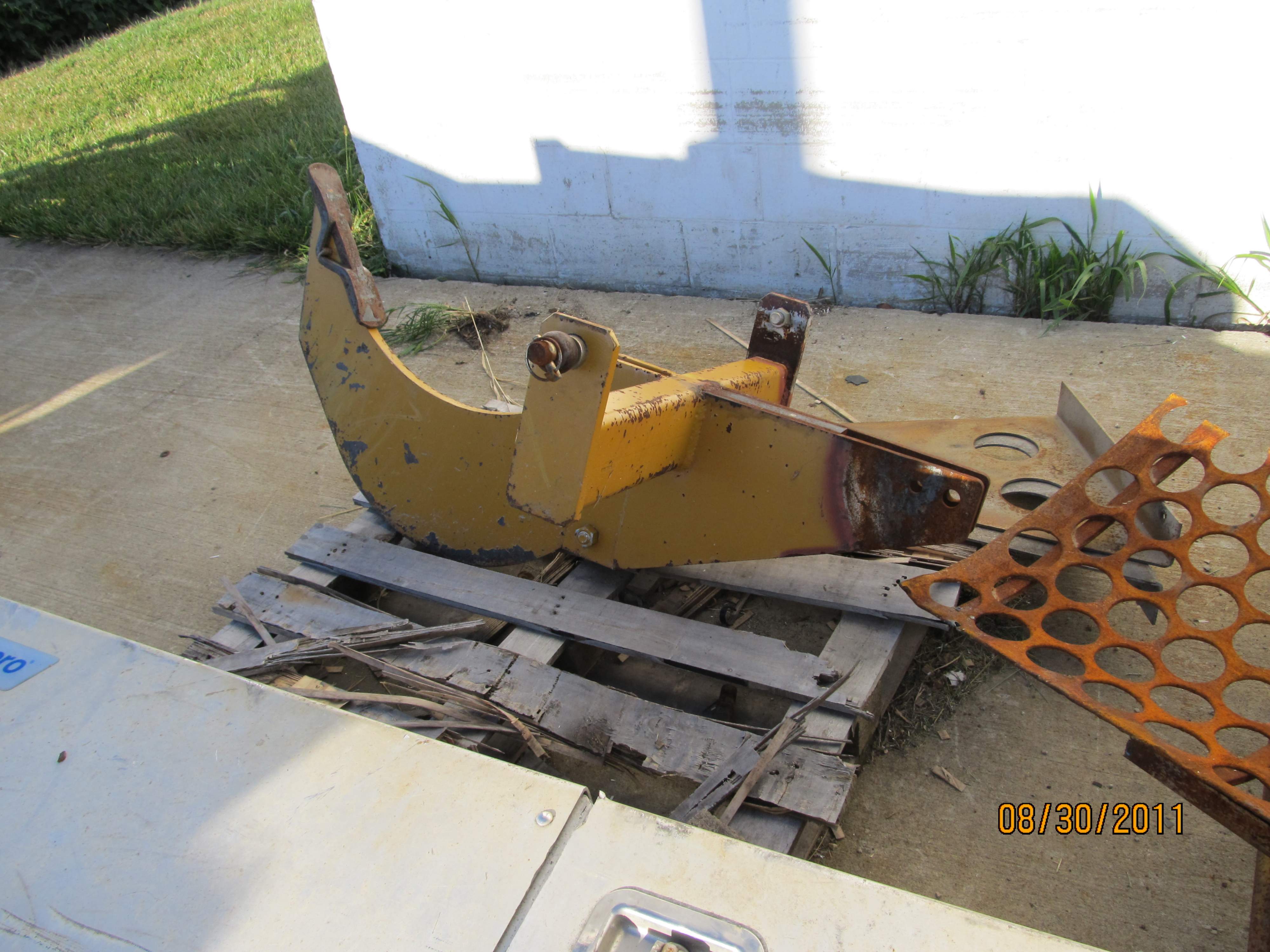

Here is a before and after photo of a single shank subsoiler I recently bought and rehabbed. Brand is actually unknown but green sells better when my time is up. I had different end caps welded to the drawbar with both cat I and II pins so I can also do gardens with my Kubota L4300DT cat I.
It weighs around 235 lbs and rips effortlessly. This is one of my best finds ever. I did a separate thread on this recently. FYI.
