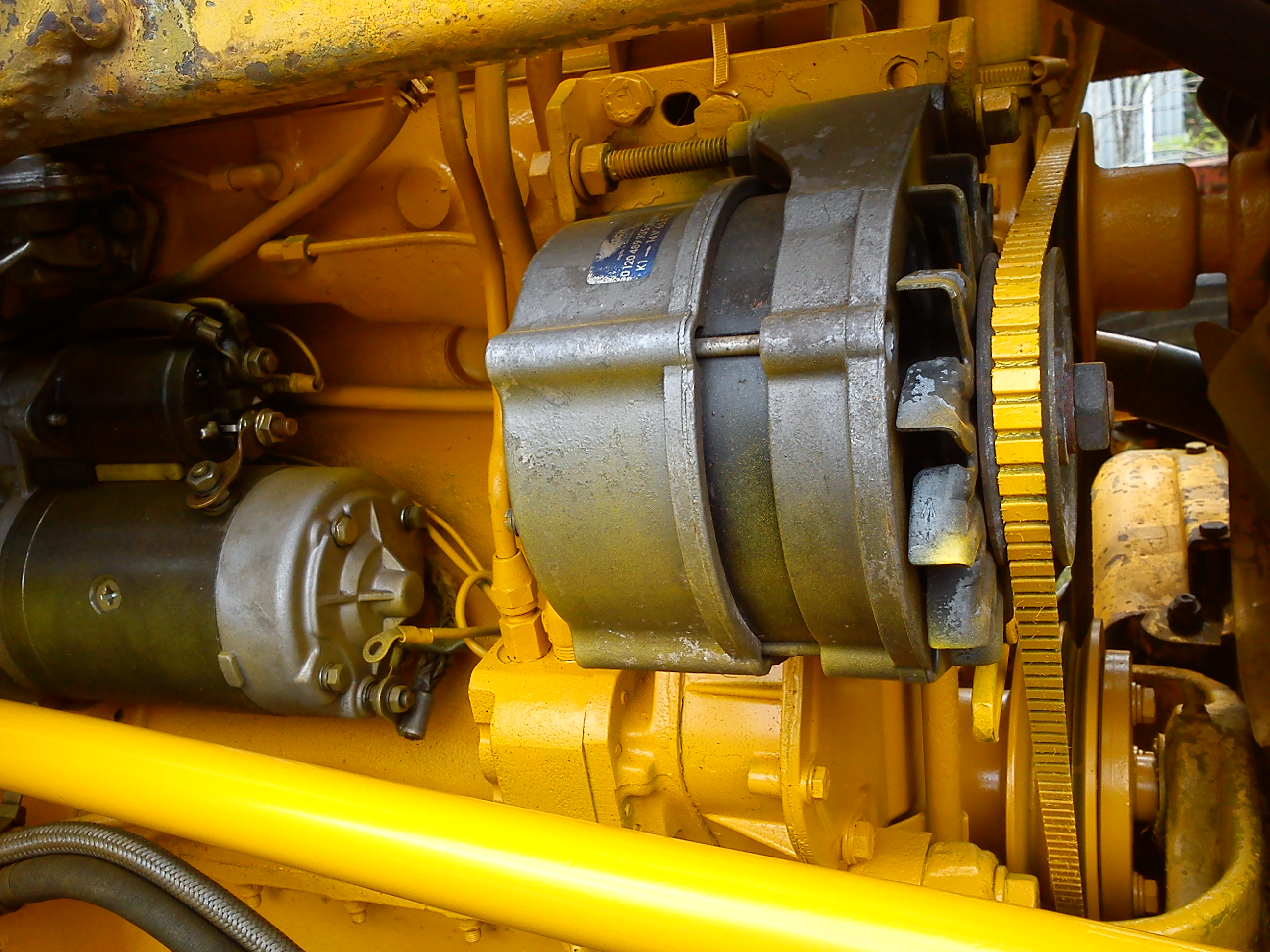

Generator: - Almost none of them work anymore, although the regulator is more likely to be the culprit (including mine, until I gave it a stern talking-to, now it puts out only about 8 amps) so a periodic charge for the battery is the most cost-effective remedy. You can still buy complete generators and various parts for them and regulators are also available from Bepco agents and others. An older and more experienced auto-electrician should be capable of repairing them, almost anyone can retro-fit an alternator to it - including me to our MF40 loader - a huge improvement! Here's a pic so you can mount it properly:
Look closely at the upper mounting plate - to mount a garden-variety Bosch alternator, redrill the holes to bolt it to the timing case so the pulleys line up, and you don't have to grind any of the mount away to accommodate the alternator. A piece of threaded bar, a couple of nuts and washers, the original belt and adjuster strap - all fitted. The wiring requires a bit more know-how. Let me know if you want better pics or info. Sounds like it's time for a cool :drink: We're now getting into some real summer temperatures!

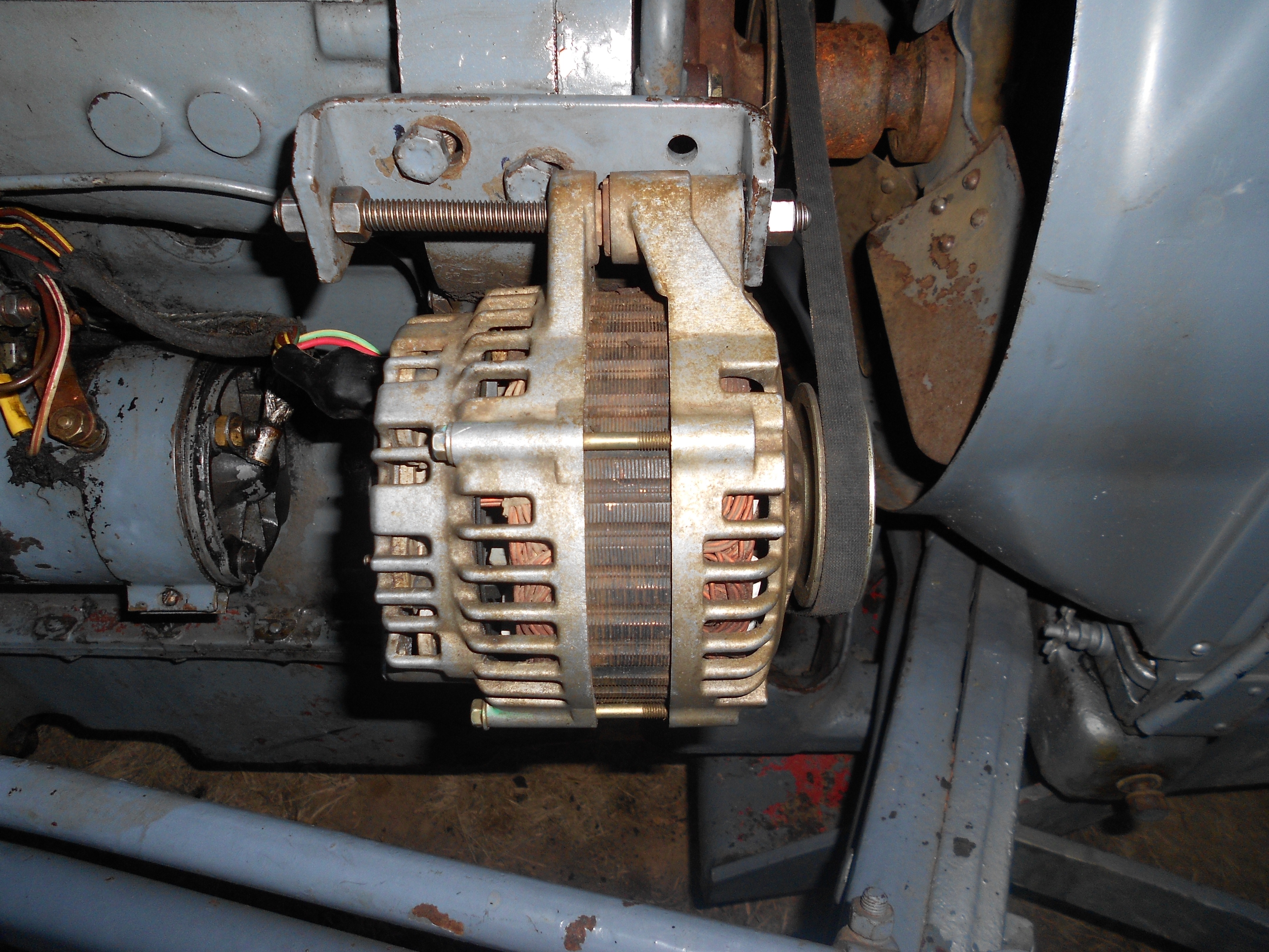

Mate, that's funny, Here's my solution for mounting the Alternator, Look Familiar?

Had a good day yesterday, The HooDoo has lifted, Hooray!!! Replaced all the Gauges and rewired all the lights and they all worked first time!
and yes my sender still work fine (.5 ohms empty - 32 ohms Full).
Then rebuilt the Fuel lift pump, straight forward, doesn't leak anymore!
