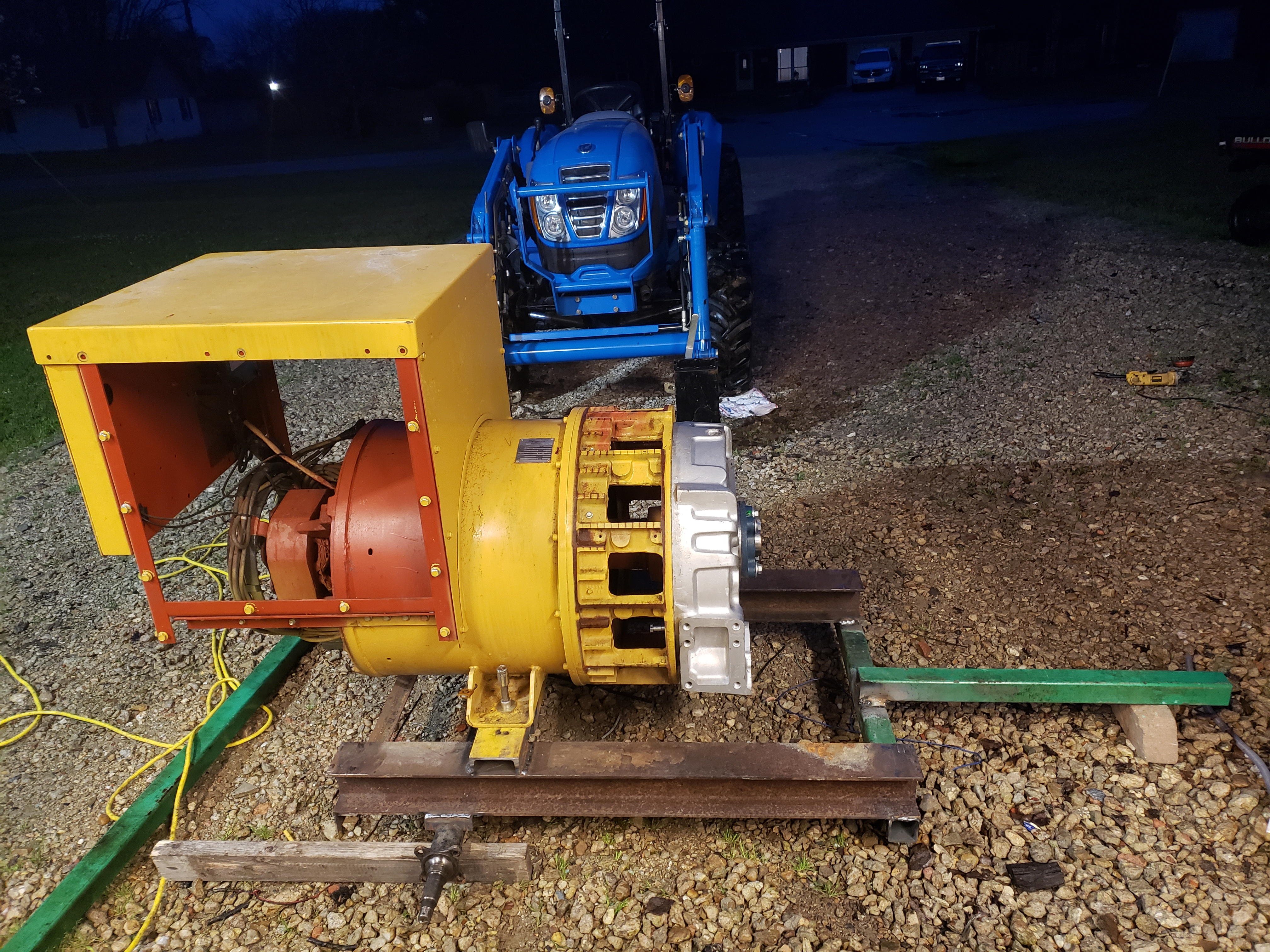

I'm planning for the grow house scenario. After the power came back I measured the amp draw on the house with the heater on, 77A. Septic and well were off, but septic pump draws 15A and well pump draws 12A. There's a very good possibility that both those pumps will be running at the same time (plus the water heater, ??? Amps) if someone is taking a shower. So I'm figuring 120A real-world, maybe not even worst case. That's 28kW (38HP). My 40HP tractor might not even be able to handle it.
But I suppose I could add a high gear for just in case we lose power during 2-week span of temperate weather on either side of summer.

I'm not too worried about inrush or startup current. My first few words in this thread ("I'm about to get a PTO generator") were oversimplified to the point of being misleading. I already have the generator head and what I'm about to get is a drive train for it. I worded it that way on purpose because I already have a thread here about the generator head and I didn't (don't) want to rehash that whole thread here, which tends to happen every time I bring it up. The generator head is a 225kW (or 275kW? I keep getting it mixed up) caterpillar unit meant to be powered by a 400HP CAT diesel. It probably has enough inertia to drive a locomotive a few yards down the track after rotary power is removed. Getting it up to speed is the bigger concern.
My tractor increases RPM for regen, if I'm below the minimum rpm for regen. It's been a while since I was in that situation so I don't remember if it does so without permission, but I don't think so. I think it will flash dash lights of disapproval at you until raise the rpm so it can regen. But once you've done that and regen has started, it won't let you bring the rpms back down without canceling the regen with some cheat code combination of button presses, which it harshly scolds you about. The regen rpm is around 450-500 PTO rpm I believe? So if I'm running at 540 or higher (I almost always am, and always will be in generator mode) I don't even notice.

Strantor, I'm curious what PTO gen you're thinking about?
I'm rolling my own. It's a project I started a couple of years ago and it got pushed to the back burner. I'm reviving it. I'll be posting more pics to the old build thread soon.
Here's a teaser: 20210314_194703.jpg

Here's a teaser:View attachment 690379
Great Scott! I'll look forward to seeing the details :)
