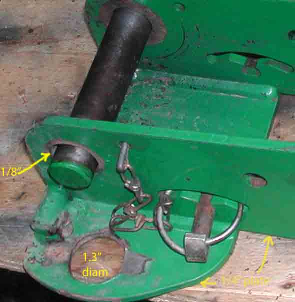

I noticed that all the pivot points are not insert bushed. I am aware that the pins are likely softer in material than the initial bushings themselves, but was surprised to see that the bushings were not replaceable. Is this typical?
None of my loaders had replaceable inner bushings. I am more concerned
about JD's thin 1/4" metal used on their QA brackets. On my 420, they
have gotten so sloppy, a repair is necessary.
Have you considered using new 1" pins, instead of the smaller JD ones? I
assume you are having trouble with the main boom pivot? If one of the
cylinder pivots, an unmodified 1" pin will probably be too tight in the
cross tube.

No, the tractor has just over 200 hours on it, but I couldn't get grease into one of the pivots and took it apart. I was fairly stunned, and was just wondering if it were normal. My mast's do move around a great deal and make noises, and I was trying to figure a way of making them more rigid, like selling the unit and getting something stouter!:D
   / Is my loader is piece of crap? #29
200 hours! Now I'm stunned.
You mean your main boom is loose, correct?
I suspect that the pivot in question never properly took grease, so it has
200 hours of dry operation. :-(

Unless the loader mounts are loose, you're probably seeing normal movement in the loader. Next time you drop your loader off, retorque the mounts and see if that helps.
However, this is a quick attach loader so it's not going to be as stout as a permanently attached loader. You've got to expect some movement.
