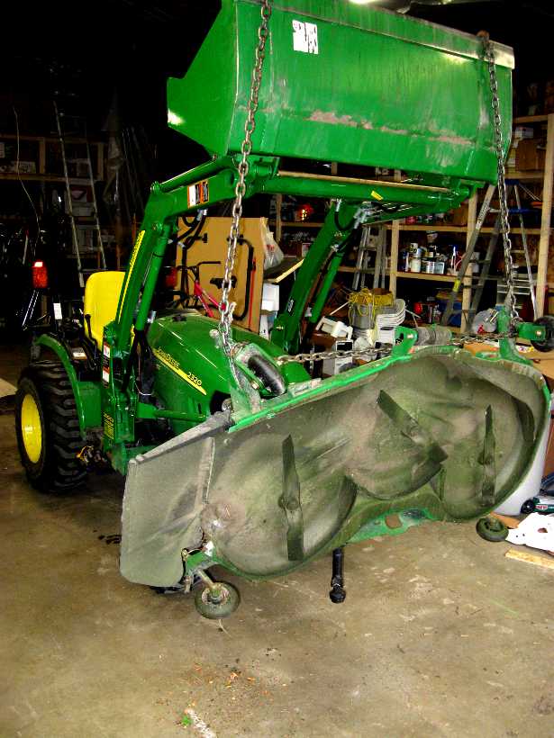

Another thread mentioned this company for casters to stand up the mower deck in order to move it around and take up less space. Some on TBN have built there own. In either case it doesn't look easy getting the deck up on those wheels no matter which way you go.
I think the 62d is quite a bit heavier but maybe once I get it on some wheels cleaning it will be easier.
I have the 62D on a 2320, so I may not be 100% on this, but mine will mow at a height of 6 inches when in the "lock" position. I know the deck level adjustments are different on the 2720, but I thought it would go at least as high.
Are you in 4 wheel drive when re-attaching the deck? There are tabs on the deck for the front tires to "climb" onto the deck. Mine will push the deck if it's in 2wd, but in 4wd it climbs right over, even on slick concrete.

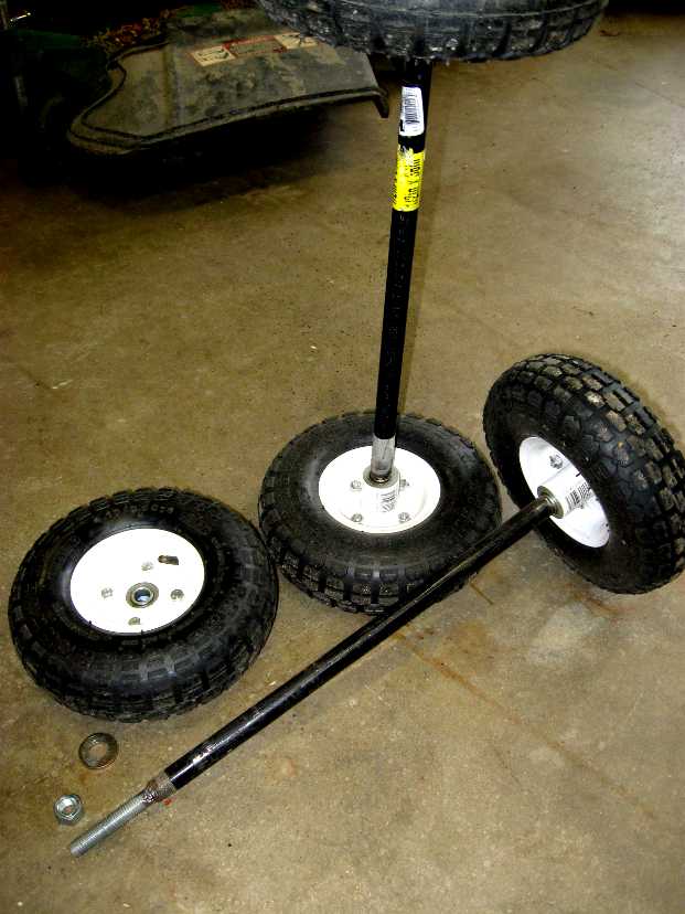

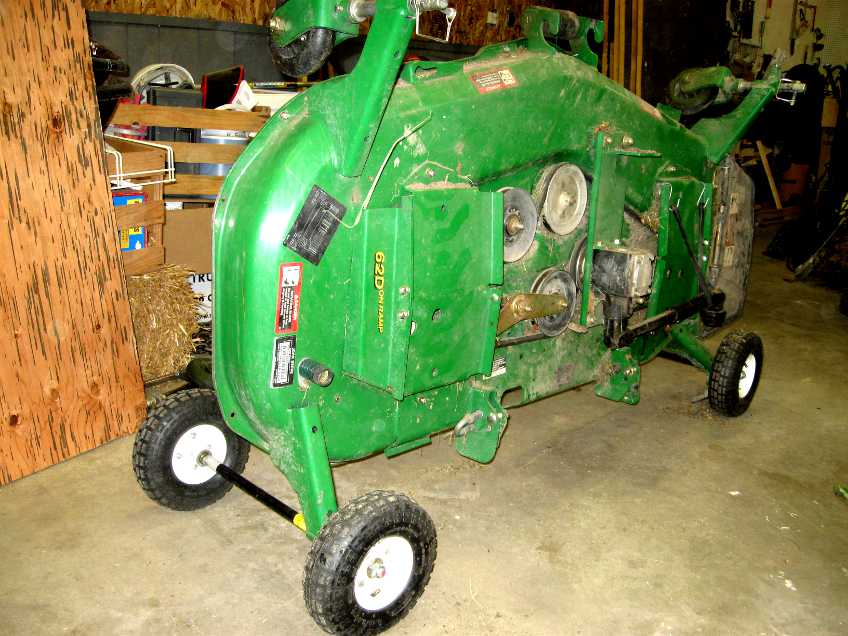

Some people here have said they manually lift the deck up upright. It weighs about 275 lbs so that's possible. I throw a chain around the front wheel shafts and lift it with the loader. Very quick and easy.
Making wheel stands is really easy. 1/2" steel plipe fits close enough into the rear wheel fittings. Use 10" diameter wheels. 8" will work but the locking levers tend to scrape the ground when you move it. Harbor Freight regularly has 10" pneumatic tires (for 5/8" axles) on sale for $5 to $6. The 5/8" axle shaft conveniently is a good fit inside the 1/2" pipe (don't you love our sizing system).

Kenny,
Do you happen to have a photo of your vertical storage setup on the 62D? How long of pipe and axles did you use? I assume you bought four wheels.
Thanks.
   / Is the 62D deck a floating or ground contact deck? #47
Kenny,
Thanks.
I'll try to get a photo this weekend. My axles are about 18" long, but I think a little shorter would be better. Yes, four wheels.
   / Is the 62D deck a floating or ground contact deck? #48

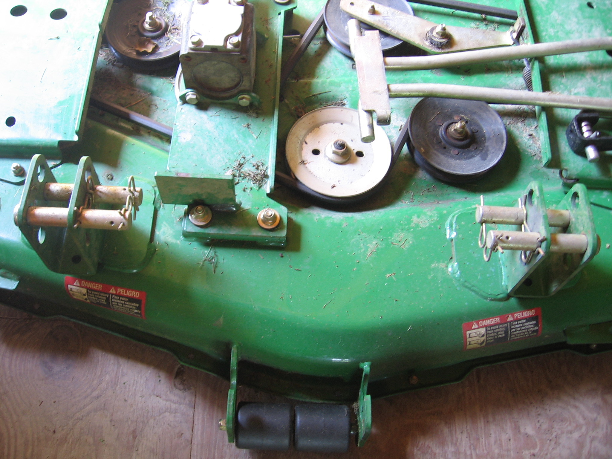

If I get it right, here are some pictures of my wheels. The first picture should be the wheels and axles. Right now, the axles are 1/2" steel pipe, 18" long. I just bought a 3 foot section and cut it in half. In reality, I think 12" would be fine because of the deep hubs on these wheels. I used 5/8" threaded rod (inserted into the pipe and spot welded) and nuts to hold the wheels on but you could use plain rod and cross drill it for a pin. The wheels are 10 inch diameter from Harbor Freight. Technically, 8 inch wheels would work but I think they would be a little tight on ground clearance. The second picture shows the deck lifted with a chain and the loader. The third picture shows the deck up on the wheels.
   / Is the 62D deck a floating or ground contact deck? #49
I made mine as well, but they dont look nearly as nice because im not as handy LOL-
I used 18" threaded bolts (the longest I could find at TSC) that were smaller than the holes in the mower brackets. Im thinking the holes were 7/8" ID, my bolt was 1/2" - then I had used brass inserts that were 3/4" ID x 7/8" OD to fill the gap.. I used PVC pipe as spacers so the offside wheels stayed in position.
I did make the mistake of using 8" wheels and you have to make sure the adjustments levers are folded or they will hit the ground..
Brian
