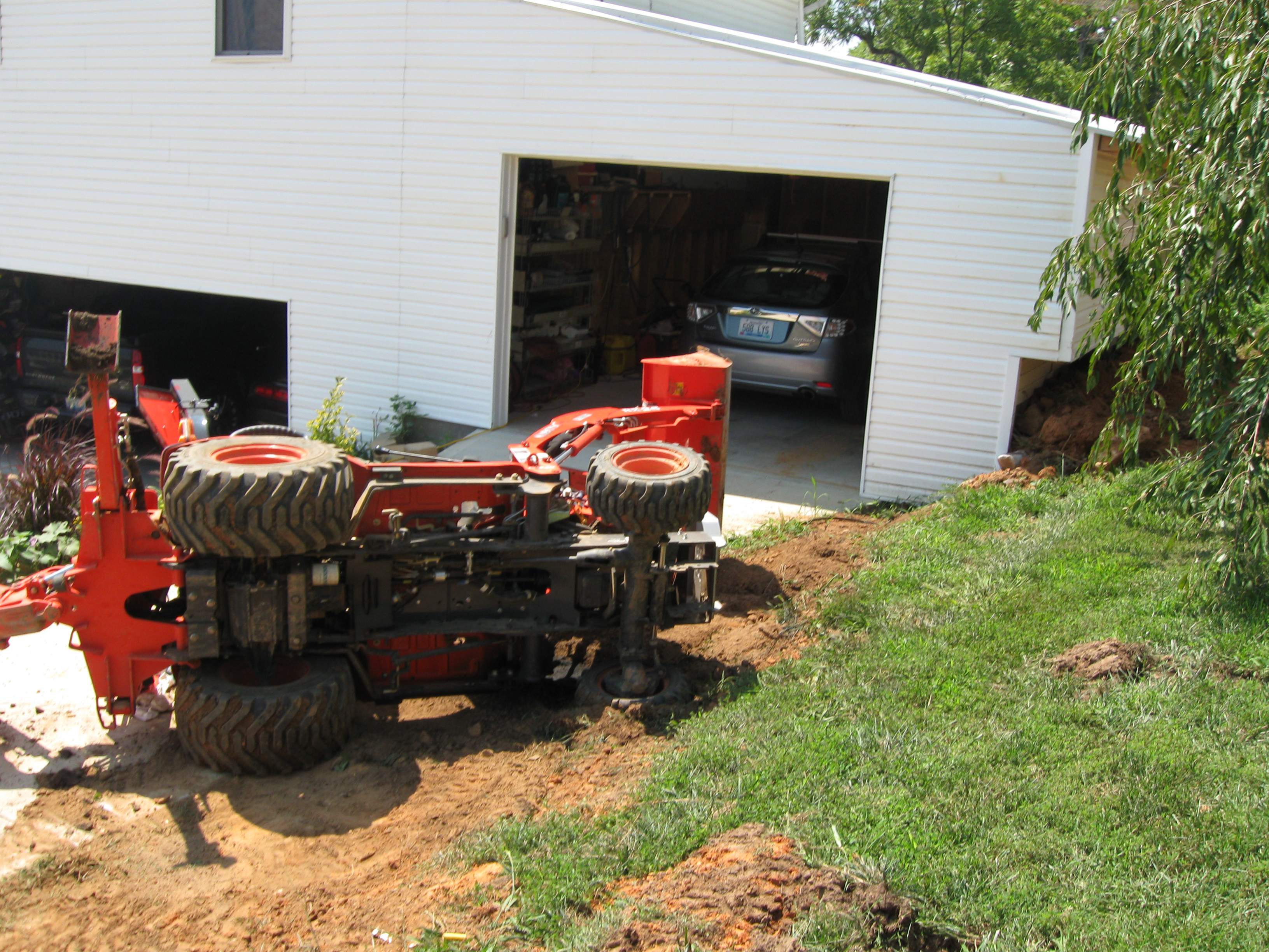

My ROPS is often times catching a tree limb and causing it to smack me in the head but I'd rather have it do that and save me from a crushed head. I always wear seat belts in my cars and trucks and have since 1965.
I was sitting still when this happened, IMG_0994.jpg pushed down on FEL had my seat belt on and within less than a second I was on my side. Maybe ROPS kept it from rolling on over, I don't know.
   / Is the ROPS really needed? #84
I was sitting still when this happened, View attachment 392156 pushed down on FEL had my seat belt on and within less than a second I was on my side. Maybe ROPS kept it from rolling on over, I don't know.
Looks like a good time to change the HST filter.
Setting up side slope like that would do it.
   / Is the ROPS really needed? #85
I also noticed that you didn't have the low side stabilizer down. You likely realize this now, but that should have been the first thing to go down so it levelled up the TLB, then the off side then the FEL bucket last when working on a slope. ON level ground it doesn't much matter, but I usually put down the FEL first because it will level front to rear easily.
I was getting ready to back up while peeling an edge off the bank to level it out which I had done many times over the years so wouldn't have had feet down. Doing it over today I'd lower BH boom/arm all the way down and out and swing it around to uphill side and could even lower the down hill side leg down near the ground for extra safety.
Even better would have been to use the BH to peel off edge while sitting perfectly level on the concrete but again, getting away with something a hundred times gets one to thinking doing it that way is OK.
