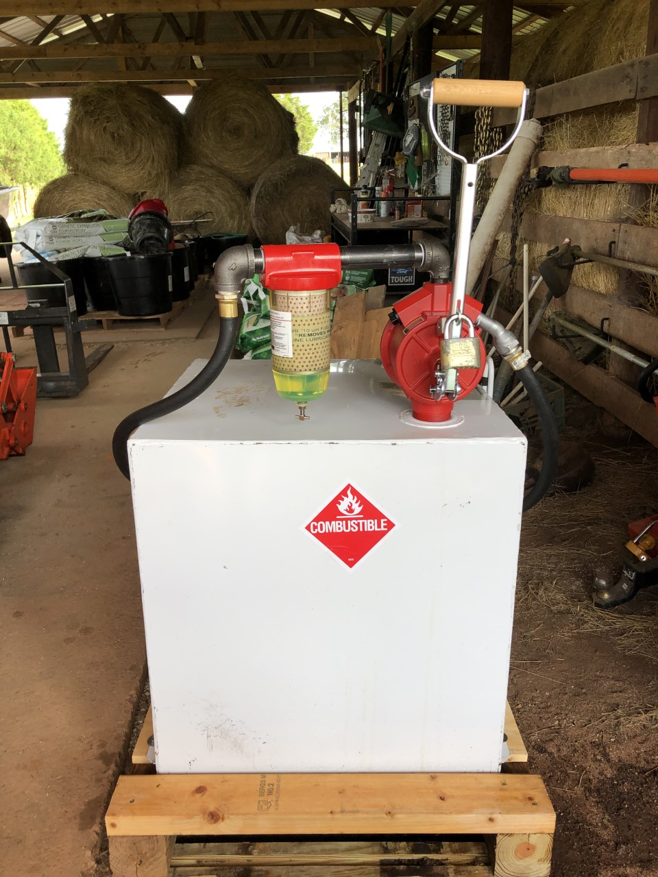

I struggled with the same issue for years. I noticed each year the weight of a 5 gallon diesel fuel can seemed to increase with each refilling of my tractors. I invested in a 50 gallon fuel transfer tank with manual pump and water separator filter. Bought the tank online at Blain's Farm & Feed; pump is Fill-Rite FR152; added Fill-Rite Hydrosorb fuel filter from Grainger along with necessary black pipe fittings. Finally, mounted the completed unit to a skid made from leftover materials in the barn. When the tank needs to filled, I use the forks on the tractor to load the tank in/out of the pickup truck. As you can see, I store the tank in the barn. When refilling the tractor, I pump fuel and check the fuel gauge until its nearing "full". Haven't had a overfill yet and have been using the transfer tank for two years. Really reduced the effort of refilling all of our equipment.

If you have the usage then drums with a pump is definitely the way to go.
I have a diesel generator and two tractors so I go through enough to rotate a couple of drums full 3 or 4 times a year. I have a local supplier deliver.

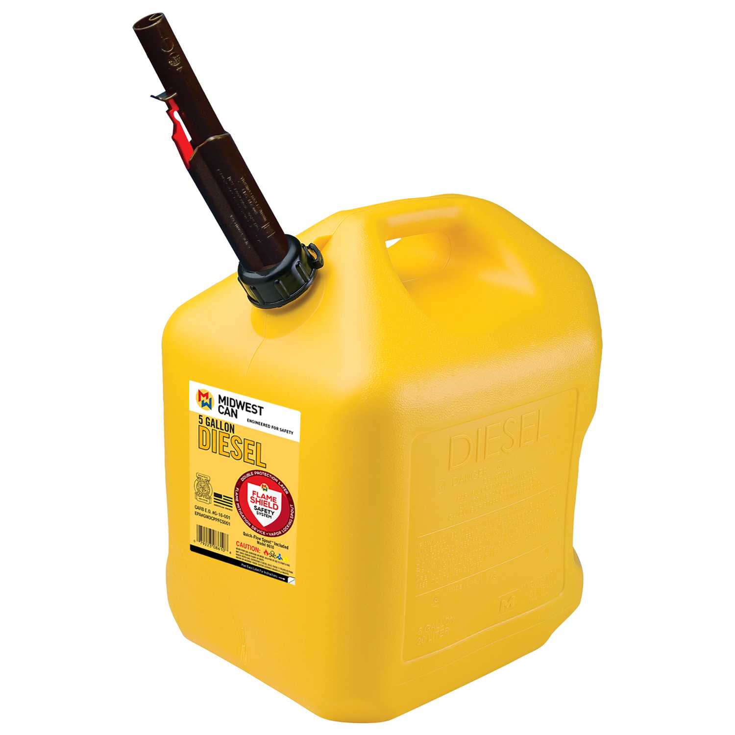

No offense, but I HATE those cans ! Too slow, takes forever to drain 5 gal. I finally inserted a vent hole cap in my 5 gal cans to let them vent properly, and now I can drain a can in a minute or less.
But the best solution is the 12v submersible pump from ebay. I even use it to pump hydraulic fluid into the reservoir when I do 500 hour service. (besides using it for regular diesel fill ups)
I use two different cans. One is like the sure can and another is a VP Racing 5 gal - I added a ball valve to the fitting in the big cap for turning it on. The VP cans are vented and much quicker. I share you experience with the can with the vent thru the nozzle. I am now 77 and climb up on the tractor with a full can - then place it on the hood and hold down the button while the releases small amounts of fuel, then bubbles to vent, then starts again. Now I empty that can into the VIP can because it is so much faster. I do think I will look into the pump that will fit into the VP and stop the lifting. I also realize that when I am gone (I guess as we get older, we have other concerns) I would like my wife to be able to fuel the tractor. Lifting fuel to sit on the tractor hood just will not work then. The can I have vented thru the nozzle has a VERY stiff button spring and is a real nightmare to use. I am certain that anyone who uses the sure can and it empties in 60 seconds and happy with the way it works has either a better version of the can I have or MUST be a different type of can. But my experience is that venting the can and all the bubbling took me about 10 minutes of holding down that button (wondering if it was all the way down or just slow.
