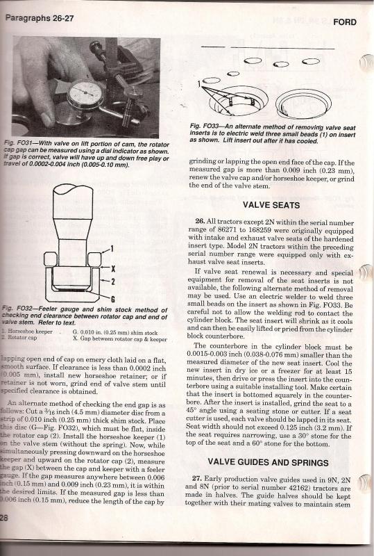

paragraph 26 from the fo-4 service manual.. sentence 1..

I know you mentioned that before SG but it conflicts with what I was told by the head mechanic at our local Ford tractor dealer where my N was purchased new in 1951. I have got to give him the benefit of the doubt since he has more than 50 years experience wrenching on old, hard-working Fords. Have you ever worked an N hard on unleaded gas that you know to have original valves? I have, and have burned up many a factory valve. It seems, based on your posts, that most of your older tractors are basically light-duty, parade-type service. I have no doubt that original, factory "hardened" valves would last a long time on unleaded gas for that duty. They may have been "hardened" but they do not last like the modern replacements do for near full-hp loads. Put her on 2 bottom plow, a 6.5 ft disc, or a pond scoop for a few 12 hour days, as I have, and you may be singing a different tune. I apologize in advance as I am surely to strike a nerve with this rebuttal to your "correction". I have great respect for most of what you post, I just believe you are in error on this subject based on my own personal experience and what I have been told by local experts. There is a big difference between a hard-working tractor and a show tractor and it seems that most of your expertise is with the latter.
I've never had a problem with 8,2, or 9 N's with unleaded gas. I have worked them too. I have seen a few stuck or warped valves, and a few worn out valves, but never seen any that failed as a result of unleaded gas.

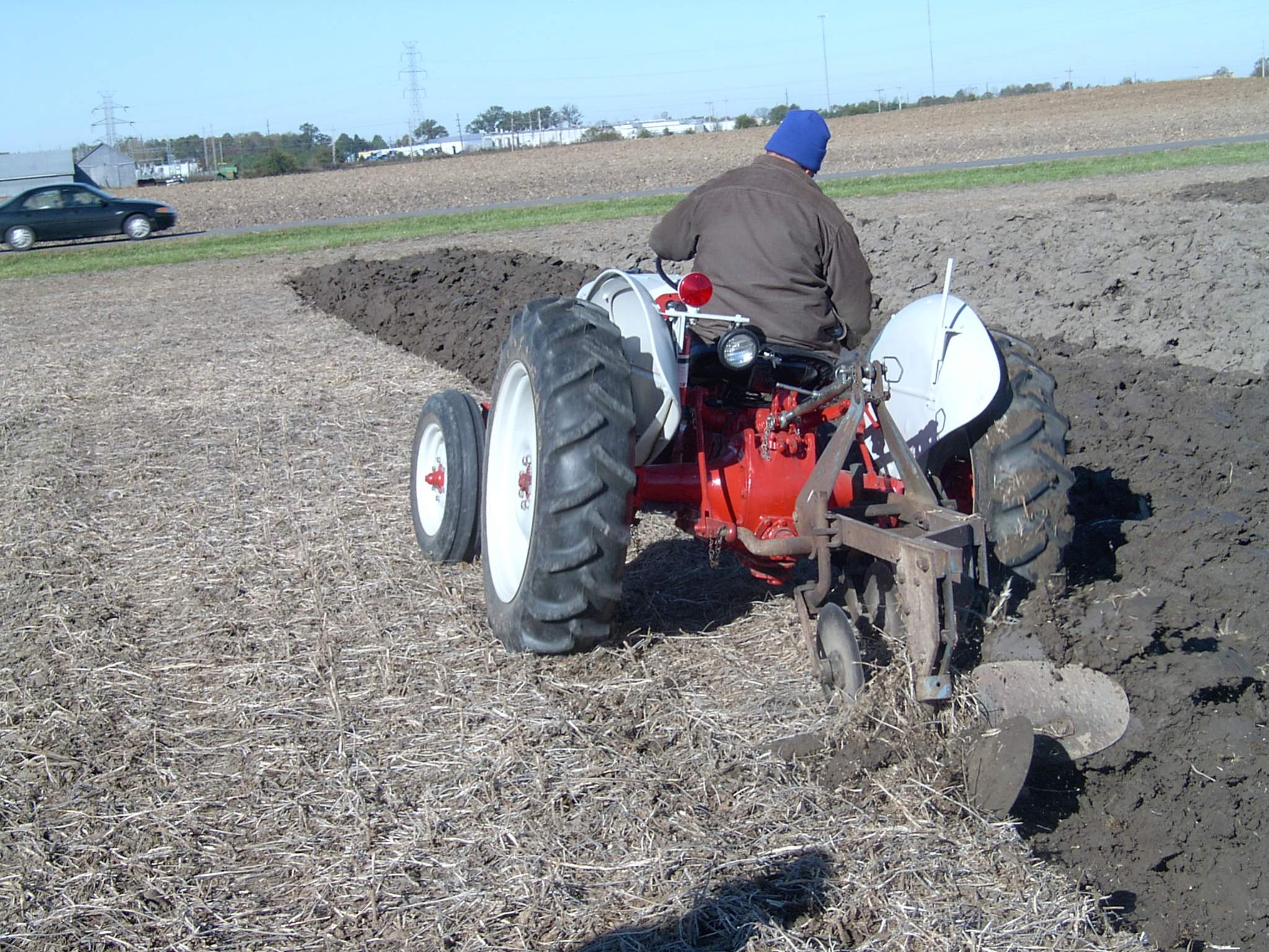

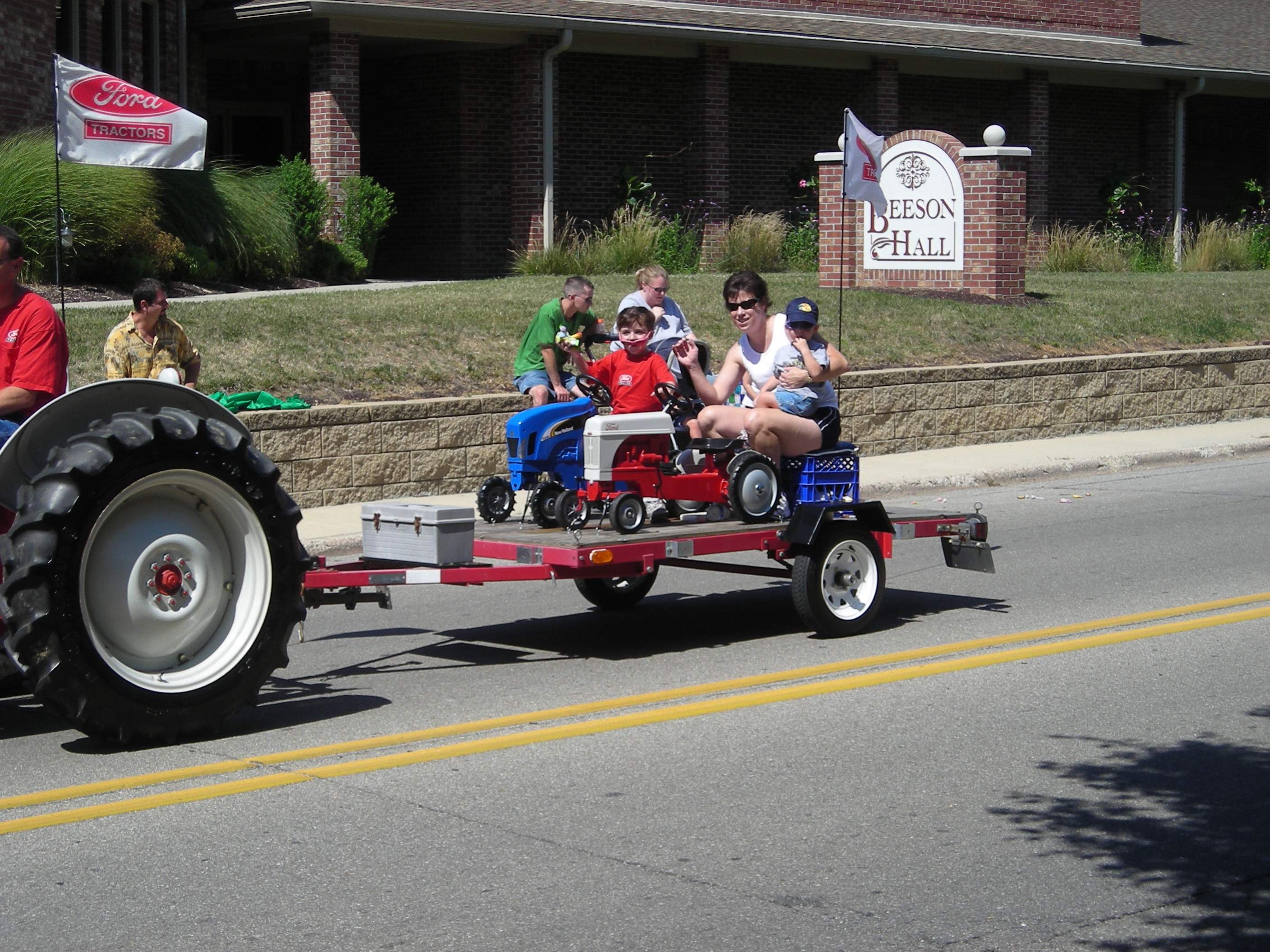

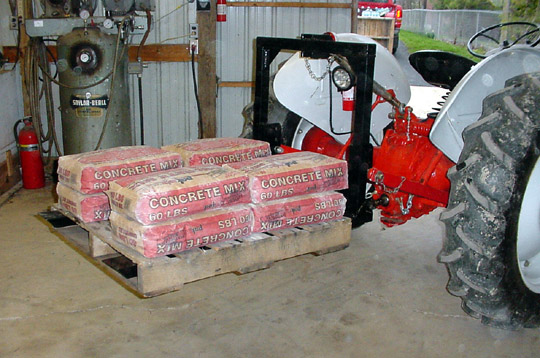

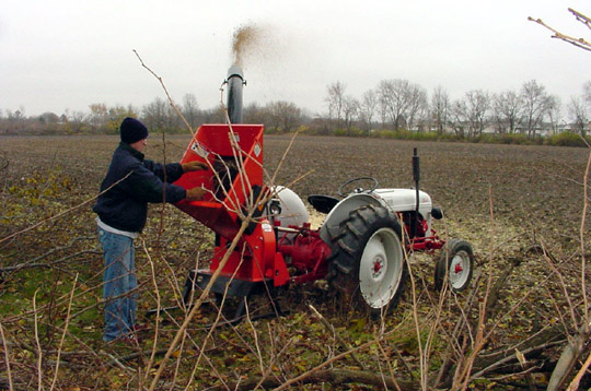

My Dad and I rebuilt the engine in this parade queen in 1990. He finally let me have it for good in 1992. 1950, Dad bought in 1960.
1st pic is parade with kids.
2nd pic is parade with 2 bottom plow. Get lots of compliments on how well she pulls.
3rd pic is parade with limbs.
4th pic is parade with cement off to build a pole barn. Weak sister pump and cylinder held the load that day.
Sorry I dont have more parade pics, but I was on it during the parade of, mowing with 6' finish mower, 6' grader box, 7' straight blade in snow, 6' pulerizer, 30" dirt scoop, 9" auger, etc, etc.
