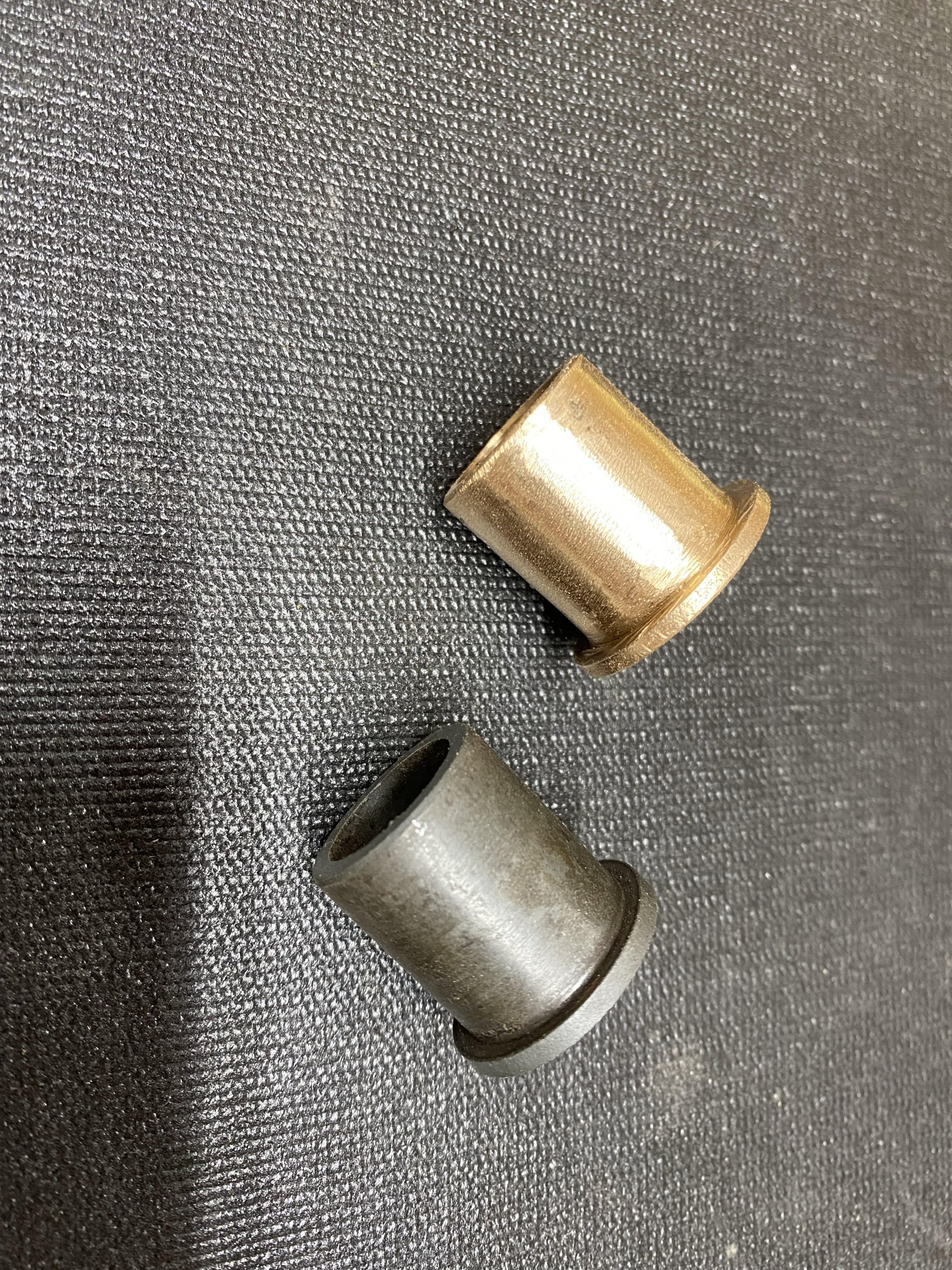

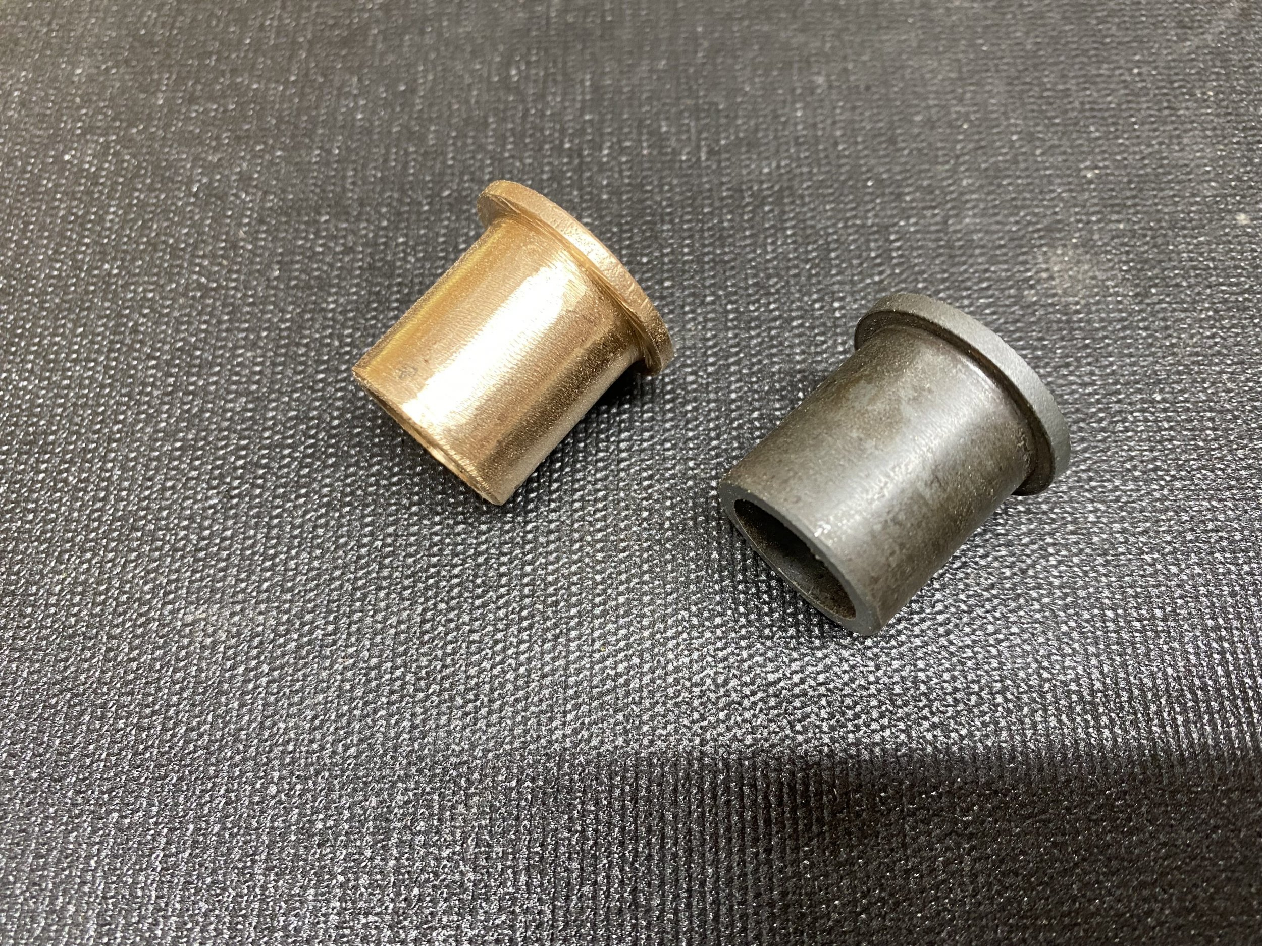

The bushings came in today. I had to find this thread again to get the measurements but I have it saved now. :giggle: I'll go with photos you posted unless you have changes.
Also, I need to know if these are a press fit or if they're just a slip fit. I looked at the photos and they didn't show any press marks. Press fit bushings need to be adjusted on the ID due to press shrinkage (collapse). If I don't hear from you, I'll go with slip fit at your dimensions.
The length of the bushings are a tad short at 24.99mm so I won't dress the face. The flange is 3.03mm so I'll dress the back side of that to 2.5mm flange thickness per your photo. What you didn't show was the flange diameter. If it doesn't have to fit in a pocket, I'll leave the stock flange diameter at 26.98mm.
   / Is there anyone that can lathe a bushing?
#36
Glad you got them! The only change needed is the I.D. It’s a loose fit and the flange diameter is unimportant. Thank you!!!

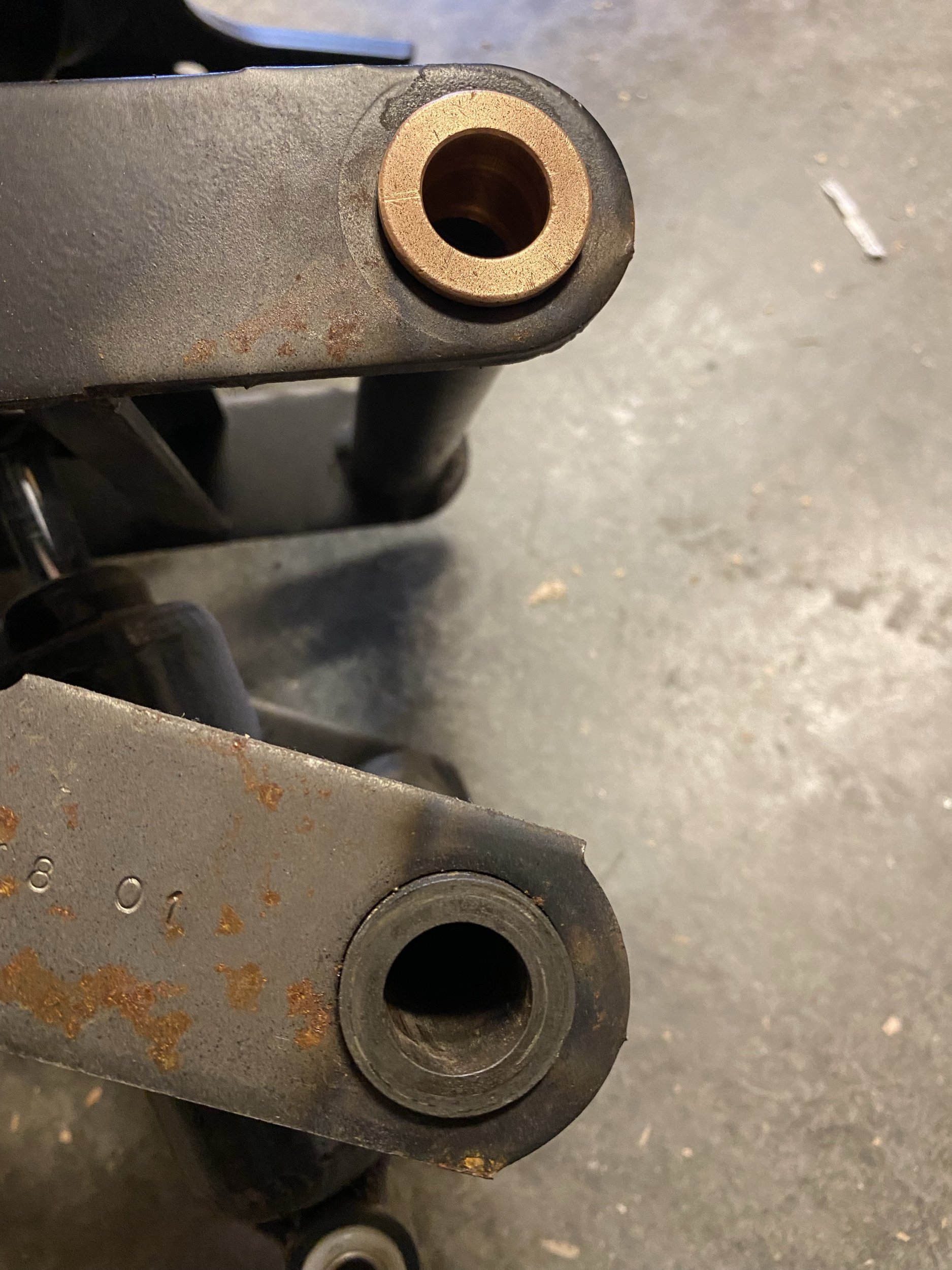

I got the bushing yesterday and like you, I got busy as well but I didn’t mind the lateness at all! The inside diameter you adjusted turned out perfect! I only had to sand the outside just a touch and it was a direct replacement!
In case anyone’s wondering, it’s for a seat suspension for a Kenworth truck. Without it, the seat tips to the left and wiggles. This is gonna make the ride safer!
