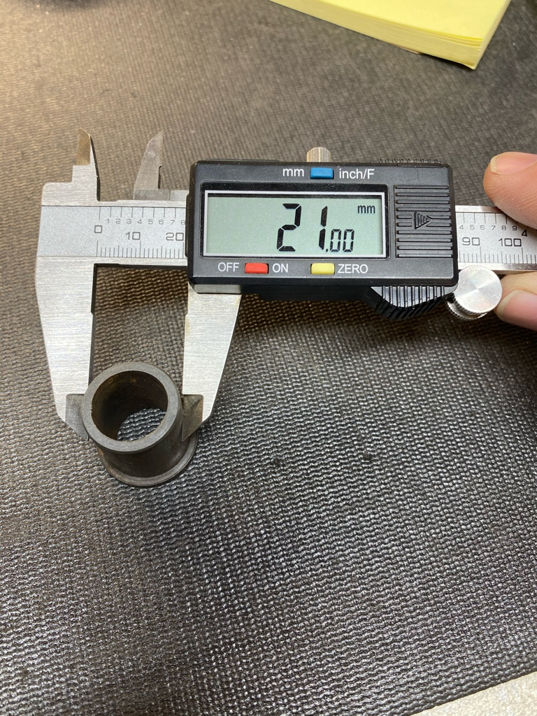

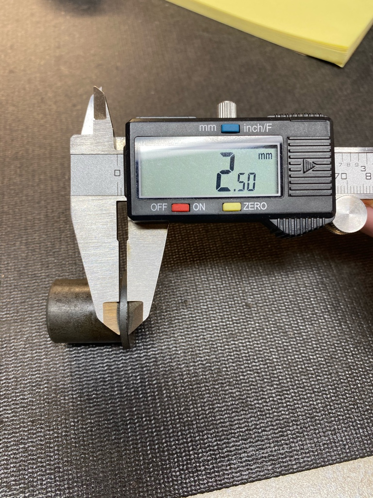

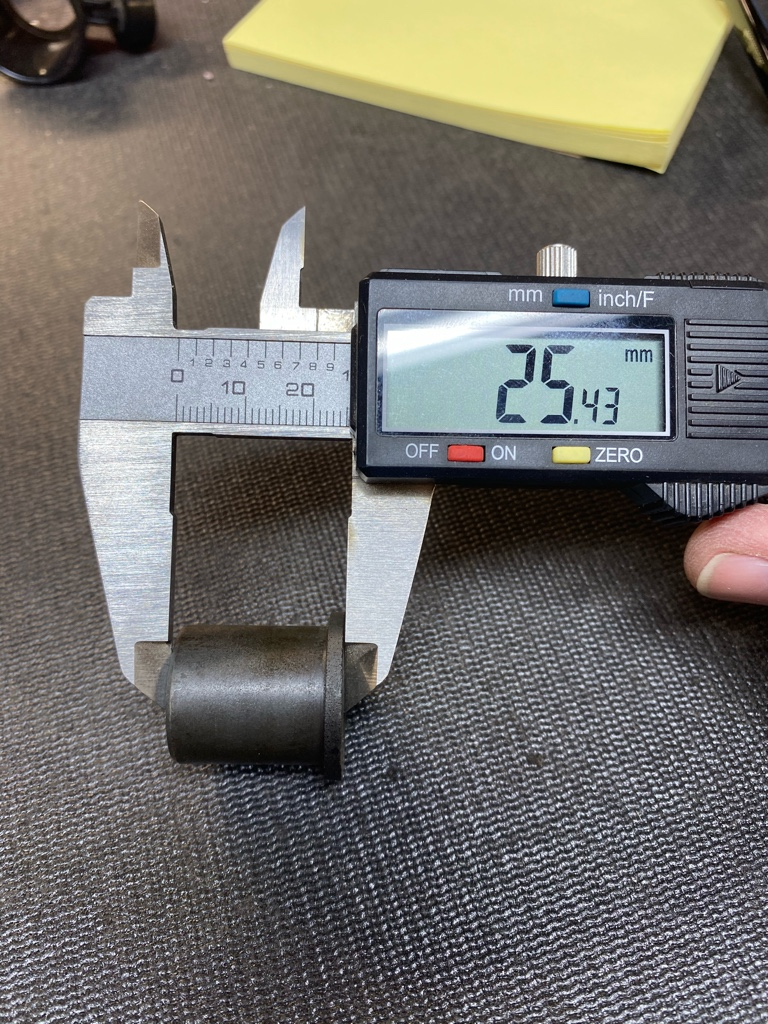

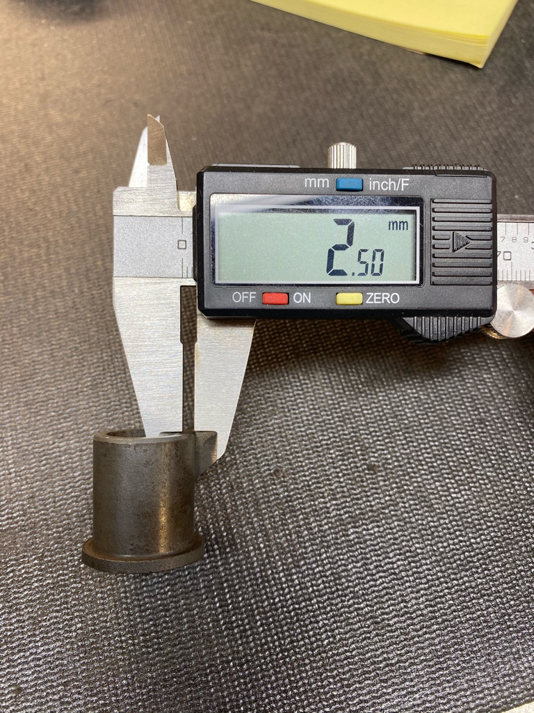

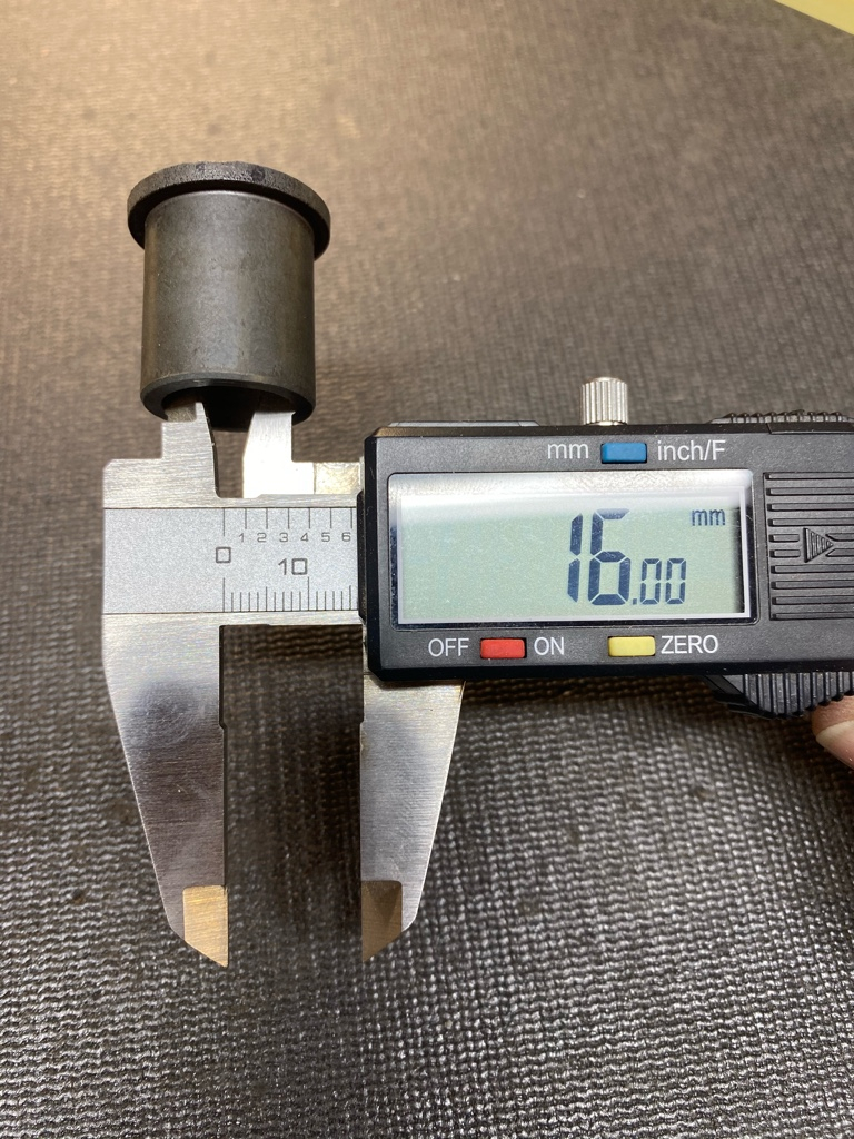

I actually took it to 2 places that supply bearings & gears and upon cross checking what they have, found none. It came off a Kenworth truck seat that was missing a bushing. Kenworth doesn’t sell just this bearing as it’s part of a $400 assembly. It’s part of a pivot. Looked online without any luck. At this point, I’d be happy to pay to get it made.
I’m looking to duplicate this part as it came with 3 when it was supposed to be 4.

If you can find a shouldered bushing slightly larger than that, (most ag supplies in stock) hand tuning it should be fairly easy.
