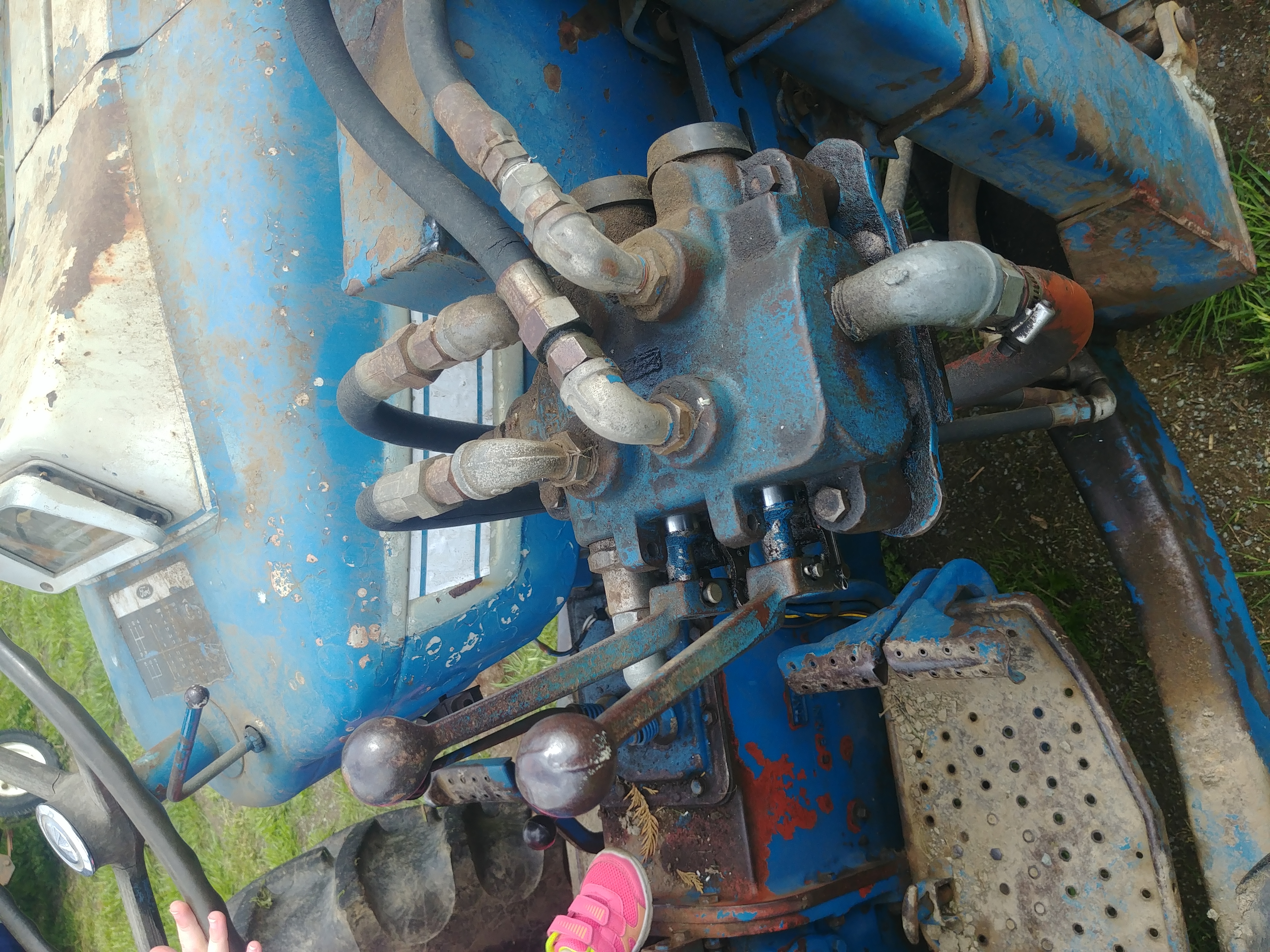

is this a power beyond valve?
   / is this a power beyond valve? #1
Chrisb62
Member
Jun 7, 2017
33
Canada
Mf135, ford 3000

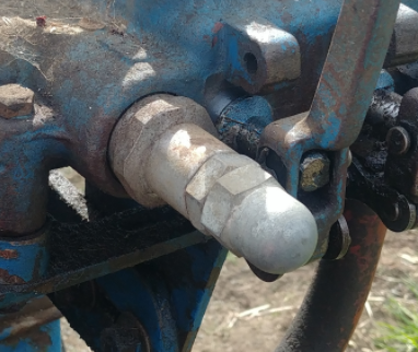

in the pictures. the bolt thats blocked off by the levers.
   / is this a power beyond valve? #2
Looks like it might be. See if there's anything on the flat spot near the port.
   / is this a power beyond valve? #3
I see 6 hoses so if that is correct there is no power beyond at the present.
I also see galvanized plumbing street elbows used which is a big No No as they are not designed for the pressures in a hydraulic system.
Further, teflon tape is used everywhere to make improper fittings. That product contributes tiny strings to the hydraulic system which is bad for the pump and valves.
If you need another hydraulic circuit suggest you start with a new FEL valve with the correct hydraulic fittings and with a power beyond sleeve in it.
Alternatively, you install another single spool control valve ahead of the current FEL valve and then new valve feeds the old valve with its power beyond circuit.

There is a bit more to choosing a FEL valve if you want to be happy in the end.
The valve you have selected is rated for 25 gpm. Your tractor has no where near that flow rate I expect
When you put too large a flow rated control valve on, you loose the ability to control a loader in fine movements such as a buddy in the bucket and you want to move the bucket slowly and smoothly.

You have not stated why you need power beyond. For someone like me to help you, I need a complete picture of what you are wanting your tractor to do.
I suggest you do some homework and establish the flow and pressure rating of your tractor. Next have a clear picture of what you are trying to accomplish.
Then call the Tech support people at Cross Manufacturing. Before calling look over on their site the many options for loader valves.

As I look at for photos again, I see a hydraulic reservoir on the side of the loader frame.
With you talking about a pump on the front of the engine, it makes sense that the loader pump is just for the loader and will be probably higher than 5 gpm.
Is there any model or brand info on the loader. Allied perhaps. Same for the pump, brand , model etc.
Post some photos of the pump and its hose connections to the loader valve and reservoir.
If you find any loader info and if you throughly clean the loader valve so you can see any markings or label info, other options may be possible.

After looking at it again, it's possible that's a relief valve. Shut off the tractor, take off the pressure and remove the cap. You'll find out what it is. If it's power beyond you should be able to use it to power another valve.

In your existing setup, the relief valve is in the FEL valve block.
With the selector valve, you need to make certain the backhoe valve has a built in relief.
You will also need to keep an eye on oil temps as the backhoe is constantly moving and will heat the small reservoir much faster than a FEL

and from what I can tell I think your looking at the Pressure relief valve on the valve block,

I'm not Dave but the valve in photo below appears to be an adjustable relief valve. Yes hyd control valve with power beyond when attached to open center system will normally have 7 hoses attached to it.

The "assembly" beside the two control levers is the adjustable relief valve. Most open center farm tractor type loader valves have them.
Let me explain a little further. Should you have a power beyond circuit coming from the loader valve and going to a second control valve,for a top and tilt for example, the second control valve also has a relief valve.
The FEL relief valve is set at 2,200 psi just to pick a figure. No matter what you do to the relief valve on the top and tilt control, it will never produce pressures higher than the FEL relief valve as the FEL relief is dumping any pressure above its setting. If you wanted the top and tilt relief valve set to 1,500 psi, you can do that and not affect the FEL pressures as they are first in line from the pump.
Please don't hesitate to ask any question. We all started with no knowledge at one point and it is the obligation for a few like me who have a bit more to share with others who want to learn.
Currently Chris' loader valve has a return line to the tank or reservoir. This is necessary for several reasons but a critical one is to provide a place for the relief valve to get rid of excess pressure.
On his normal loader valve there is a high pressure supply from the hydraulic pump. there are 4 work lines going to the double acting lift arm and bucket cylinders.
One high pressure supply line
One tank or return line
Four work lines
Total of six
Six is the basic number of lines a double spool FEL valve must have.
If there is a seventh line, that tells me that it is a power beyond line because it is above the number for simple FEL operation.
Sometimes you find uneducated people using the tank port to feed another hydraulic circuit. They cannot see why a line, which has fluid flowing in it, cannot be a pressure line for another valve.
There are design reasons too complicated to go into why this is a bad practice but the specification of most valves shows a simple reason not to do it.
The green arrow shows the design working pressure of the valve. The red arrow shows the much smaller design pressure of the tank port.
The only reason it is even 500 psi is in case you are using the tank port to supply a return line filter which creates some restriction in the flow of oil going back to the tank or reservoir.
This is an example of where a power beyond plug or sleeve would go.
This next fancy sketch is the type of Google search find that seriously misleads owners. It is using the out or tank port of the first valve to feed the second valve.
It is both wrong and dangerous.
Another WRONG example this time from youtube.
Power beyond is also called High Pressure Carry Over HPCO which is a better term to describe what is happening.
More questions, just ask. i never give short answers :)
