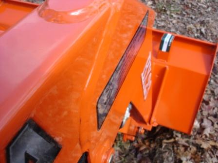

This is late in the game, but I thought I would make these 39 pages one post worse by providing some reference pictures. I received a BX23 registered in 2006 this weekend. It was manufactured in Gainsville, and attached are pictures of welds on the FEL. There is an occasional nib of splatter here and there; the beads don't show the level of artistry of a 'perfect roll of nickles', but they are smooth, no visible gross cratering, penetration looks good to me, and no sharp, undercut edges. I am comfortable with what I see.

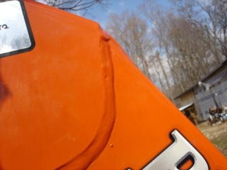

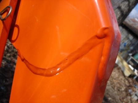

A Hah!!!! Weld splatter.............I won't even start, but it goes to show it could be anywhere, just like anyother welded product. Who cares??? If it takes a close up picture I don't. By the way, all my machines are inside and I am the ONLY one who drives them, my employees drive rakes, and cheap ones to boot cause they always break them. I take serious pride in my machines, their peformance, and they are 1/2 of my bread and butter. I will take images of my Kubotas and their welds by Tuesday (gonna snow up here again and I have to plow, and yes, I wash the salt off every time, and yes who say the L48 is slow, I plow with an L48 with rear blade and make huge money!!!) and we can all see what the industrial Kubota lines have for welding. I have never gone over every weld, but I guess I will try now. From just memory I remember my newest L48 having some thick ones. I posted pics of the machines here on this forum by the way. Good thing I didn't post closeups or you guys would be howling for a recall, how is that for humor. And you guys didn't even think my pound of dirt analogy was funny, but that is what I consider it.
So, pictures by Tuesday. Should I go over my new F450 and older Ford Tractors as well since they were made in the USA as well? By the way, I am so Kubota brand loyal my company work shirts are bright orange, my child has Kubota infant clothes and people make fun of me cause they think I have more Kubotas than I need (we all know they are jealous and we all know who they call when they need tractor or excavator service). I should also say I only use the spilled fuel on my hood to wax down my machines, and before you all yipe, have any of you tried fueling one of those? I also grease the **** out of all of them till the point my wife hates them cause she ruins clothes everytime she hands me my son for a tractor ride. Wife and grease are like oil and water. Anyone else want to post some pics of welds, will thick welds make anyone sick? Beer and pizza at my house if you bring your machines!!!
