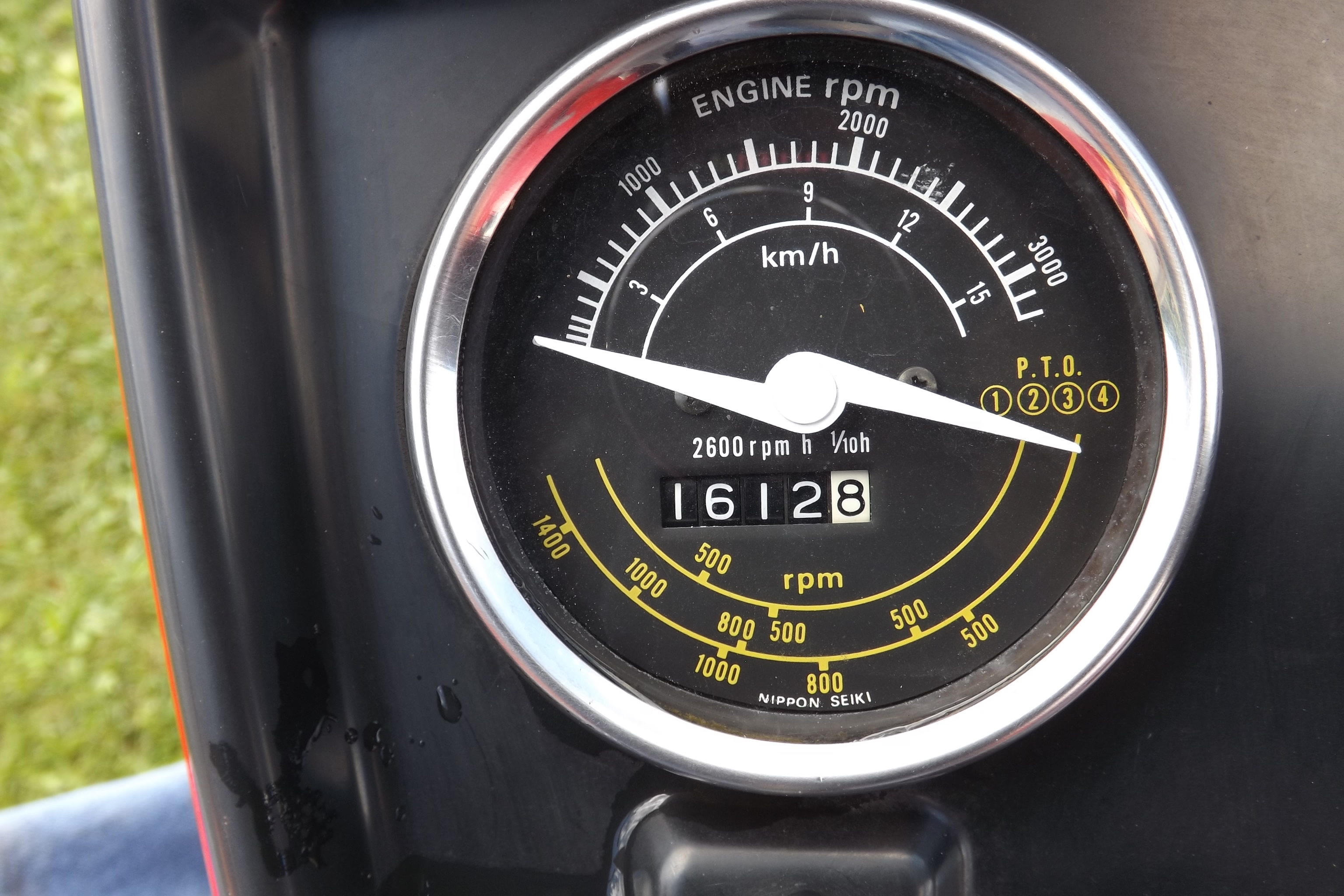

I love the fact my YM2610 has a PTO 4-speed. 542-685-1005-1268
And with CA's input here of the throttle lever, the PTO speed like most tractors is VARIABLE.
In the image:
PTO-1 is 500-RPMs @ 2,400-RPMs engine
PTO-2 is 500-RPMs @ 1,900-RPMs engine
PTO-3 is 500-RPMs @ 1,300-RPMs engine
PTO-4 is 500-RPMs @ 1,000-RPMs engine
With my brush mower, I run it in PTO-2 and about 1,700-RPMs engine. Sure, it's less than the 540 PTO speed needed, but everything works just fine this way. Less wear on all thing too. Now, with tall thick pasture that was over grown, PTO-1 @ 2,200-RPMs engine works just fine.
To run a NorthStar PTO generator, PTO-3 @ 1,400-RPMs engine works really nice. Why run the diesel hard and drink down the fuel with PTO-1? Let everything run at nicer RPMs to get the same results.
Error | DNS Resolution | Northern Tool + Equipment
Now, on the SAME gauge, there are other PTO speeds for other equipment should it need to run higher.
I'm very impressed with the hour meter tach feedback for the YM2500-YM2610-YM3000-YM3110
