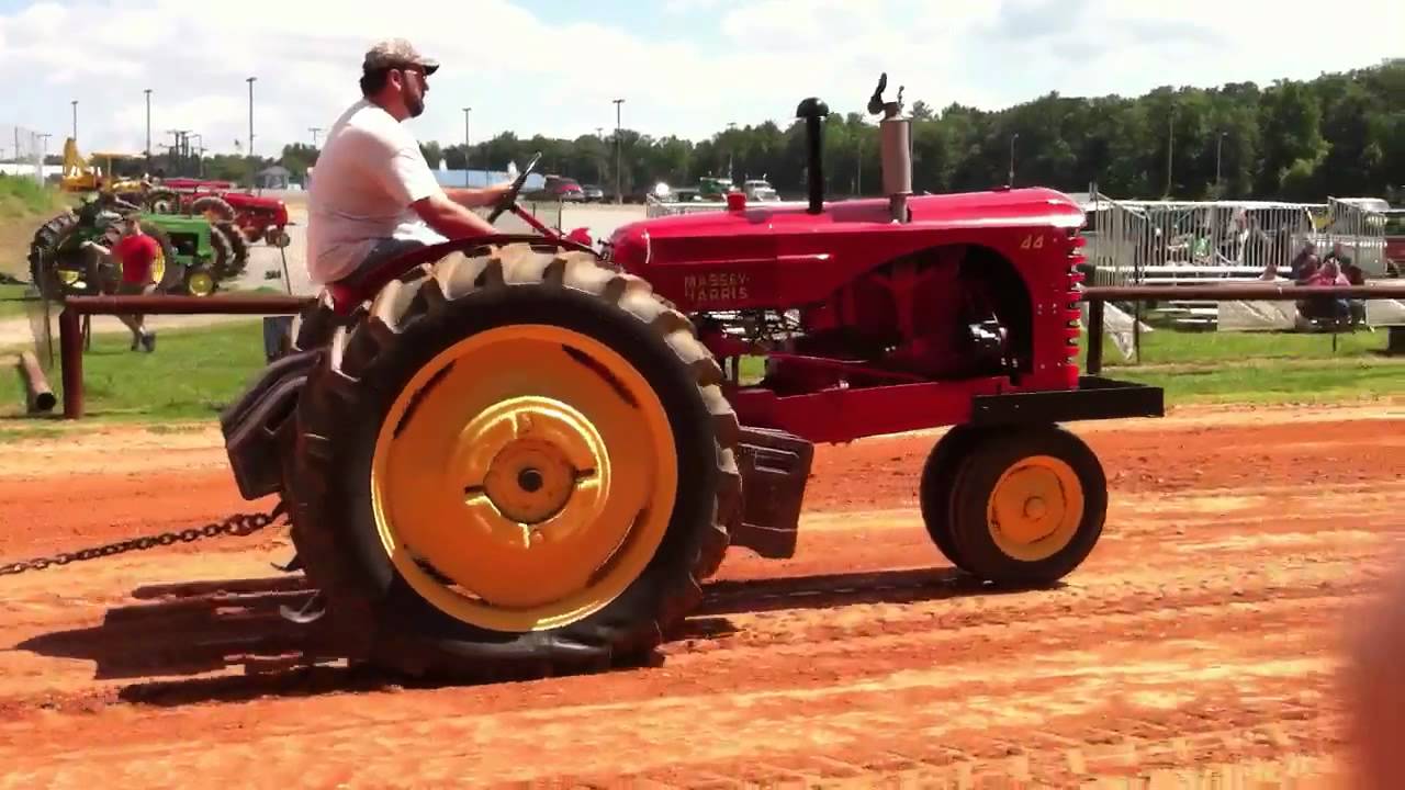

All my neighbors have tractors. The scary one is the Massey-Harris 44 trike style. That rearward seat is a metal pan just outrigged literally off the back end. Even with a ROPS, should the front end come up, your are a dead man. That seat just bounces on flat ground too. Not a machine for hills or anything else really.

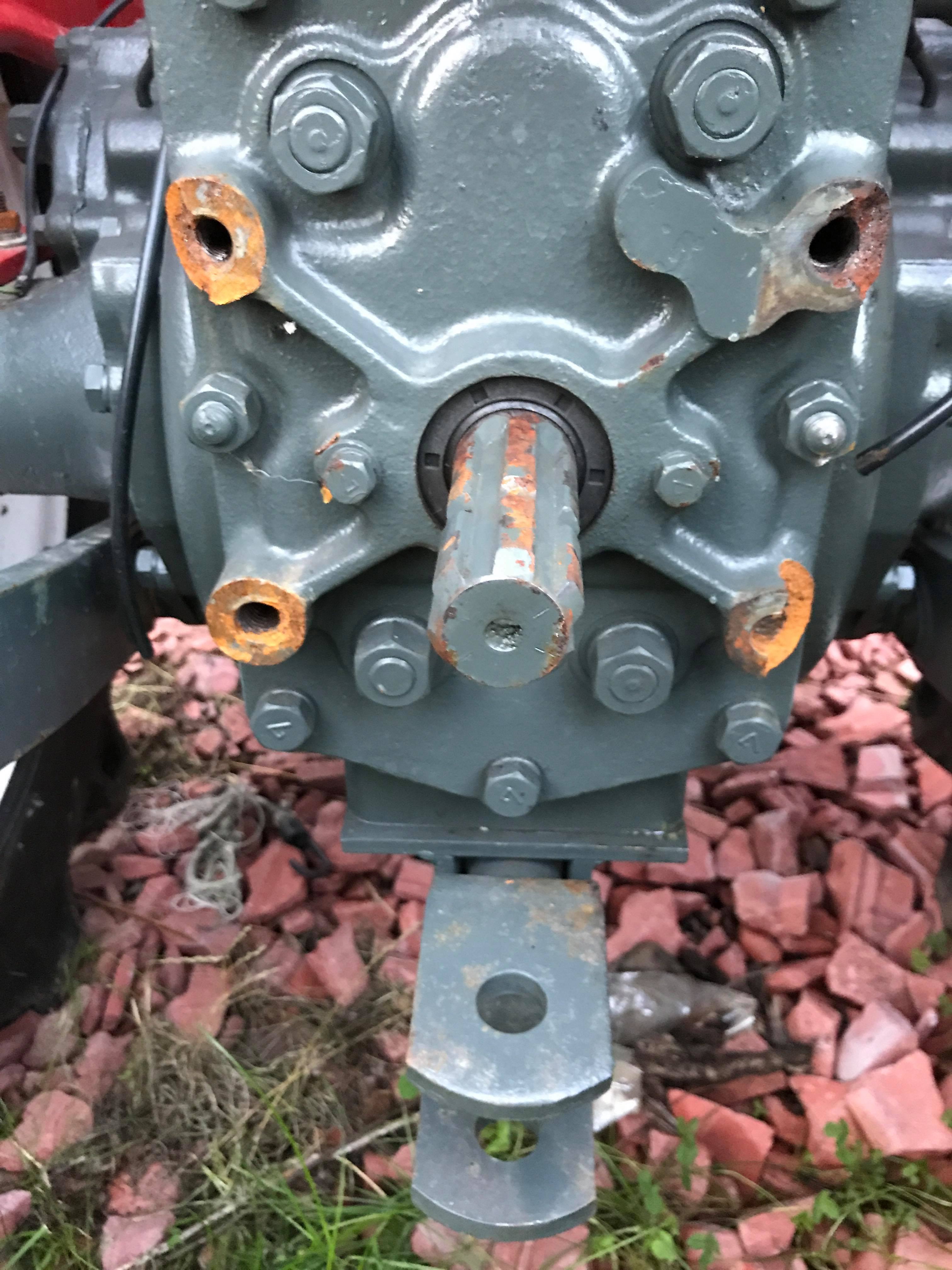

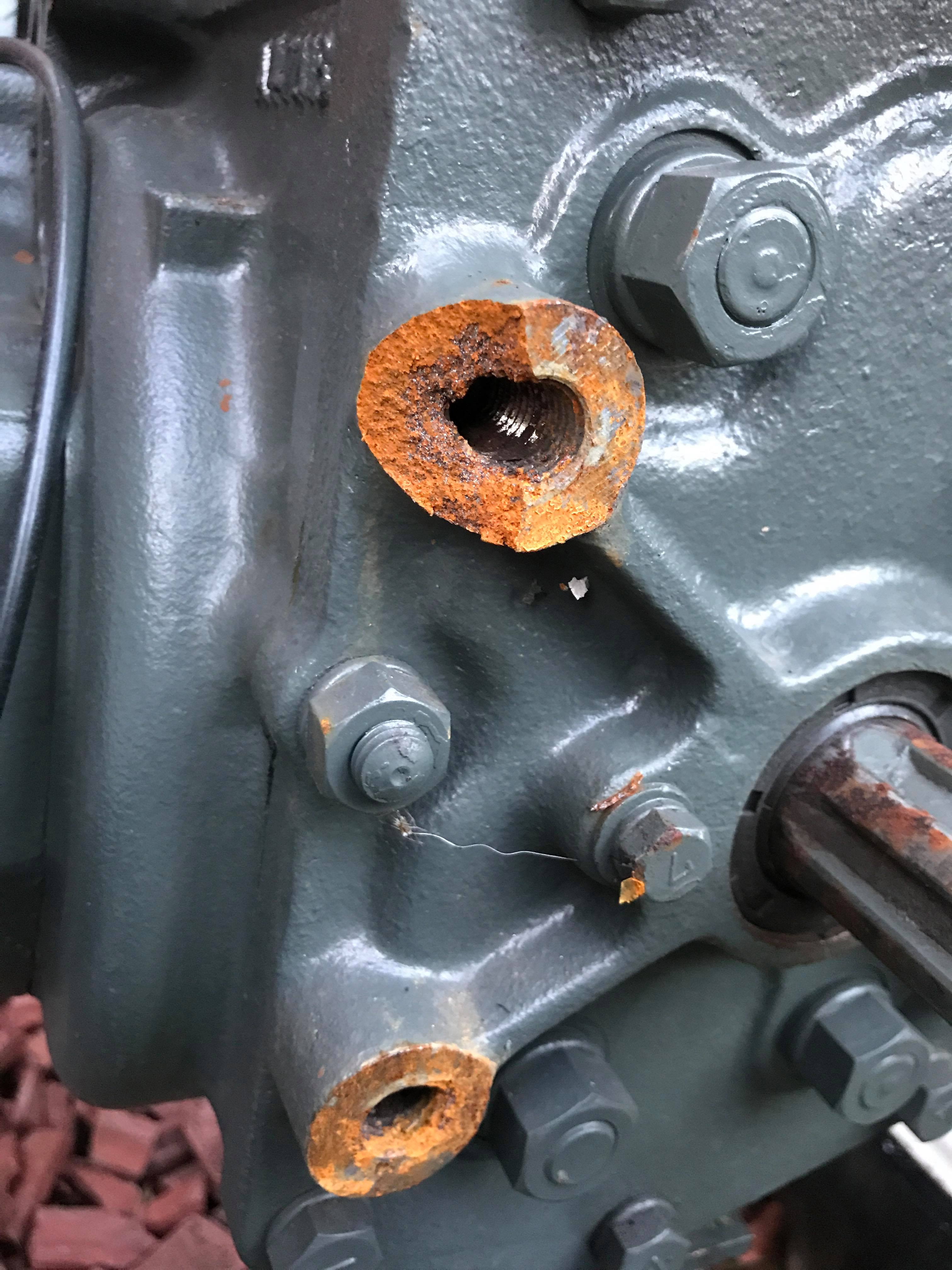

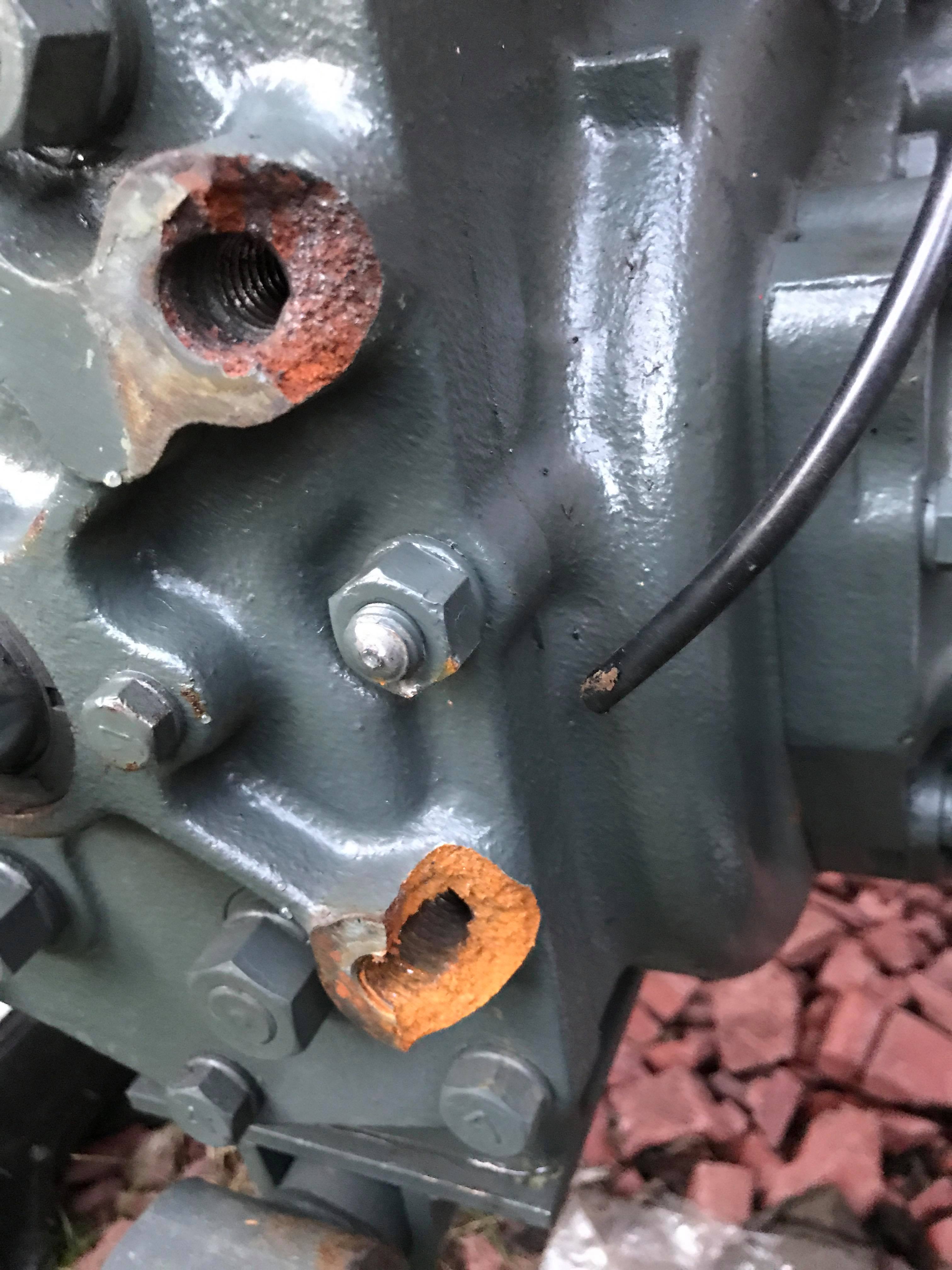

Just bought one from that same store. Different ROPS but I rolled it and the ROPS broke out of the bolt holes and broke the bolt holes on the pto cover. I wouldn't advise buying from them.

And wow! Do you have any pictures of the damage? You escaped ok?

How did you roll it?
Did the ROPS provide any protection?

The ROPS did work but when it broke off it damaged both of my fenders, my seat, and eventually my wallet. I am looking for a way to fix this without buying the 400$ cast iron pto cover. Maybe some brackets that are stronger than the 2 inches of cast iron?
