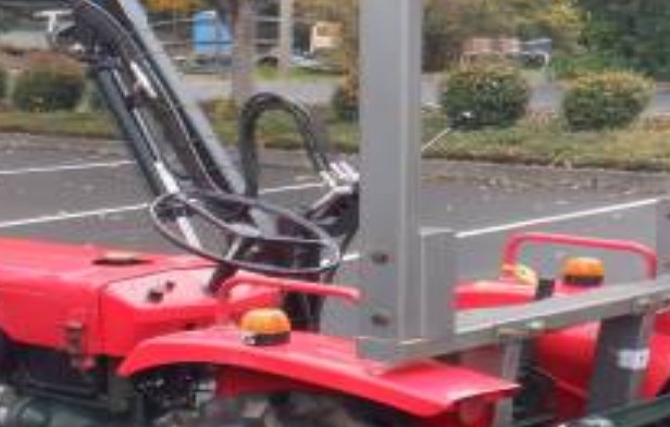

Is this dealer selling a certified ROPS? Looks fishy! What the heck is that?
19 HP Tractor with Front Loader - 4x4 Diesel - Yanmar - farm &...
I loaded the image taken from the left rear quarter into a separate tab and then zoomed. The bar crossing behind the seat appears to be the same dimension as the bar loop, which appears to be 1-1/5 x 3" material or similar dimension. I don't think strength would be an issue, but I question the geometry.
   / Is this dealer selling a certified ROPS? Looks fishy! #54
That does look really small, seems almost like that should be a 2x3 or 3x3.
The crossbar on our l3830 is 2x4, but the 4" direction is the vertical one, so it can resist the forces it will see in a rollover better that way.

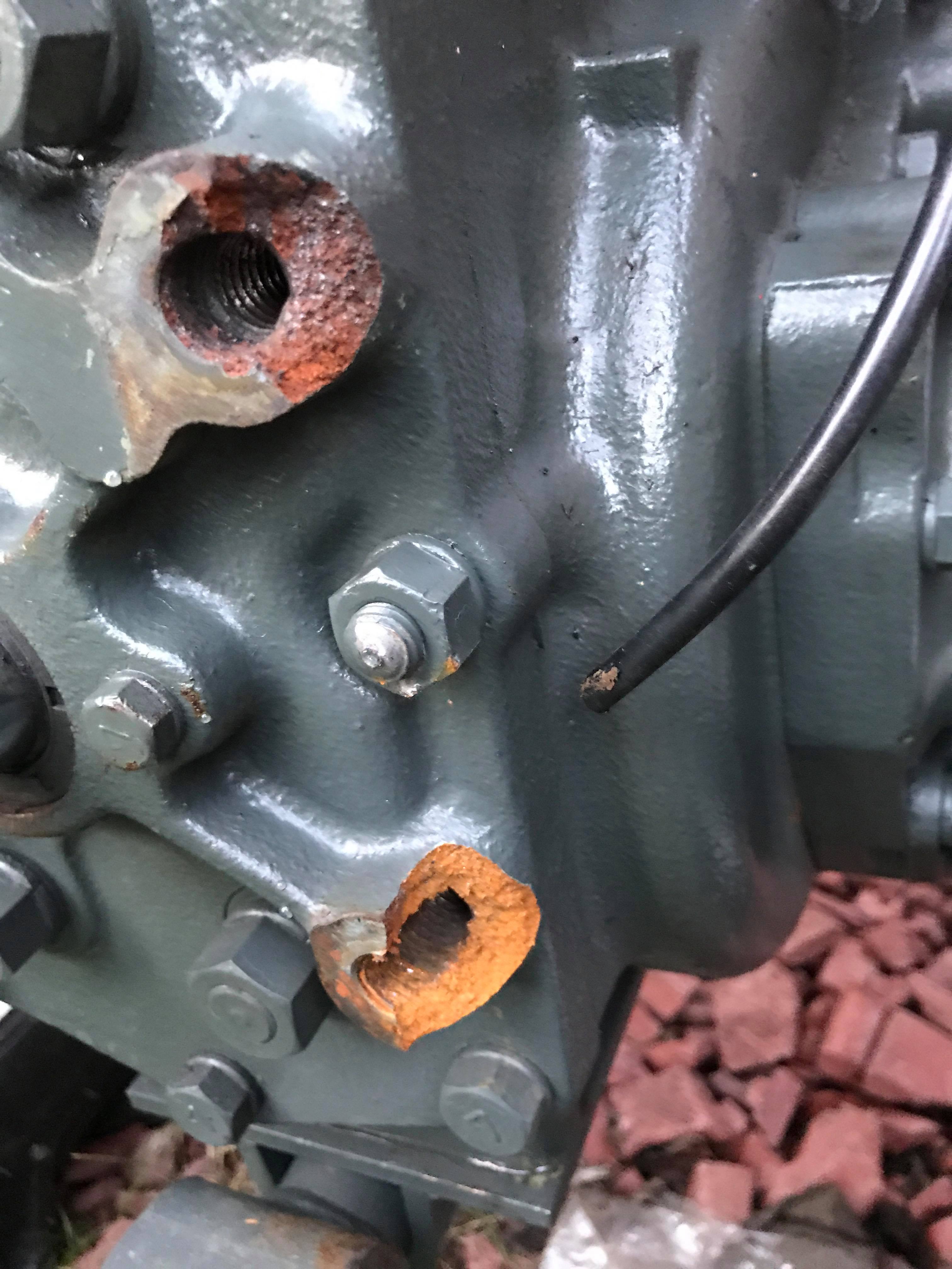

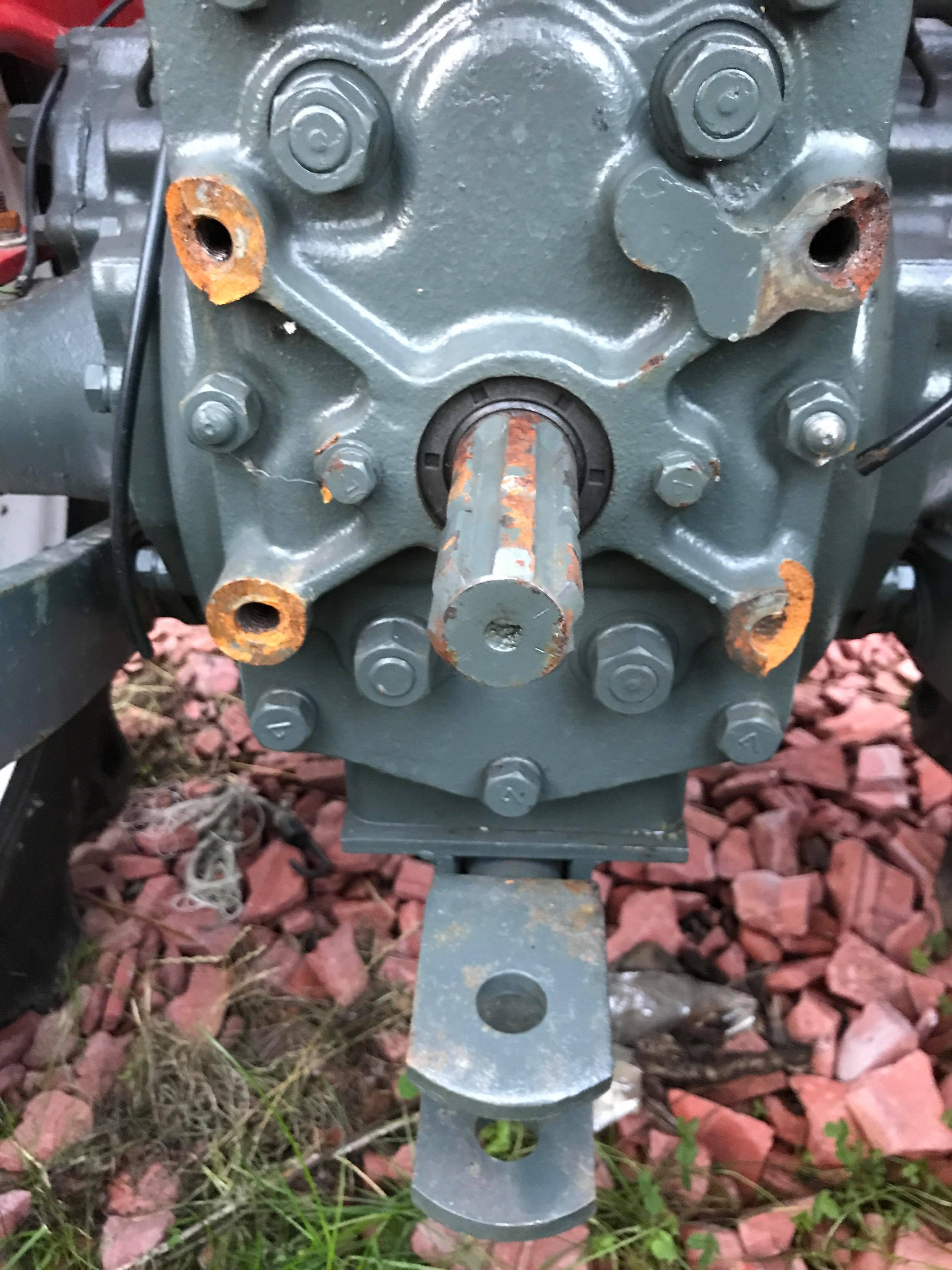

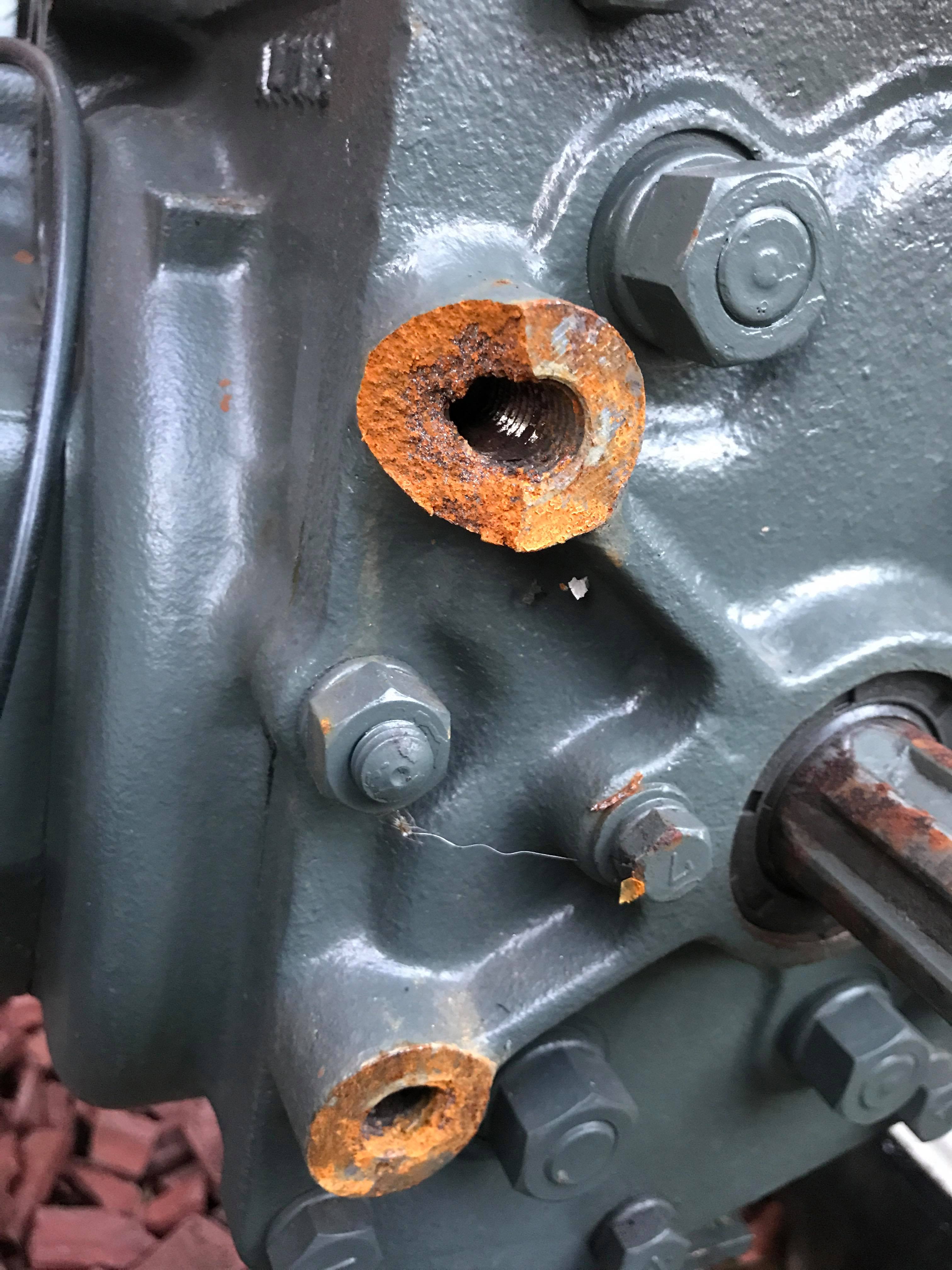

View attachment 676064View attachment 676065View attachment 676066
The previous owner of my property left several piles of "construction material" (garbage) in several places. He then got old and stopped maintaining the property and I ran over a half-buried 3pt rake covered in blackberries. Ballast is going on this week and I am swapping the tires before I use it again.
The ROPS did work but when it broke off it damaged both of my fenders, my seat, and eventually my wallet. I am looking for a way to fix this without buying the 400$ cast iron pto cover. Maybe some brackets that are stronger than the 2 inches of cast iron?
you don't mention the mod tractor this is. I would like to look at a Fredricks tractor of the same mod to see if the ROPS are mounted in the same manor.
Just my opinion, but I just don't believe this casting alone would stand the pressure of a roll over without breaking .
On the 3110 I had, the ROPS bolted to the top of the axles and around the axles
