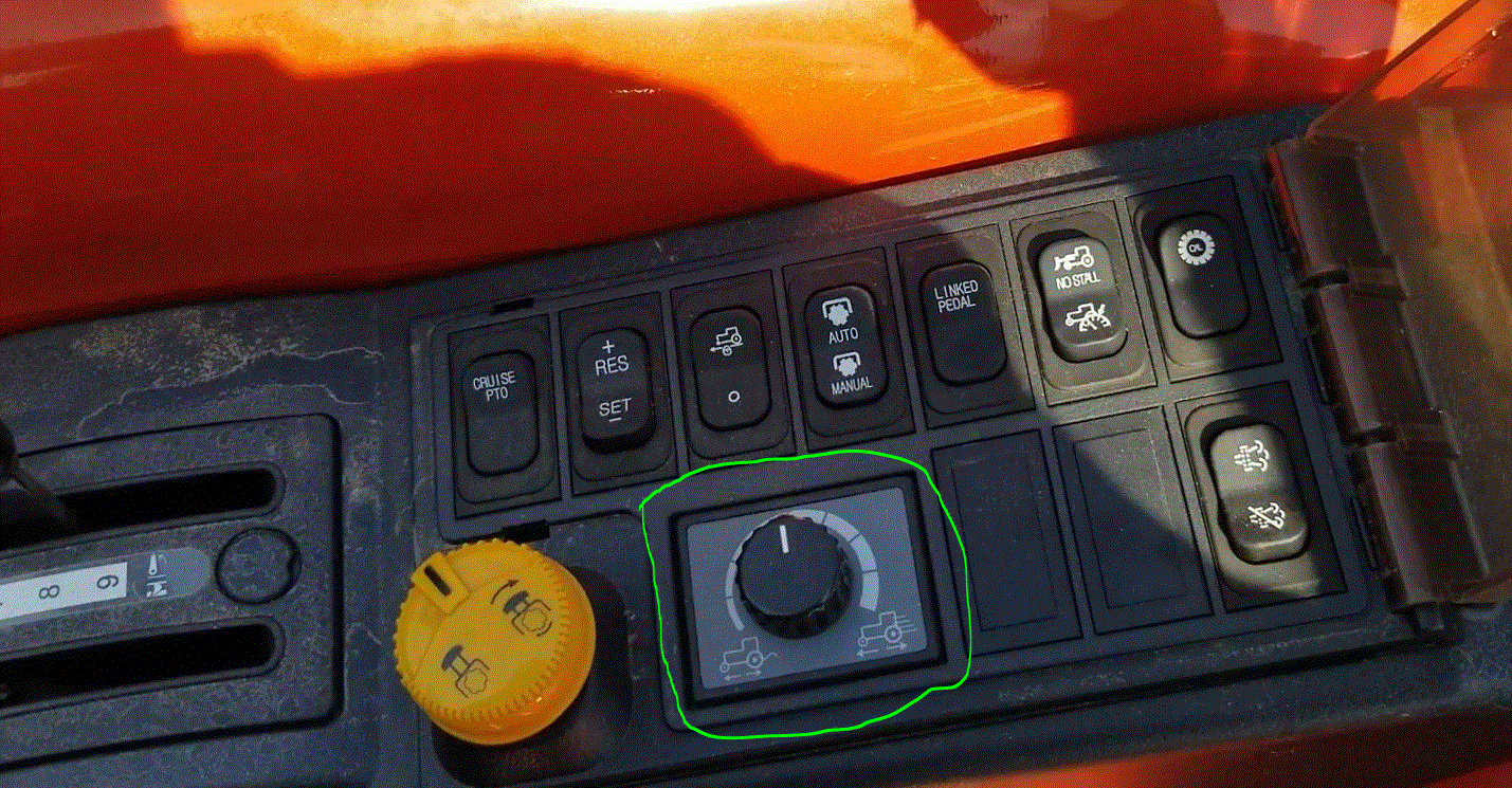

Does this model have the speed adjustment knob? It has a icon of a tractor on both sides to indicate faster slower.
It is the adjustment setting knob to change the response of the HST when the pedal is released.
It will go from a short slow coast to a sudden stop depending on the adjustments made.
Could not determine this by the Kioti site, only that it has a linked pedal.
If it does have this adjustment knob, just play with it and adjust to your comfort for response.

Do you have something similar to this control?
On mine that adjusts how the HST reacts from real grabby to a long coast to stop....

No, my CK3510SE does not have that adjustment.
I stopped in at the dealer & talked to the service manger this morning. I explained my issue. He called me back this afternoon. He said he called Kioti & was told that there is no adjustment for this. He said that he test drove a couple of tractors on their lot. He said that they did the same thing I explained. He offered to come look at my tractor this afternoon. Since I only have about 6 hours of time on the tractor & I am coming from a tractor that had brake pedals on the left side. I decided I needed to get more experience on this tractor. If later I still think it is a problem, I told him I would get back to him.

As you have learned all Kioti's are not alike. There is no user adjustment for the run out on mine either like that NX, but it works just like the Kubota it replaced. If I am going down hill and jerk my foot off of the fwd pedal, rapidly it would slide the rear tires as if brakes had been applied. It would stop, and then after a few seconds it would very slowly drift down hill. If you let off of the pedal slowly when going down hill, it will just slow down until you let your foot totally off of the pedal, then it will stop, and then slowly drift down hill. If that is normal for a new CK3510 then I would not like that a bit.
Grand L Kubotas have an adjustment for hydro run out and sensitivity also, but not standard L's like I had.

Just some operational background color: I rarely use the brakes on my NX except to hold grades and when in town in high gear coming to stop signs. Even then in high gear letting off can be abrupt if I have the hand throttle closed and and running with linked pedal even with my HST adjustment set dead center.
