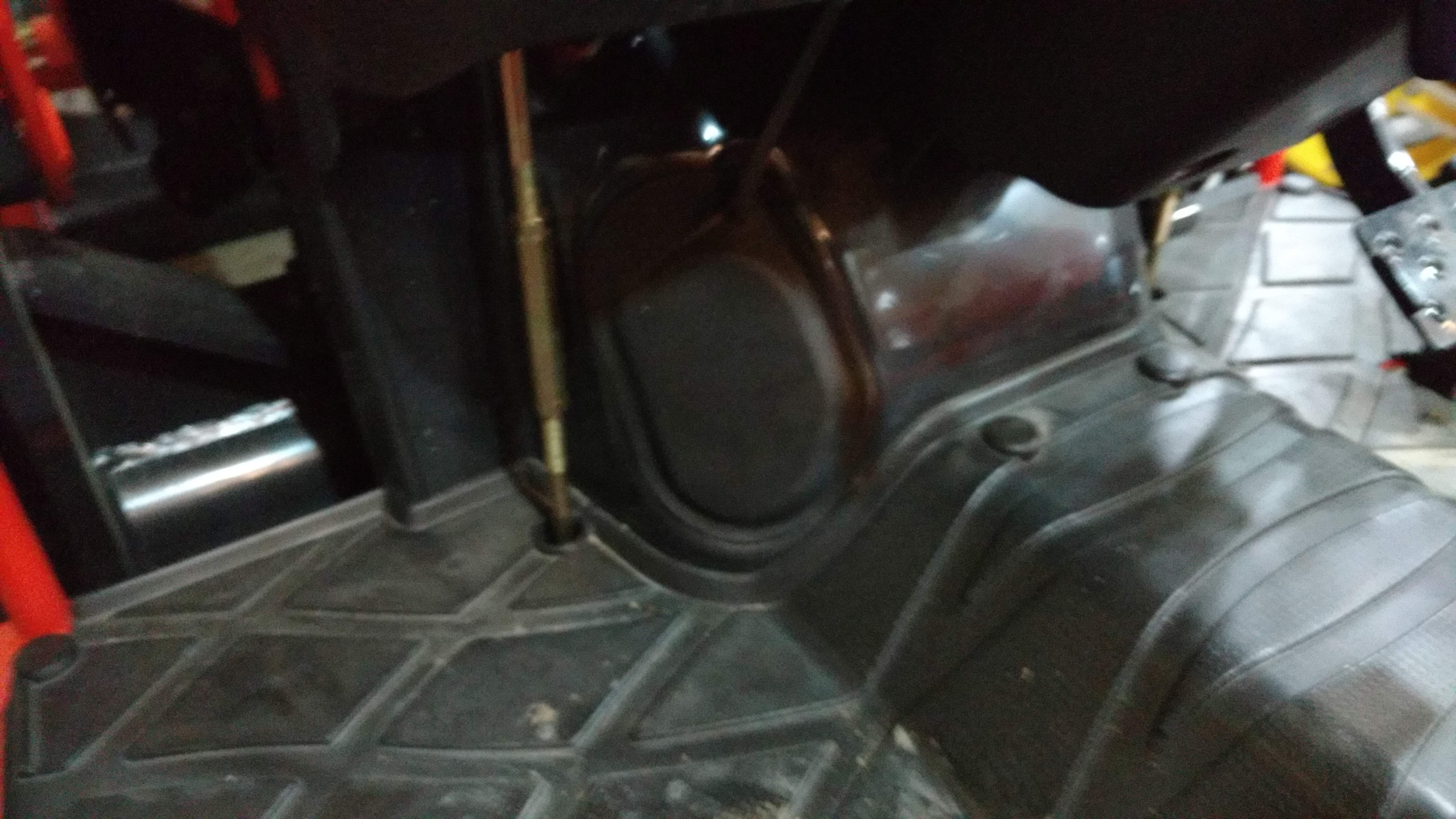

My brake pedal is mounted above, behind the steering column cover. I looked up behind the steering column cover this morning & it appears that I might be able to put a brake pedal on the left side. There is a shaft that runs from the right side of the steering column, to the left side. I will need to remove the steering column cover to know for sure. The gold rods in the pictures on each side of the steering column connect to the left & right brakes.

It rolls in both directions, but after getting more time on the tractor, I am not sure I would consider it free wheeling now.
