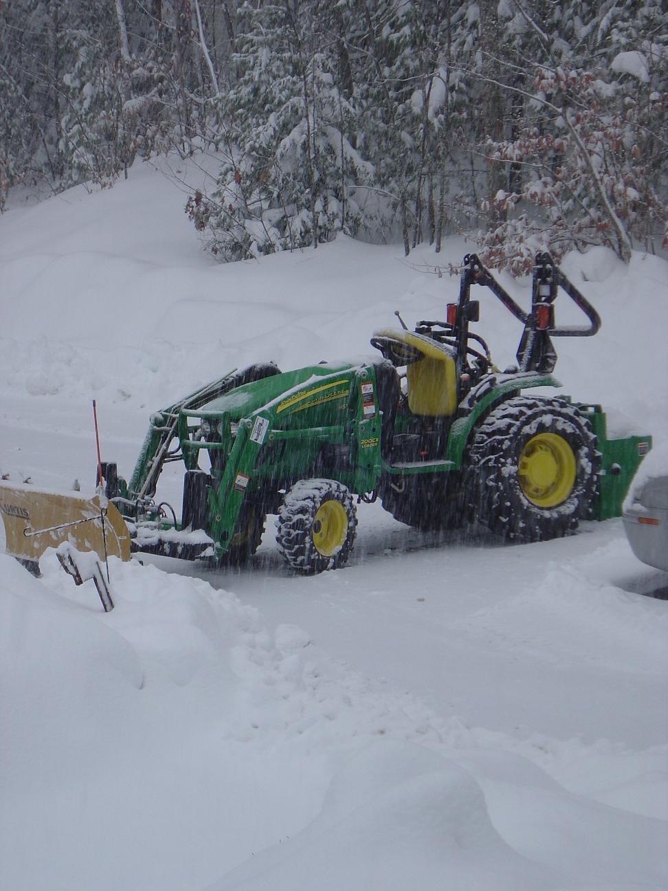

Hiya,
I live on a mountain in NH, we average about 14-16 feet of snow a season, I have a 2520 and a 600 foot steeply inclined driveway so I can offer some real world advice.
First off, load the rear tires, the 2520 needs loaded rear tires for anything more than cutting grass. If your drivway is paved, you won't need chains 99% of the time, I never have. If you really concerned with ice, go to a fastner supply house and get some #10x1/2" grade 8 sheet metal screws and put them in the lugs in the front tires. They won't mark the driveway like chains will and work well on ice.
Second, decide on what type of blower you want to get, front or rear. I currently have a 65" 3-point blower for the back of mine, works great, throws the snow into next week no matter how deep or heavy. Yes, turning arround and backing up does get old.
Third, if you choose the rear blower, you should have a front blade, you have to decide on either frame or loader mount, both have advantages and disadvantages. The loader mount blade is easy to change over to, has greater reach when banking snow, more weight on the tractor front wheels and higher cost. The frame mounts are generally easier on the pocket, a bit shorter in reach and ability to bank snow, lighter weight and a bit harder to change.
If you go with a loader mount plow, add three 40# suitcase weights to the frame to assist in keeping the front wheels on the ground going uphill in float. You may also need to use the steering brakes to keep yourself pointed in the direction you want to go as the loader plow does have a tendency to push the little 2520 around. If you get the Deere or Curtis loader plow, you have to realize that they are heavy and you will notice that banking snow may stall the loader sooner than you think. Also, even with loaded tires, wheel weights and a rear blower, the back will get light at times.
After 4 years with mine, here is what I would recommend:
First choice, go for a front mount blower and blade setup if your driveway is paved. You can make the changeover quick before snow season and swap the blower and blade easy depending on snowfall depth. If you have the $, you can go all the way and get the rotary broom for the light dustings and general cleanup. One word of caution, these are serise specific implements, they will only work with the 2000 series and not many others.
Second but very close would be a rear 3pt blower and a front loader mount blade. You can plow, bank and blow the snow. Easy changeover and you also have implements that you can use wih a larger series or different brand tractor with minor work if you ever find the need.
Third choice would be rear blades or box blade with the bucket up front, flat and level this may work but on a hill, not so much.
Just my 2 cents
Tom
