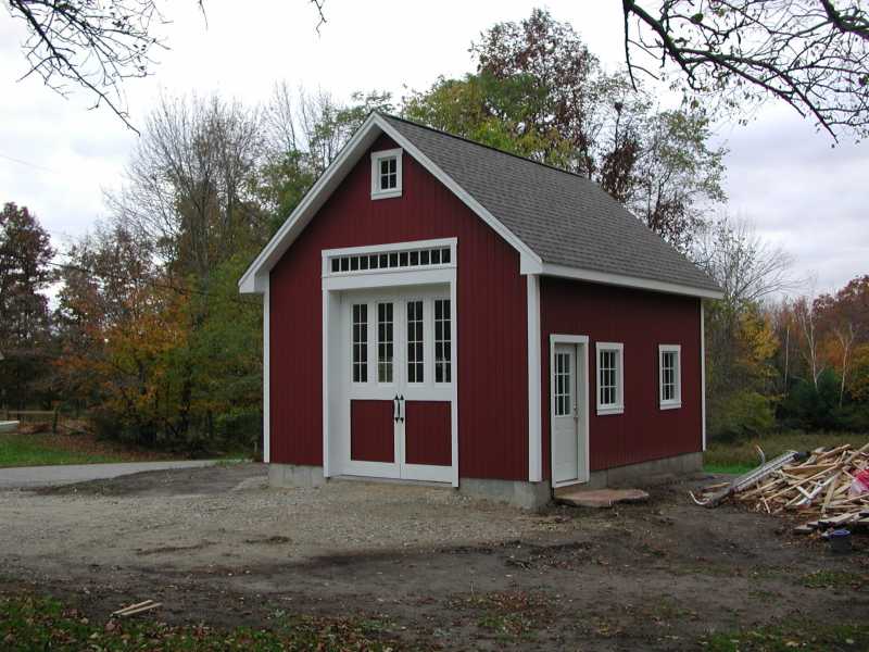

Absolutly beautiful. A few questions if you don't mind: 1) What did you use for the casing/corner trim/trim board between lap & shakes? Painted cedar, some type of vinyl product, or ?? It looks really good. 2) why no exterior lighting? A nice hammered metal coach light on each side of the tractor door might look really nice and help when pulling in after dark, not to mention the saftey factor. Just don't slap up one of those ugly industral looking motion sensor flood lights, but by the look of your building I can see you already knew that.

Care to share your building costs? I'm looking to do a 24X36 tractor palace myself someday. Something tells me the checkwriter will have it down to 24X24 in no time flat. /forums/images/graemlins/crazy.gif

Lighting is a nice finishing touch... I have also decided
to put up the granite hitching posts with the iron rings
out front on mine ... I figure they will protect the doors
from being backed into...

Thanks for all the replies, and yes all of the neighbors are asking about my time availability to help them. This darned day job prevents me from taking orders. All of the trim is wood, varying sizes, it was pre-primed pine. The siding is a wood fiber product, and all of the exposed cedar has a colored stain on it.
The total cost is just over $17,000, but I over built it, so you could easily shave a couple of thousand off it. I used all CDX plywood, no MDF, I used 1.25" tongue and groove plywood on the 2nd floor, boxed all the soffits, had heavy duty floor trusses for the 2nd floor, etc. I did not try and get any estimates of what it would have cost to have someone build it, but the roofer usually does custom type homes, and he said it would have easily been $35,000 - $40,000 to have this built.
I have not put any exterior lights on it yet, because I have no power to the building, I use a generator for power. I will bring power in next year, but I am holding out for a backhoe first. I may go ahead and install the lights, because it would really finish off the front. I also have not installed the weather vane yet, we can't decide between a chicken or a horse, and more importantly, I have not decided who is going to install it. I think it would be worth a fresh salmon and a case of beer to have a professional do that. I will try to get some 1st floor pistures next time I am up there.
