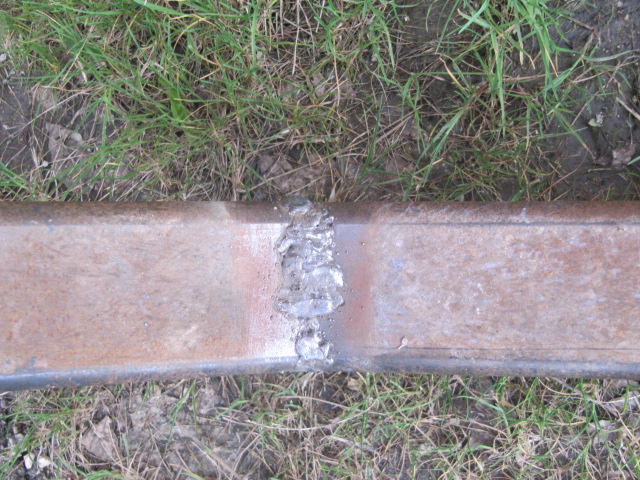

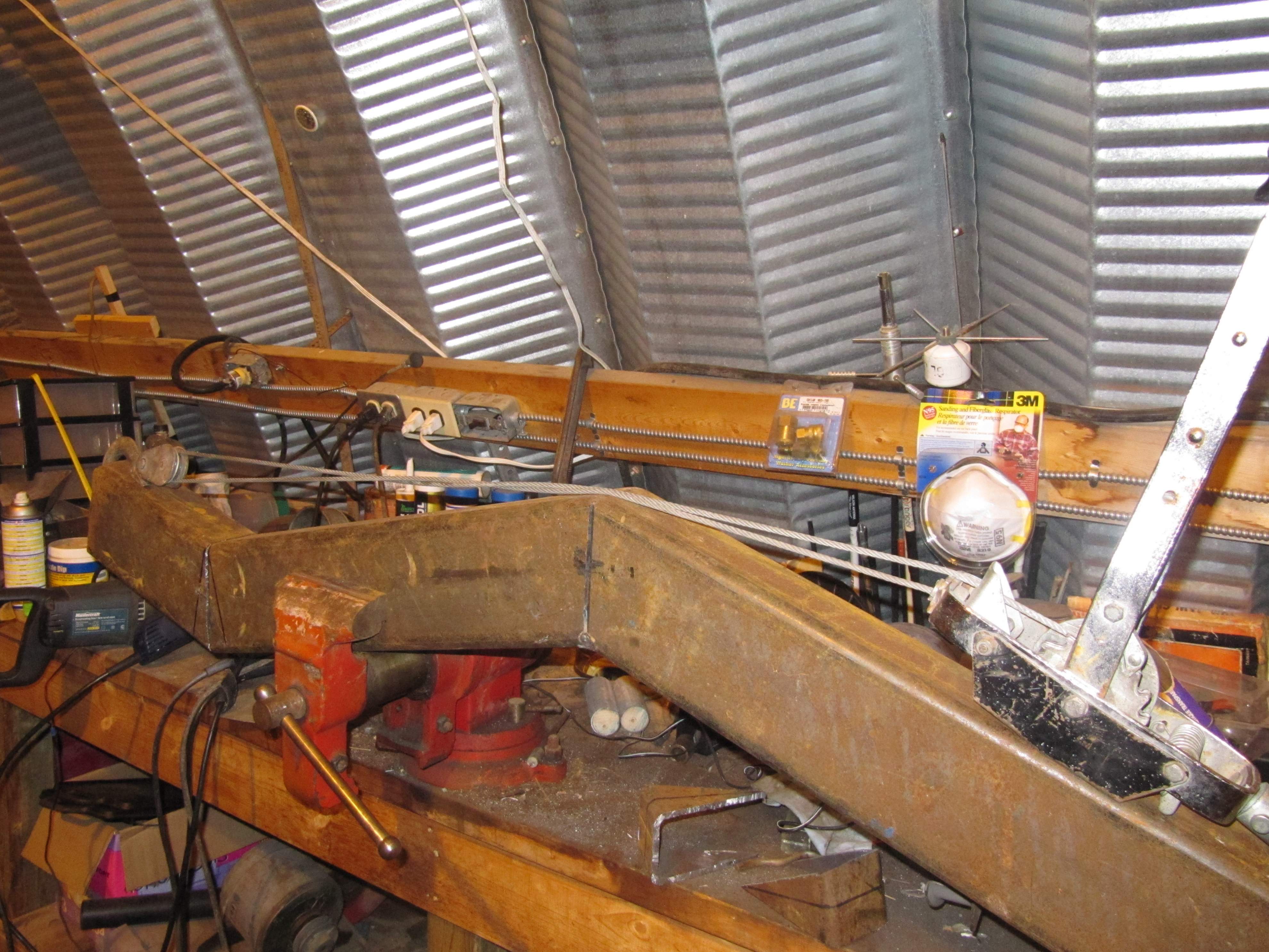

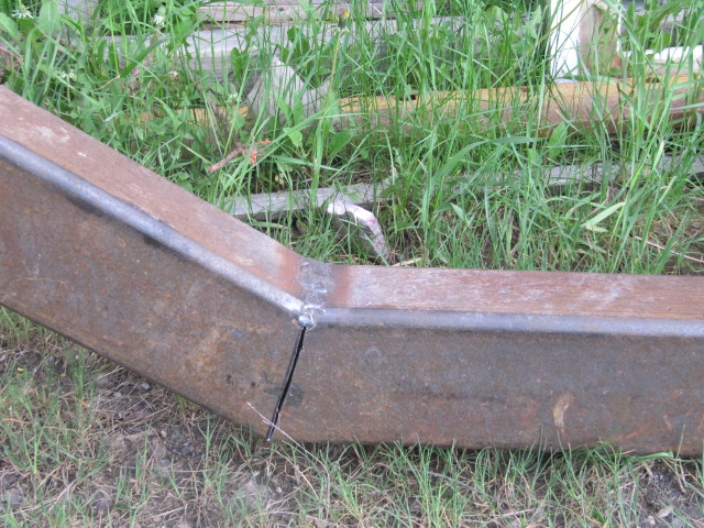

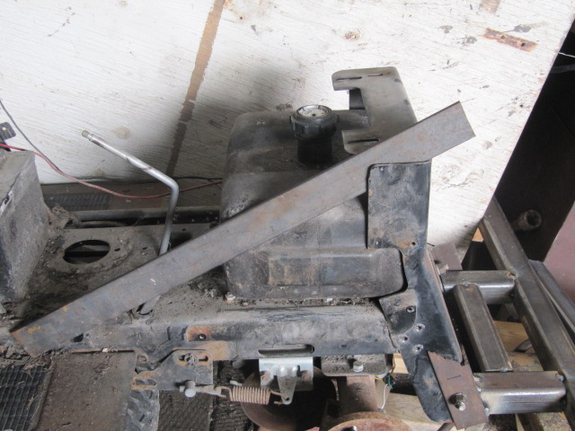

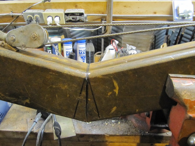

Well, it's a good thing I didn't say which day the sun would not go down before there would be a hangin':laughing:!! Like another poster said recently while commenting on how long it took to get some projects done :"life got in the way". But I did get it done and it's a lot easier to get at the bottom of the tractor.:thumbsup:
Photos: 1): Shows the front end of the tractor"swingin'". 2,3 + 4): the reinforments on the left side of the tractor. Note the yellow link. I had to do it that way to allow for the fuel tank. 5): Right side support. I can add gussets if needed. 6): The platform for the pivot and hydraulic controls tack welded in place to make sure it all lines up. Next step is to fill all the welds after I remove the frame from the tractor. I don't weld overhead if I can avoid it!!:D 7): This is the upper mount using a 3/4" bolt. I'll be tack welding these to minimize movement. I can always grind them off if I need to remove the hoe for some reason.
Yeah, I know the upprights in #6 look off square. I saw it too and went out to check it with the square.:laughing::laughing: It's the way I took the picture that makes it look closer together at the bottom.:eek:

So,with the welder back from the dead, I have been able to get back at it!:thumbsup: Here are some photos: 1): The frame or platform that has to hold everything that hangs off the pivot. 2): Another view of my sorry looking welds.:eek: 3 + 4): Part of the pivot taking shape. That piece may look a little flimsy right now but once all the various bits are welded into place it will be some heavy!:D What I have there is 3x4" angle butted together on the 3" sides to make 6x4" channel. A 3x1" channel will be centered and welded to it back to back. On each side of the 3" channel I want to weld 3/8x3" flat into place to serve as the mounting bracket for the boom and boom cylinder. That, plus the pivot hardware going on each end of it will make it load - ready, I think.
