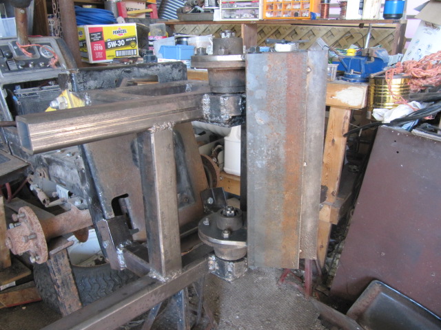

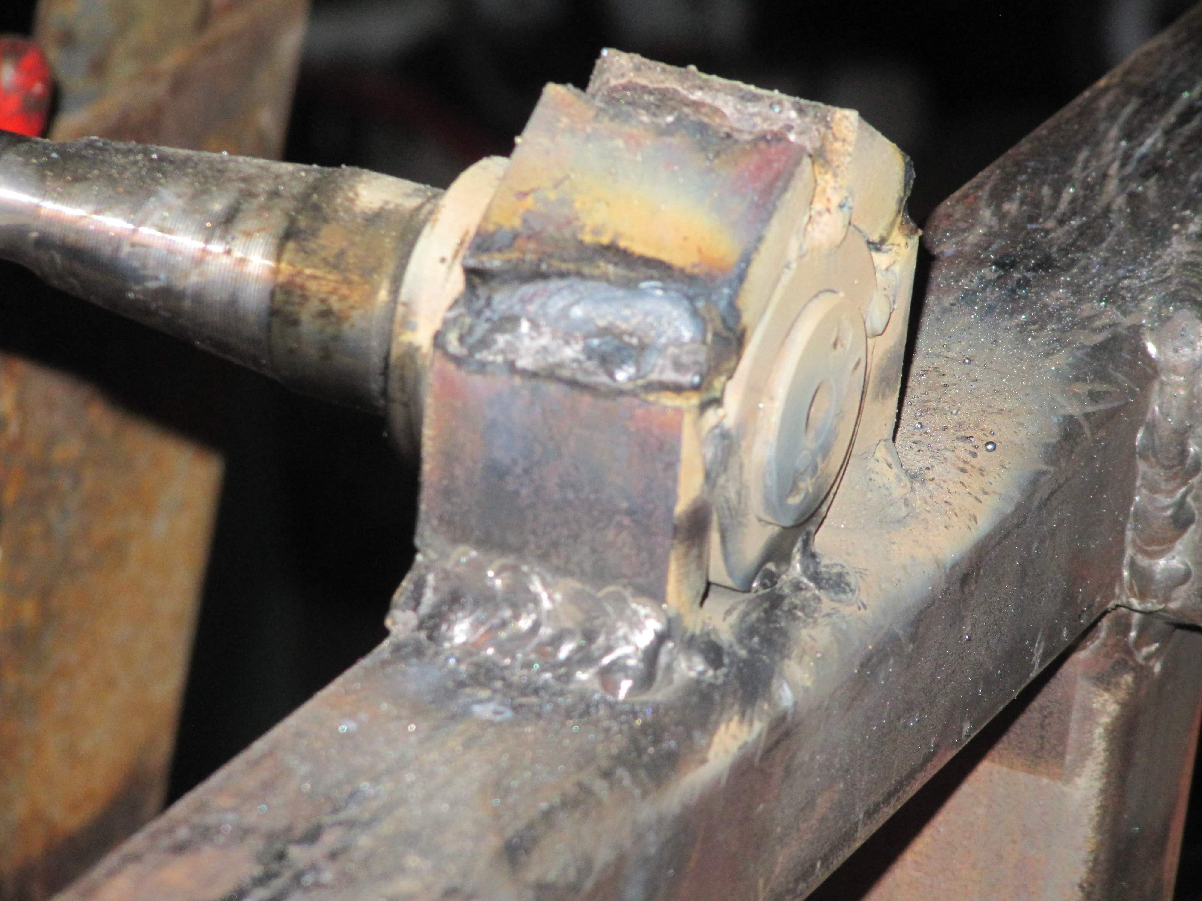

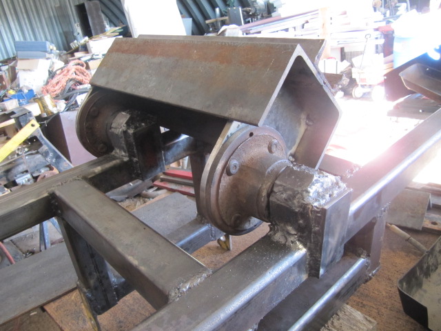

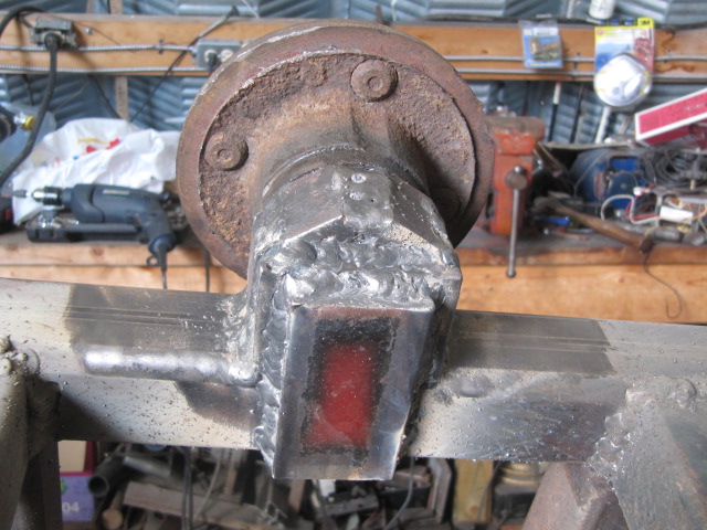

I had a couple of pieces custom cut for my pivot box recently and today I started assembling it. I have not seen any pivots built this way so I don't have any pattern to go by. However I like the concept of a thrust bearing to hold the weight of boom dipper and bucket as it swings. In the attached photos I show the tacked together assembly as far as I have it done. I have it held in place temporarily to show where it will be fastened.
1+2): Shows stub axles (2) for the pivot and the pieces I had custom cut. They are tacked to the 4x6" channel shown in an earlier post. 3+4): That is the extent of the swing of the pivot. On the back of that 4x6" channel I have tacked 3" channel which will act as supports for 1/2"x4" flats. Those will be pre-drilled for cylinder and boom attachments. I have cross tubing to go on the end of the boom and I will cut some up to use for reinforcement for the pin holes through the the 1/2"x4" flats. Maybe with 1/2" thickness there I won't need to reinforce the holes? What do you folks think?
NormL
Never had a chance to say " I dig the use of the wheel hubs" ( if you figure they hold up a car, should be REAL stout.) I have pondered using hubs and spindles for
some of my projects over the years. Makes for easy bearing use.. you could put on bearing buddies
(for boat trailer hubs) or drill the hub between the two bearings and tap it for a zirk fitting, to keep them greased.
If someone did not have any hubs and spindles and needed / wanted them, they could go to a trailer parts supply (AXLE Parts) and get weld-in spindle stub and matching hubs and even get them with same sized inner/ outer bearings, to minimize spare parts.

NormL
That was my rationale for wanting to use axle hubs. The ones I have were given to me. All I did was mention I was looking for some one morning at the local coffee shop and the next day one of the guys told me he had them in his truck and I could have them! Gotta love them prices!:cool2:
I don't anticipate needing to grease the pivot too often. I will pack the bearings before I put it to work and check under the covers from time to time but when you consider the mileage you typically put on an automobile between packings, I doubt I'll need to grease them oftener than once per season.
